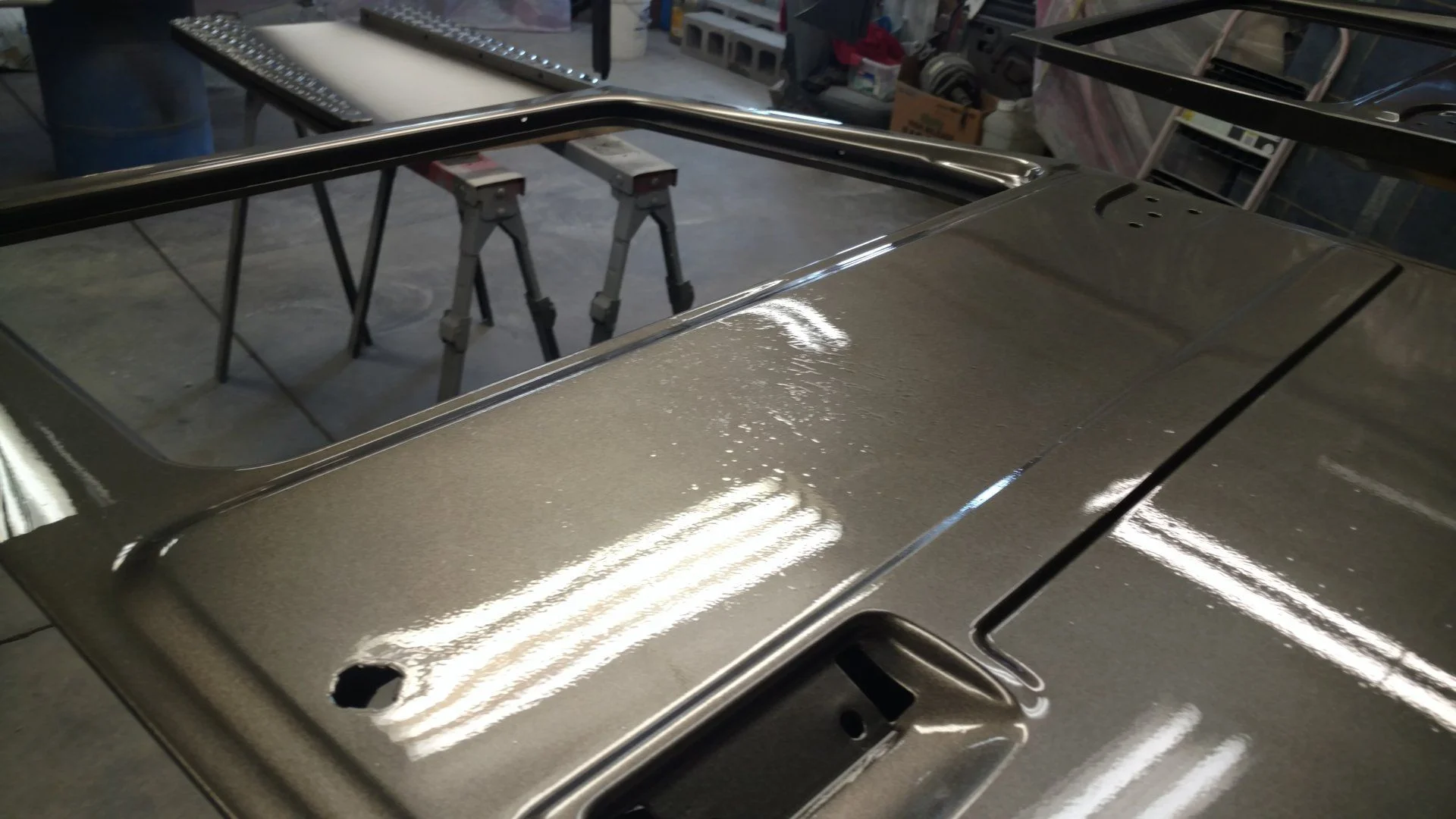

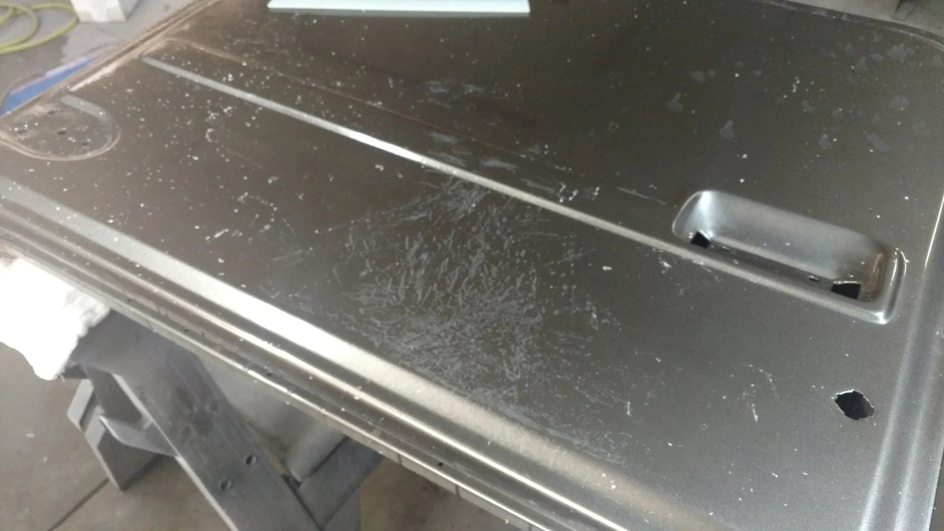

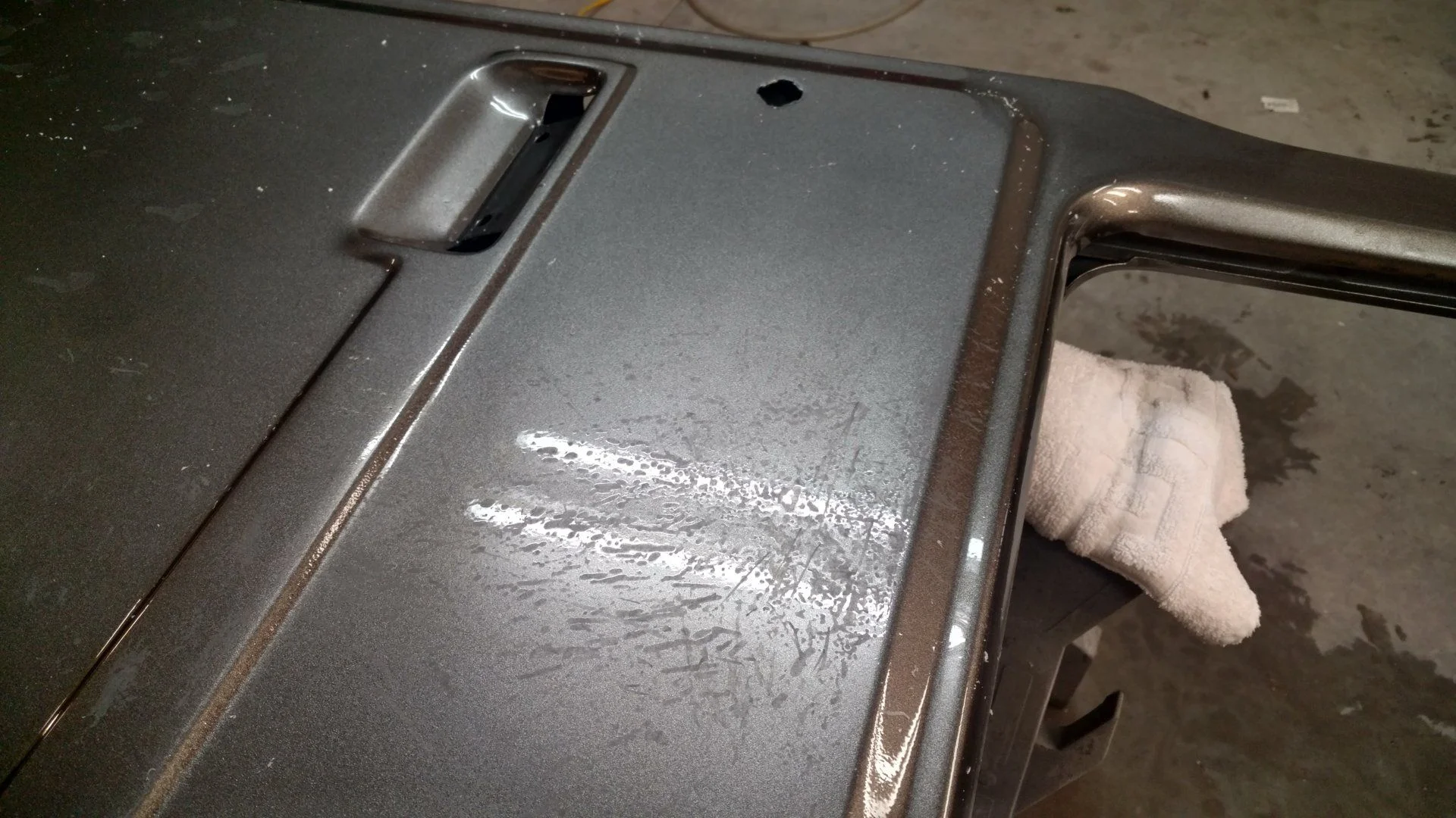

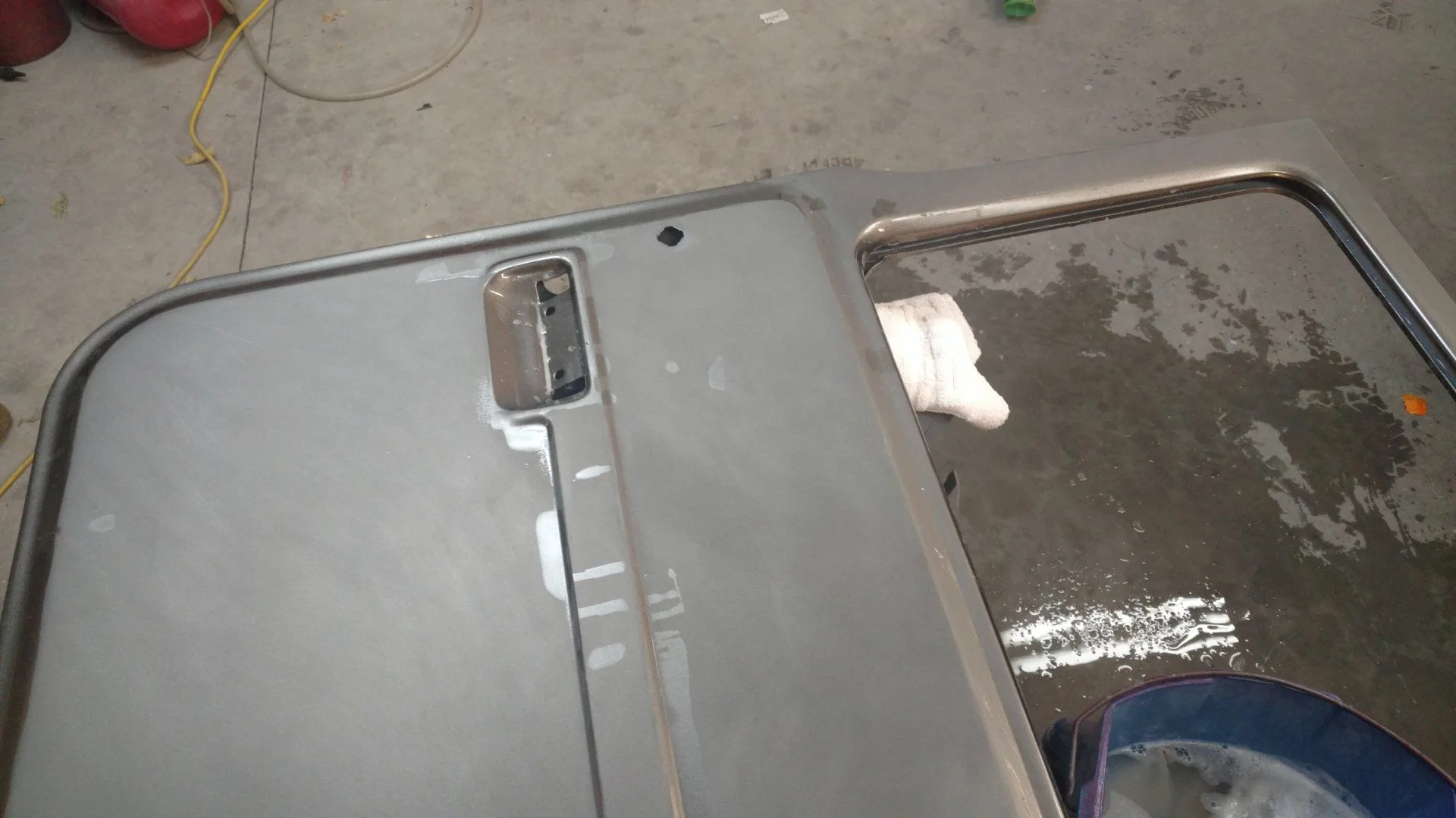

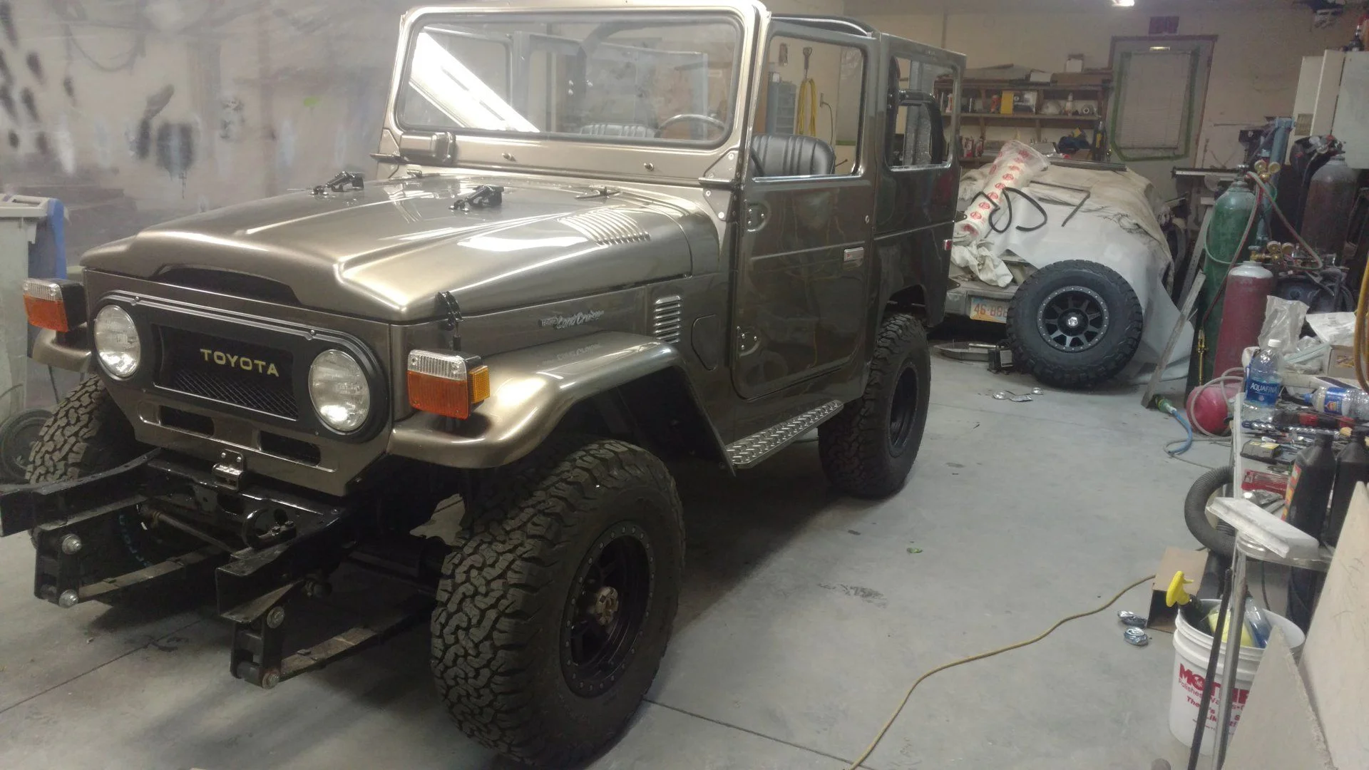

I bought myself a little tool that's similar to a nib file. I figured it was worth a try. My door looked terrible with the splash of clear on it. After a short bit of work with the tool I dug into it with 800 on an aluminum block and then proceeded as normal. I haven't buffed it out yet so I will have to get back with the finished product later.
Ok, what does that tool do? More pics please. I’m always up for a new cool gadget.
It's like a nib file. You use very light pressure and push it over dirt nibs and the like. The leading edge has a very slight curve which gets the high spots. Just lay it flat with the string just holding the back up and it slices away the high. The sides are flat and you can back drag sags to knock them down. It's slick. The piece is just a small block of tungsten carbide.

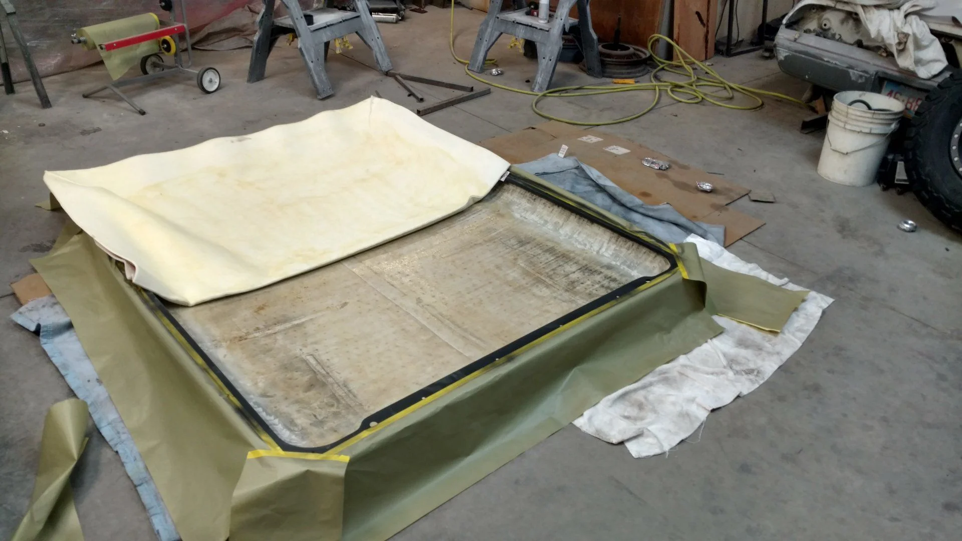

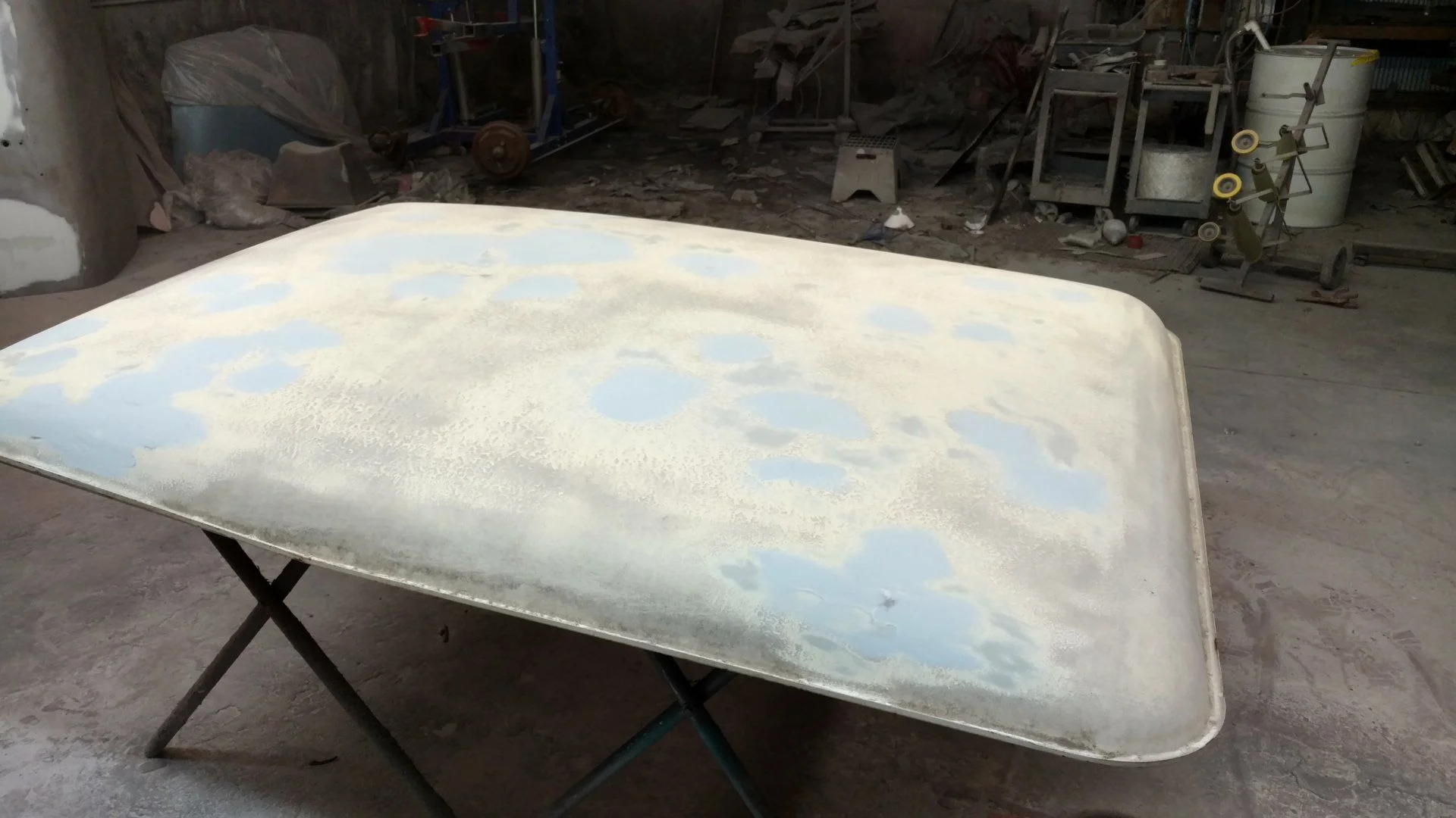

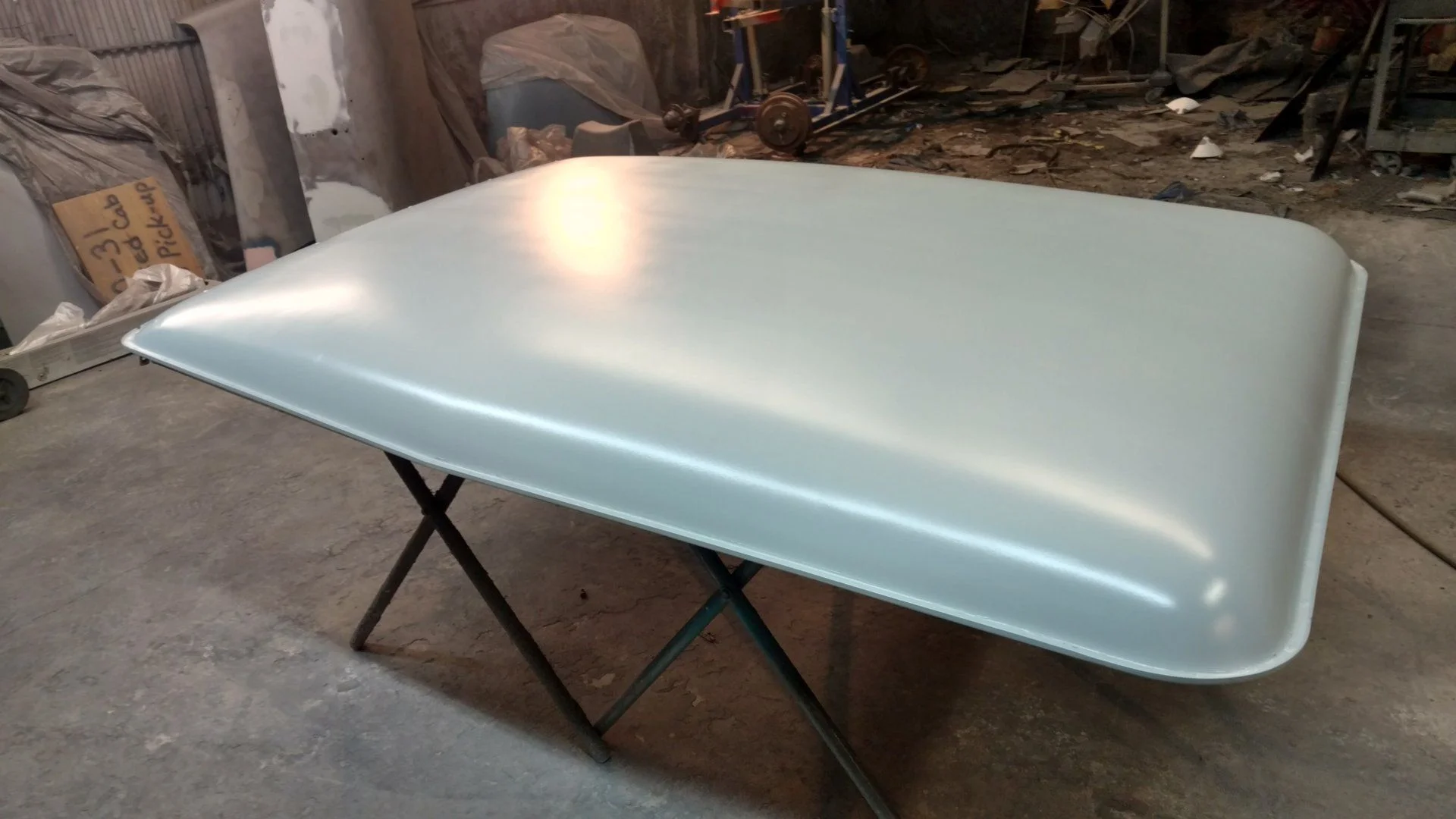

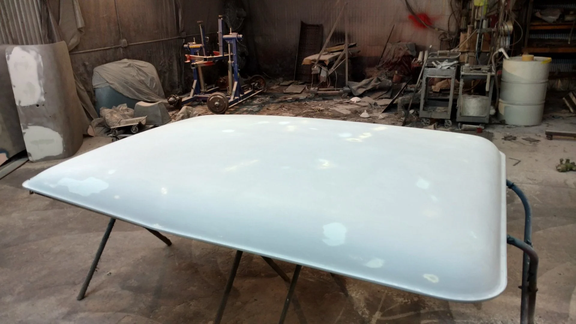

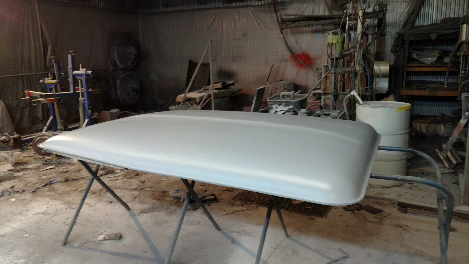

I spent a few hours on the cap again last evening. The ultra high build does do a good job of helping get things flat. My only problem is it gets really hard when allowed to cure for too long, similar to regular filler. Ultra high build is essentially sprayable filler. I toughed it out and shot some good ol' 2k primer. I'm hoping I can knock down the 80 grit scratches with 180 and finish with 320 without having to prime again.

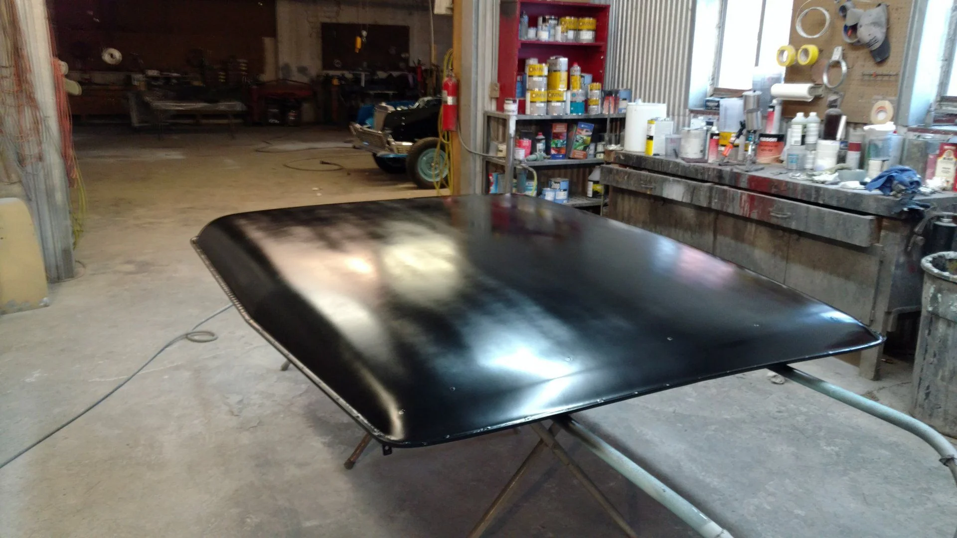

Got my bezel and cap shot yesterday. I'll post pictures when I get back over to it and it has thoroughly cured. The flat paint I used was drying in stripes. I will be really sweet-talking it if it looks like that when it's done drying.
