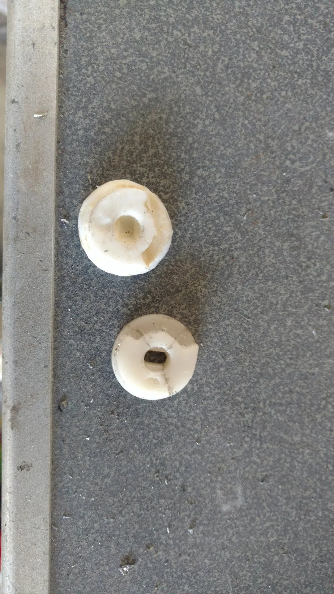

Here is my seatbelt retractor repair I did. I couldn't get the seatbelt catch to work so I pulled off the cover. As I did the pieces of the cam fell out. I decided to glue the pieces back together and cast a new one in resin.
I tried to use a silicone mold kit but that was a disastrous mess. I then just used modeling clay and it worked like a charm. The resin amount was so small that I had to use an external heat source to get it to kick because the clay was so cold. The piece just needed a little finish filing and sanding to fit and work as it's supposed to. I also sewed on some new webbing.
The photo shows the glued piece and the piece I cast.

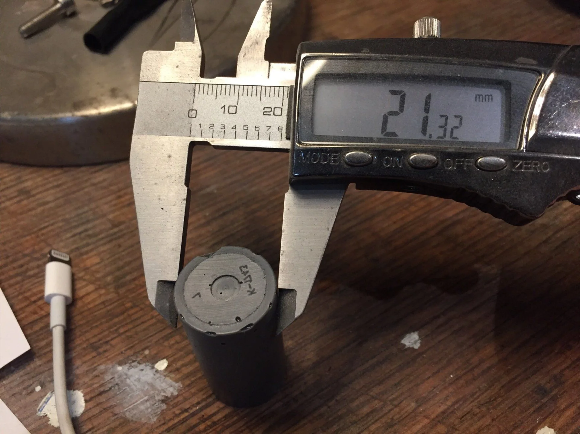

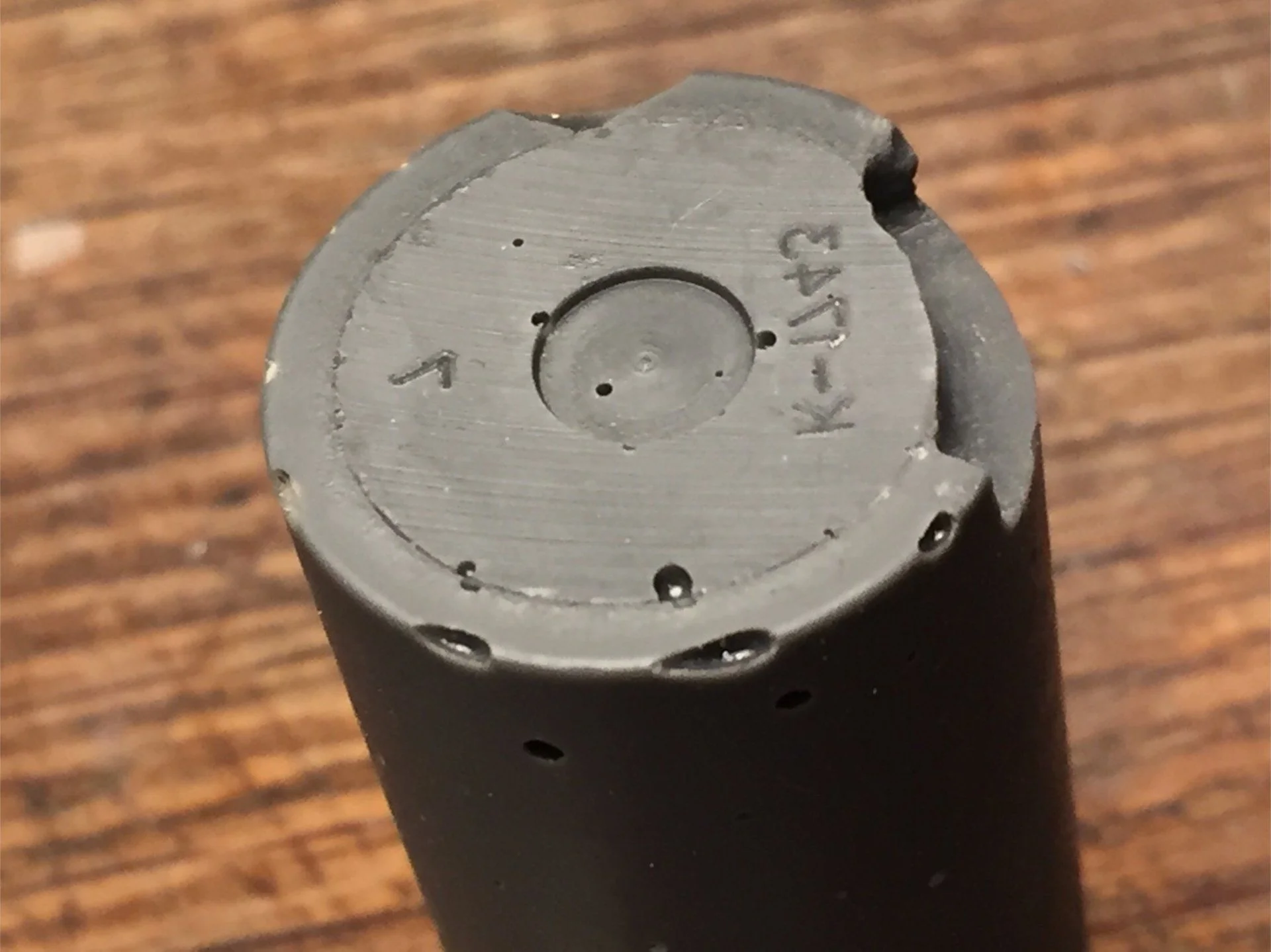

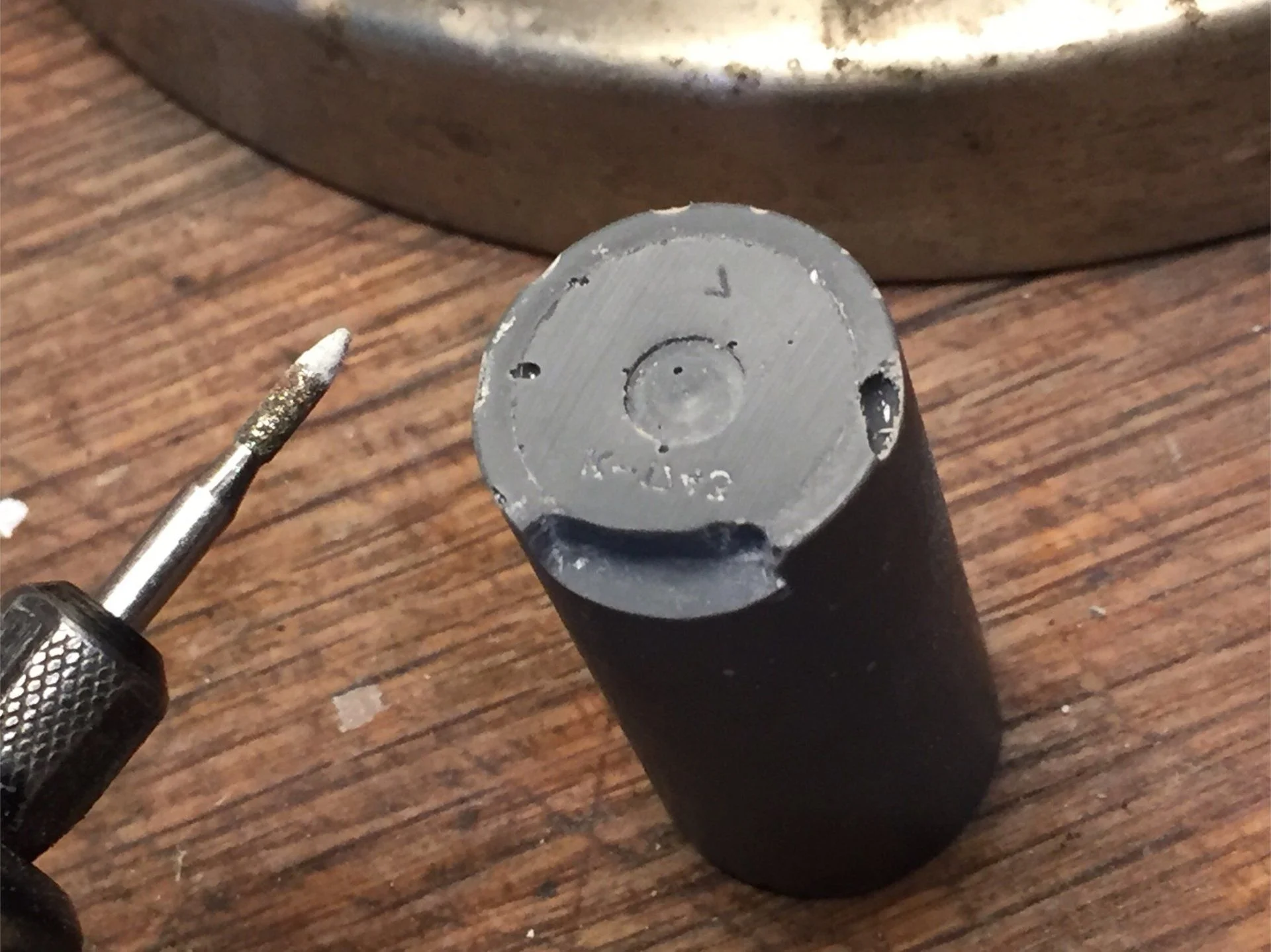

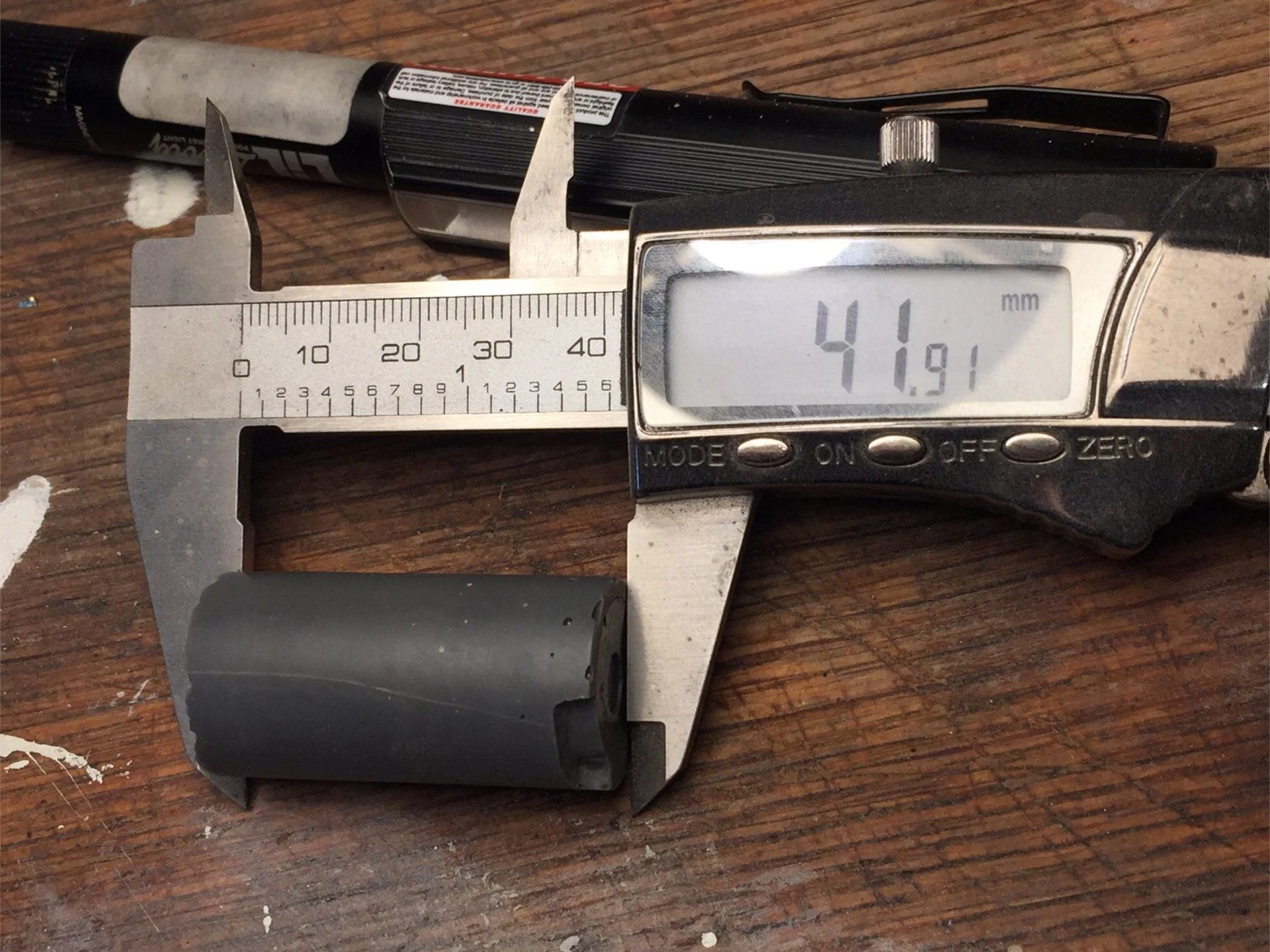

During my lid project I had some leftover SEM 2 part epoxy, so I squirted into the plastic cartridge cap rather than into the garbage. The cap was about the size of a 12 gauge shotgun shell. Interestingly the SEM cures pretty damn hard and takes to grinding well. I did a quick test with my dremel just now. No idea if this would be better or worse for the small part @hooter needs. If either of you wants this chunk of material I can drop it in the mail.
5 minutes of grinding. You can see it’s possible to get a sharp edge with this stuff. The small holes are just air pockets.
This self leveling stuff even picked up the code of the lid.

The modeling clay is just for my cast. You just press the piece into the clay, pull the piece straight out then pour in the resin and let it cure, then just pop it out. Trim excess and file it to shape. The hole in the center you drill undersized and use a small file to make it fit the center shaft. It's pretty easy

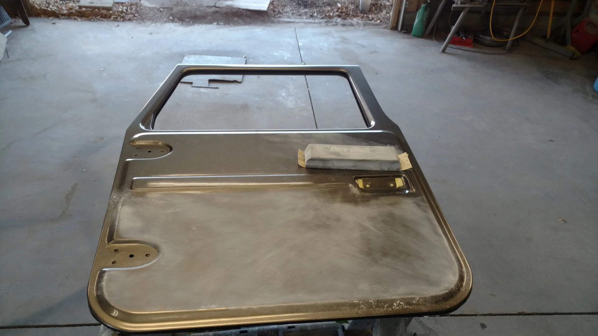

This flat finish is a bear and the paint guy and all the guys I know who paint for a living have said flat finishes are tough. I wound up over reducing so each pass blends more easily but it gives just a bit of gloss. My biggest mistakes are letting the gun get too close when the panel is horizontal.
As for practice, I figured if I was buying the materials I was going to go for it. Repainting sucks but it's part of the learning curve. I discovered metallics are very picky about gun control, too close=tiger stripes. Also, don't forget to tack before each stage. I had to reshoot a door because of a Halo from the sealer having texture. It drove me crazy and I couldn't leave it. The books are a good start, that's what I did. I also asked my body buddies alot of questions.
