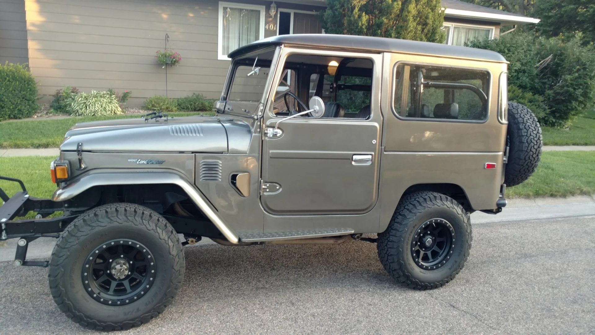

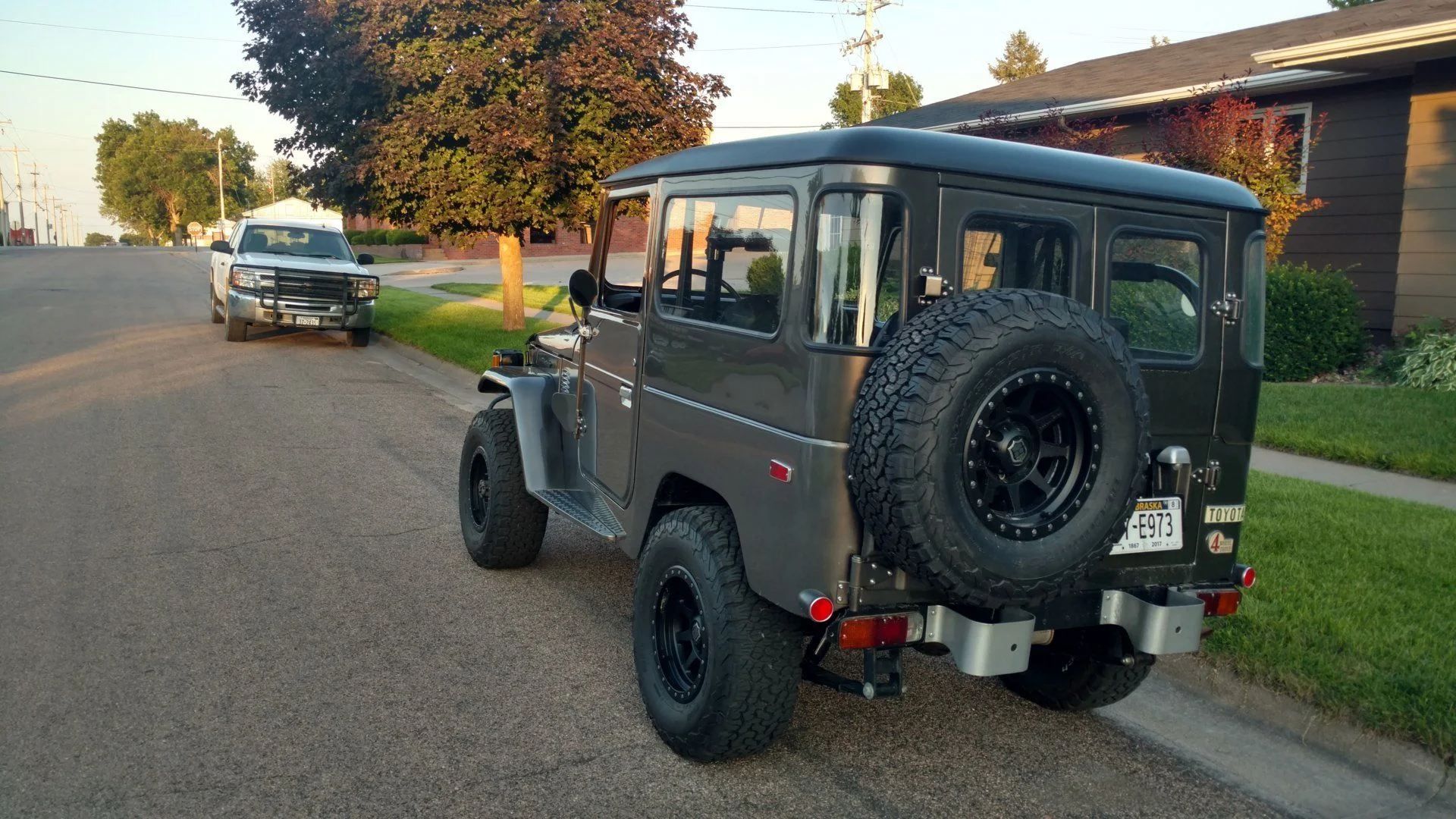

It's been awhile. I've gotten the fuel problem resolved and I have just been driving and working out the minor bugs. The worst problem has been the windshield.

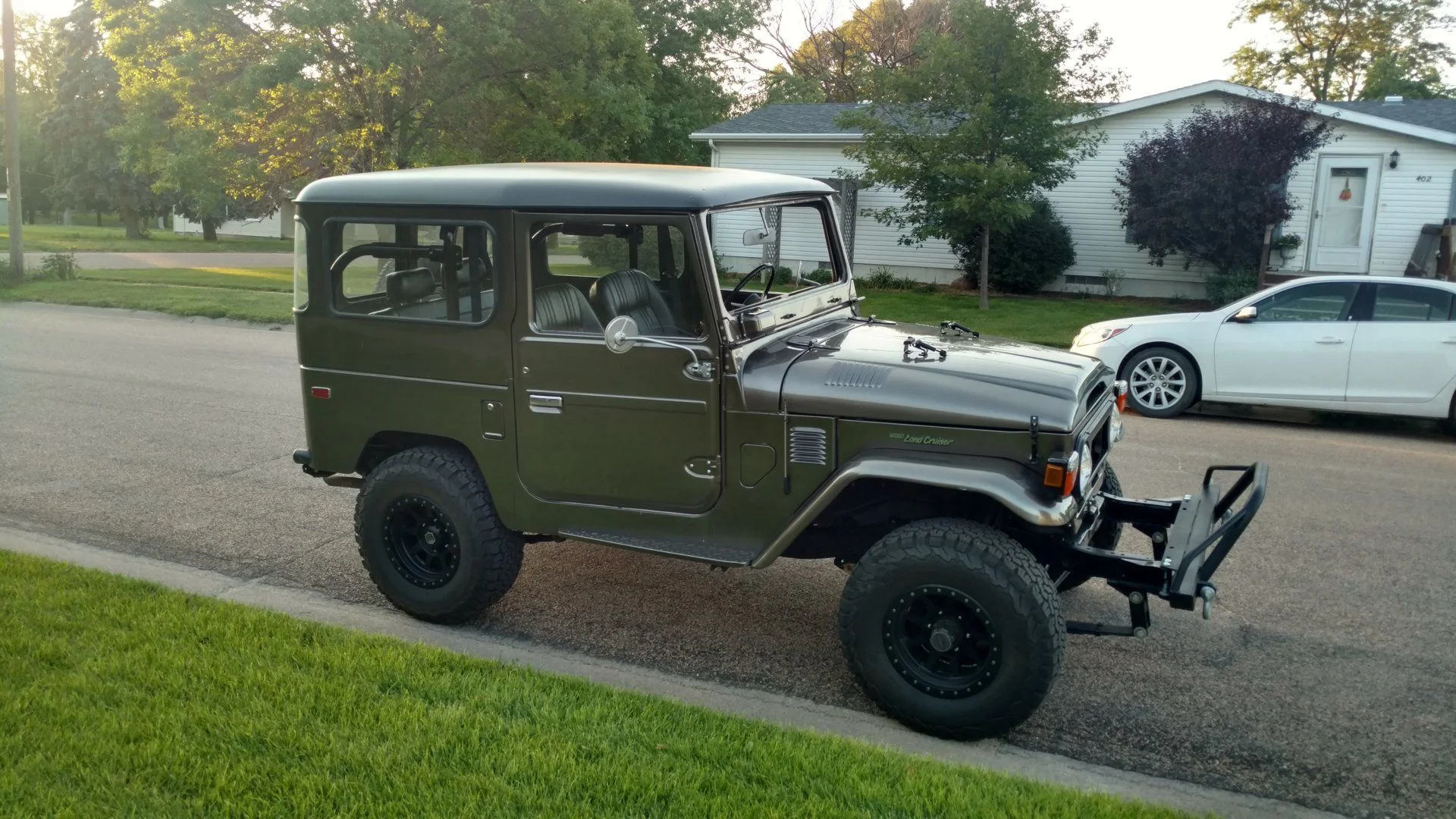

I had the glass shop cut a windshield for me. What I hadn't intended was for them too install it. They used a tractor cab seal. It was fine until I drove in the rain, it leaked like crazy. Only a can of flex seal could stop it, which I didn't do. I'm currently waiting for a template to arrive so I can install the proper glass and seal.
I am really enjoying this machine. Drives great and looks good doing it. I regret the thought of selling it to build a garage but my other toys, including another fj, demand it. My wife also demands it. I am enjoying it while I have it though.

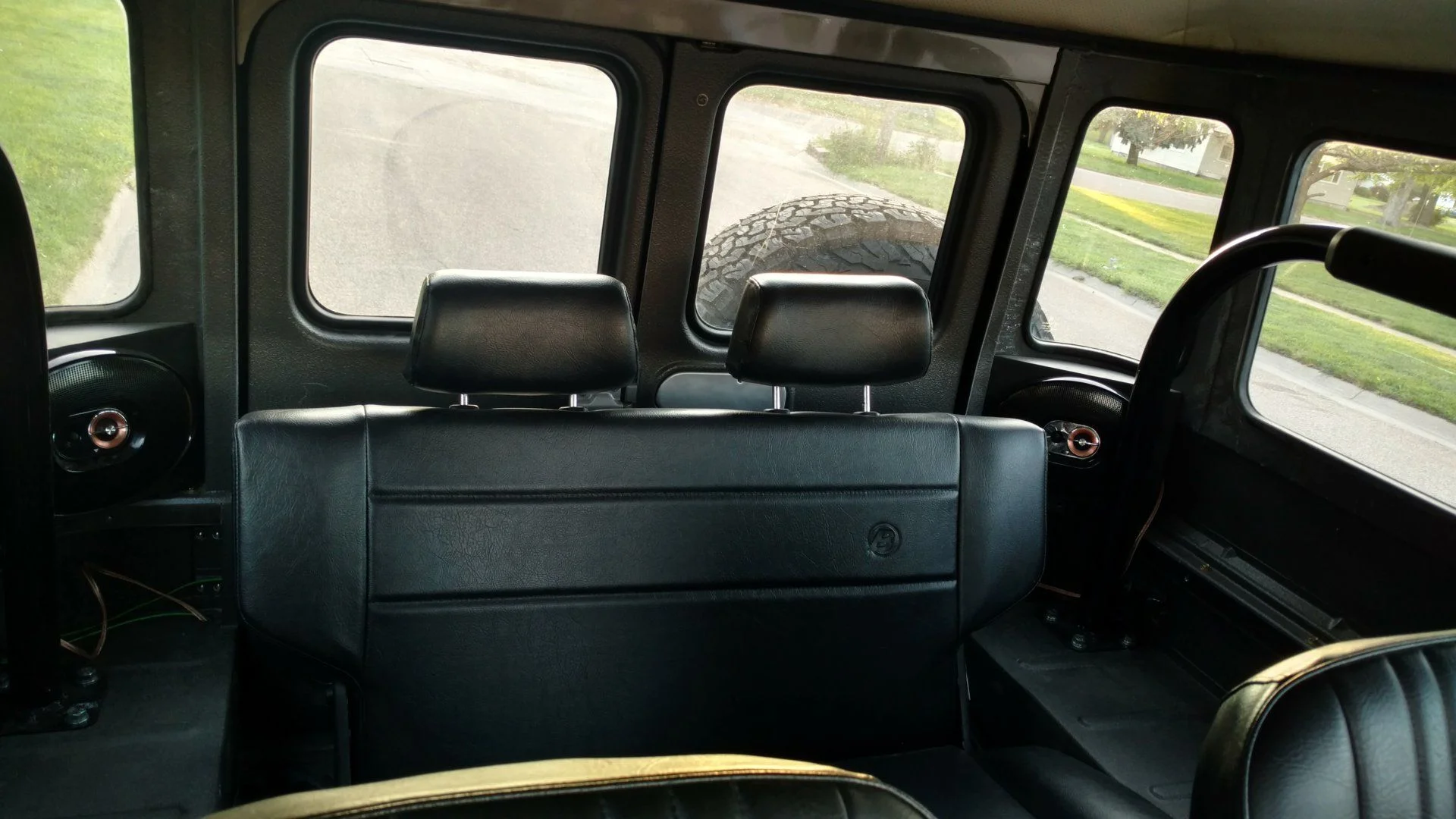

Even without the windshield it looks pretty sweet. It sure is a noisy drive though. The bestop rear seat is a nice upgrade for the kids. My kids complain there is no DVD player but I don't care because I can't hear them when driving 60 with the windows down.

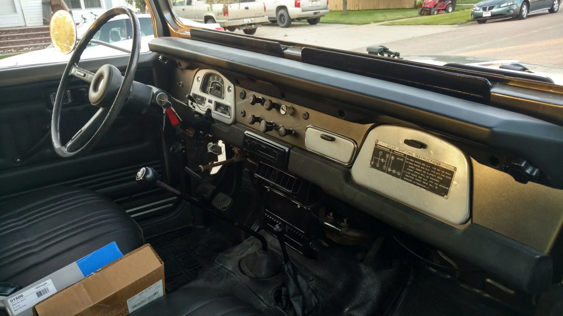

My fuel gauge and temp gauge quit on me with all the leaks and what not. While cruising the forum I read about the resistor contact in the fuel gauge which in turn runs the coolant temp gauge.
The test meter confirmed that I had no continuity through the fuel gauge at all so I pulled it out filed the contact and presto!!! Both gauges back to operational.
This forum and the knowledge within are priceless. Thanks everyone
