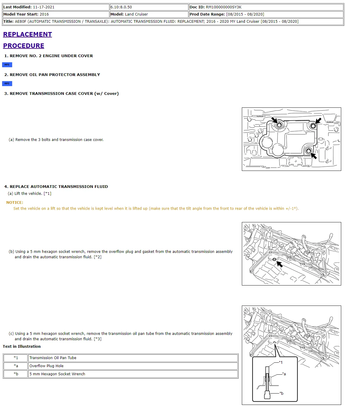

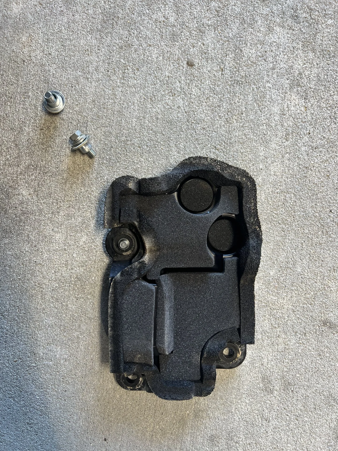

Help Please - on 2019 w/ 8-speed 70k miles, I have a different oem pan - no drain plug, just overflow plug and cannot locate 24mm refill up higher on side. There is a cover with insulation on side but I didnt want to guess and start undoing things in side to see if they are drain and or refills. Anyone tackled this yet on a 8-speed and can share pics? Here are pics of what I am seeing. I have done this on gx460 and very similar to LC200 instructions without 8-speeds. Appreciate the help.
Help Please - on 2019 w/ 8-speed 70k miles, I have a different oem pan - no drain plug, just overflow plug and cannot locate 24mm refill up higher on side. There is a cover with insulation on side but I didnt want to guess and start undoing things in side to see if they are drain and or refills. Anyone tackled this yet on a 8-speed and can share pics? Here are pics of what I am seeing. I have done this on gx460 and very similar to LC200 instructions without 8-speeds. Appreciate the help. View attachment 3404975View attachment 3404976
I dont know about the pan but the fill plug is under that plastic cover. Not having the right inventory of flex wrenches and extensions to get that cover off is why I've been delaying doing this job myself. Mines 2018 8speed. Following to see what you find out about the pan as I still need to order parts to do this in the next 15k or so.
The drain plug is in the top left of your photo. It's got a tiny allen head. It's NOT in the lowest point in the pan... NFC why. Ultimately this is why doing the full fluid flush is better IMO as that pumps the old fluid out of the pan, whereas the drain-and-fill procedure only really tops off the pan
Thank you! If I am reading this correctly - the one visible plug on my pan is the “overflow plug” but this whole set up is different and there is a second stage draining accomplished by removing the internal “transmission pan tube” after removing the overflow plug (within this same hole)…..Looks like a different design seen in other toyota transmission pans vs prior 5-speed LC200s?
Yes, remove the tube to drain it, but ...

Thanks. I always drop the pan on my gx460 - already have replacement filter and gasket for this job - just wasn’t expecting only one plug on this pan and a cover over entire area of refill bolt.
Good you have the filter, but I stopped doing that. It doesn't make a difference as the filter is always clean and that's the case even with my 26 years old Camry. That's also the general opinion.
The cover over the plug is a strange thing. Unless there is something else there to protect, that is a bad design to make maintenance harder.

Got it off using combo of 12mm strait ratchet wrench with a 7/8 wrench as extension. I think it can be done with a non-ratcheting wrench & same extension too. Was going to try an aray of socket extensions with swivels/elbows next but this got it. Appears cover is for sound dampening - says “silencer” on it. Confirmed 24mm refill plug is under this cover.
