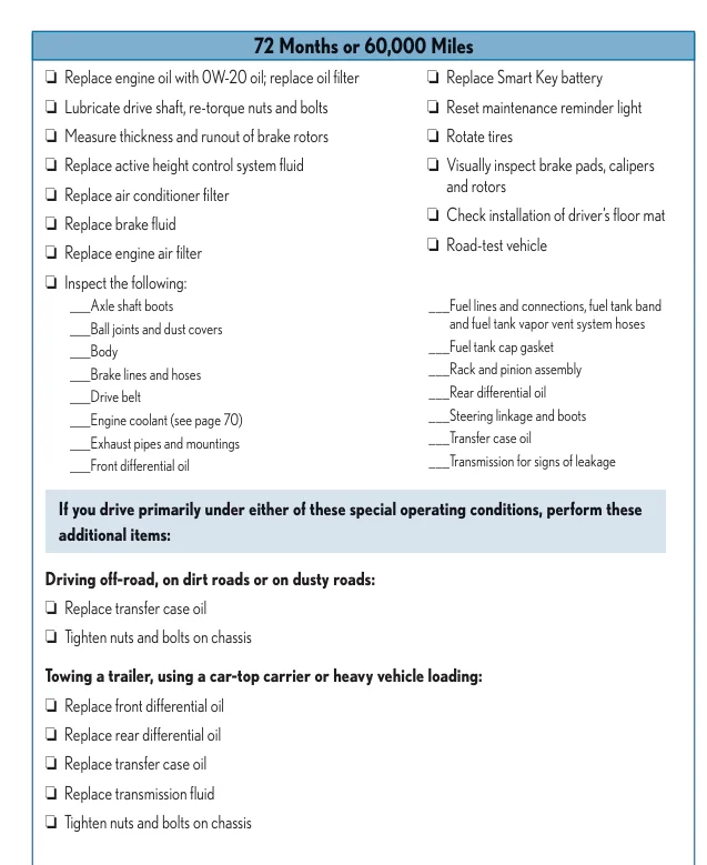

I tore my owners manual apart and couldn’t find any information on transmission service except 1 section that says you should check, and potentially service, the transmission fluid at 120,000 miles, only if you are towing frequently/ loading down the vehicle.
