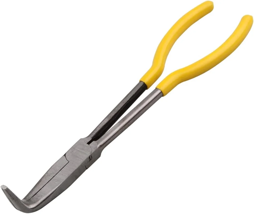

Only thing that I struggled with both times is the paper clip…. Anyone find a good trick for that?

A long-ish flat-head screwdriver to depress the button, and a long-reach 90 degree needle-nose pliers to drop a correctly sized drill-bit in from the top. Fiddly but that I've found, the best way.

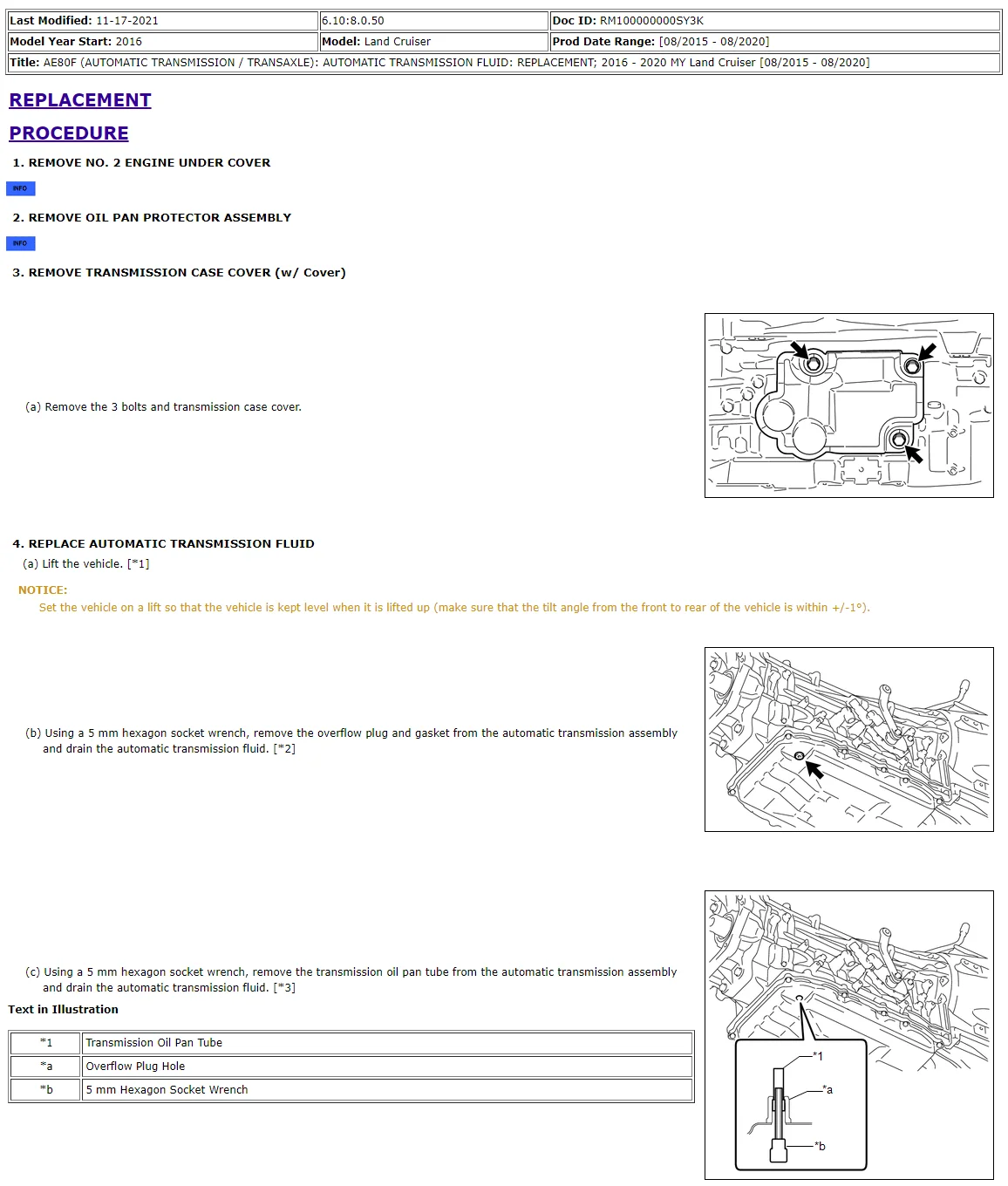

The drain plug is in the top left of your photo. It's got a tiny allen head. It's NOT in the lowest point in the pan... NFC why. Ultimately this is why doing the full fluid flush is better IMO as that pumps the old fluid out of the pan, whereas the drain-and-fill procedure only really tops off the pan

Can you confirm that for 2018 (or 2016+) where overflow and drain are through the same hole, after the transmission is at the right temperature at the end, I remove the drain, and wait till it to trickle and then put back the drain plug (the 5mm hex) to finish off?
The reason I ask is somehow I drained about ~1.5qt at the end; If I go by total volume in / out, I bought 15 qt and I have about 14.5+ qt (including the last 1.5qt drained), that's about right. It's totally possible I have somehow filled way more than I drained during the process. But just want to confirm the last step is correct. Thanks
Correct. While at temp there will be a steady stream coming out, as soon as it starts to drip, ie the stream breaks and it kind flows to the side a bit, reinstall the drain plug.
