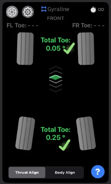

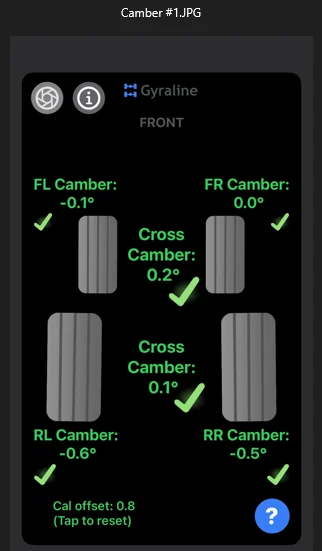

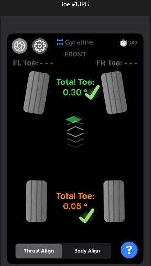

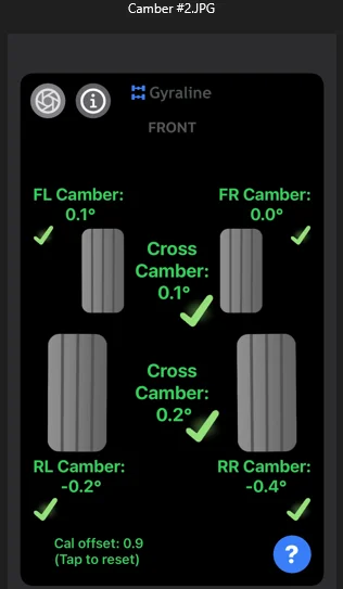

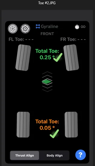

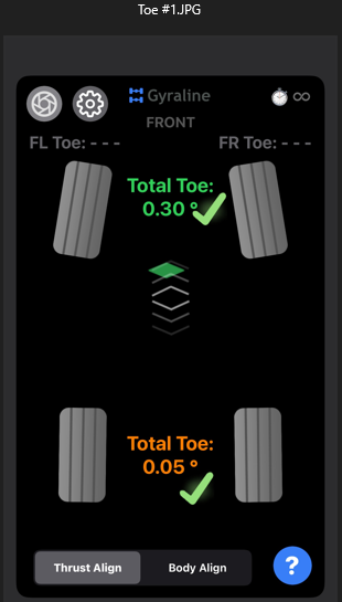

Initial measurements of toe and camber. Vehicle at 39k miles with factory suspension and factory Dunlop's. I am now less worried about passenger wheel outer wear on the last inch, which is not showing driver side. Attribute that to few rotations and probably faster left hand corners than right hand ones.

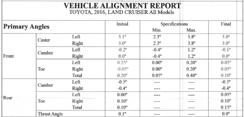

200 series spec
Spec vs Measurements
Front Camber spec -0.4 to 1.2 spec and Gyraline measured -0.1/+0.1 and 0.0/0.0 (Looks good values, no immediate worry)
Front Toe spec 0.00 to 0.20 and total 0.05 to 0.40 and Gyraline measured Total Toe 0.25/0.30 and Rear 0.05/0.05 (Looks good value. Axle no doubt straight and rims appear to be straight as tool with good phone gyros is down to 0.05 accurate)

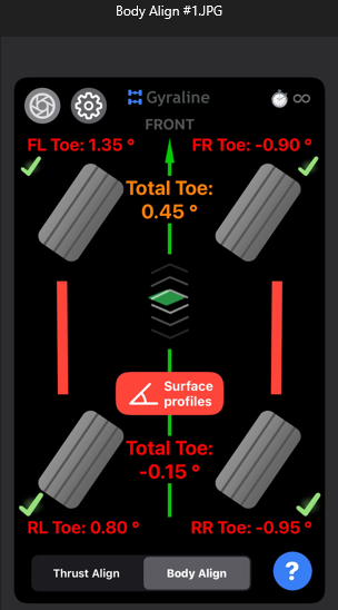

Did also try the toe in body alignment mode. Never got all six measurements to green in the tool. I think I messed up the body measurements or the body on frame is confusing the matter as it pointed all wheels min 0.8 to max 1.35 (left front) to the right relative to the body. Vehicle was bought new with only 39k and no accidents or high impact events nor major putholes. Let me tomorrow try again and also measure against the frame itself. Hopefully something more useful comes out of that.
Toe in Body Align mode result, measuring at the wheels and on two identical body locations (used front side windows rear bottom corner). Never got to show all green (meaning the red vertical lines measuring the body would turn green but red after I finished measuring at the wheels). Kept asking me to repeat those body measurements and the back to the tires. Something not right yet as vehicle is near new and no incidents or major put hole events.
Trying to think why? I am considering operator error using the tool (most likely) to body on frame inherent imperfect alignment to perhaps Panhard length after installing airbag man airbags sitting slightly different (although rear deflated at this point so should sit at factory height).
200 series spec

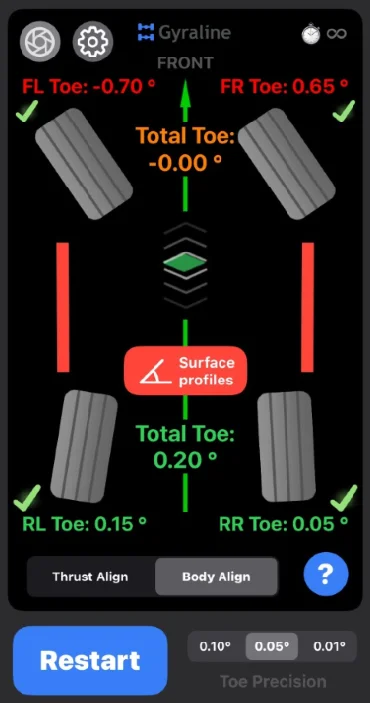

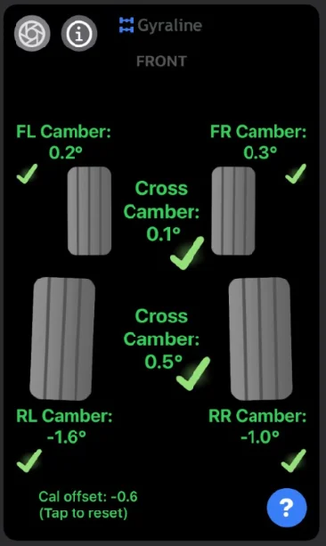

So I took some measurements on the 535d also to see how the toe relative to body looks like...
Toe front within spec. Toe rear within spec. Again not able to achieve toe relative to body alignment with all 6 measurement points green. Used the front windows rear bottom corner. Vehicle never in an accident. Door panels look perfect aligned, at least visual... Rear wheels relative to body does look good. Kept asking me to go in circles between body and wheels so I stopped.
Camber front slightly more positive than within spec. Will have to repeat measurements. Wear is even on all tires and car tracking perfect straight, not worried about it and symmetric on each side. Camber rear within spec. Again need to take more measurements to see how the spread works out.
