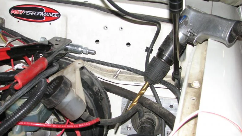

Also I am going to be rewiring the mess in the engine compartment somewhat, and will be running a disconnect switch on the dash, for a few reasons, to avoid draining the batteries, anti-theft device, and another kill switch. So I will be buying a bit of cable, although it wont disconnect the starter or winch, though I may run a separate one for the winch at a later date.

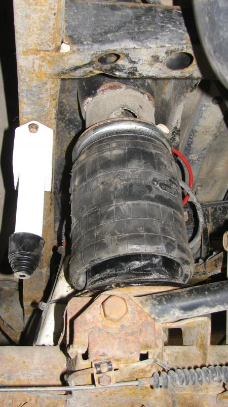

Edit: got the new air bags and lowered bumpstops in, and got the disconnect switch lined up.
Cody.

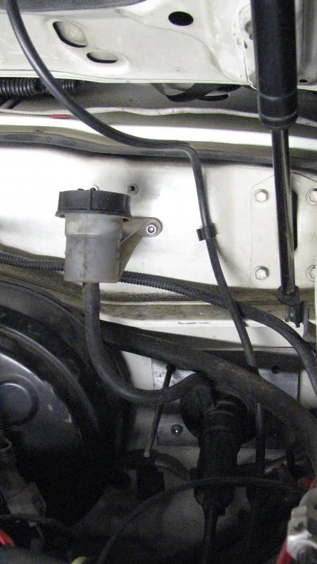

Also got the clutch master cylinder mounted, used some nutserts and stainless 1/4" hardware.
I deleted the valves the PO had to connect right and left air bags together, as i have installed separate switches to control them individually.

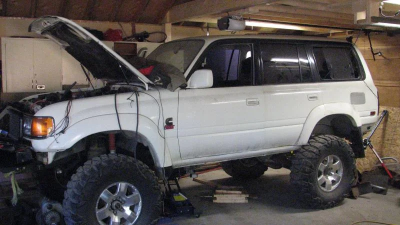

I re-attached the airlines to get the truck up, The Tie rod between the knuckles was almost on the oil pan, I needed to jack the front of the motor to get the rear of the motor to drop a bit to get the trans in easier, so I had to lift it up a bit, pic is with 37's, 11" clearance to top of wheel well in the back, with more lift possible in the front. The light reflection on the window is right at 6 feet.

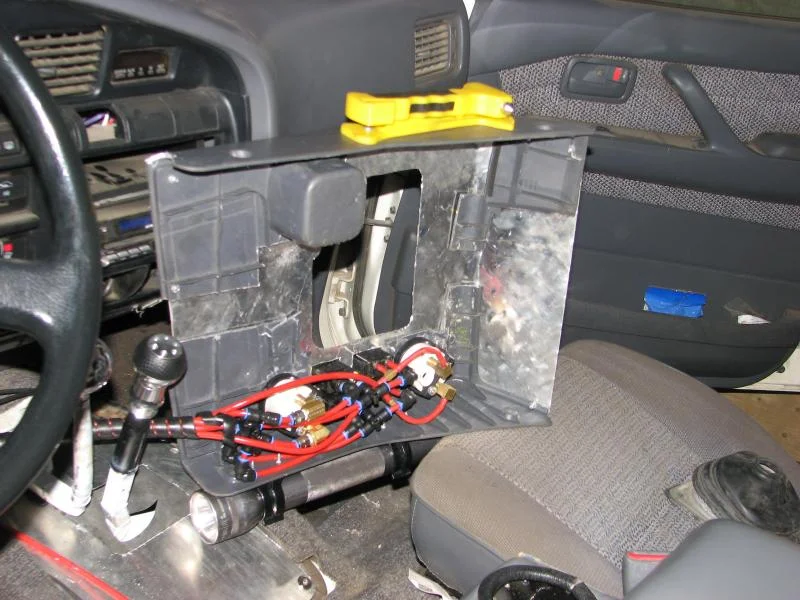

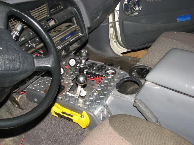

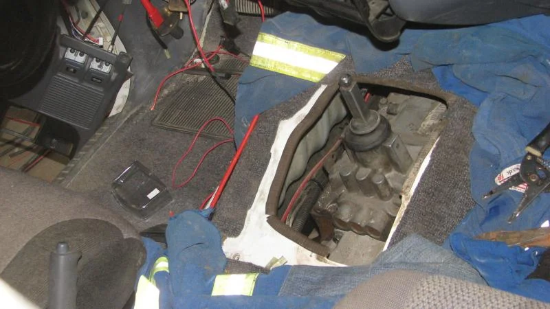

The console will have some alloy checker plate rivot'ed on to hide the holes and make provisions for new shifter boots. I got the new shifters built and installed, ill post some pics tomorrow.
I will be cutting the shifter console in half and widening it, I like my air bag controls where they are but didnt have enough room for shifters and the controls, so ill widen the whole thing 1.5" to get the best of both.

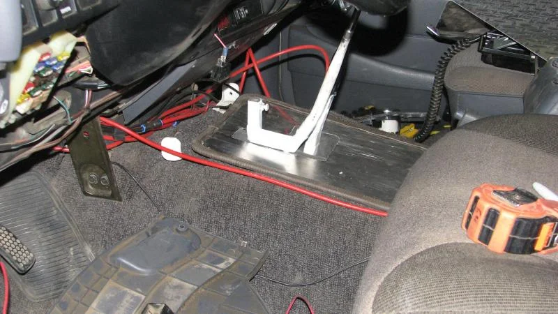

Heres some pics of the trans hump cover I started building using 1/16" alloy plate.
Cut some holes in it, used some grommet from Ian's parted out 60, and some tire tube to help keep the noise and goop out.

Well a little bit of progress, I got the interior almost buttoned up, Ive attached some pics of what I did to the center console to get it house the shifters and of the airlines for the airbags. Also a picture of the crossmember bolted up.

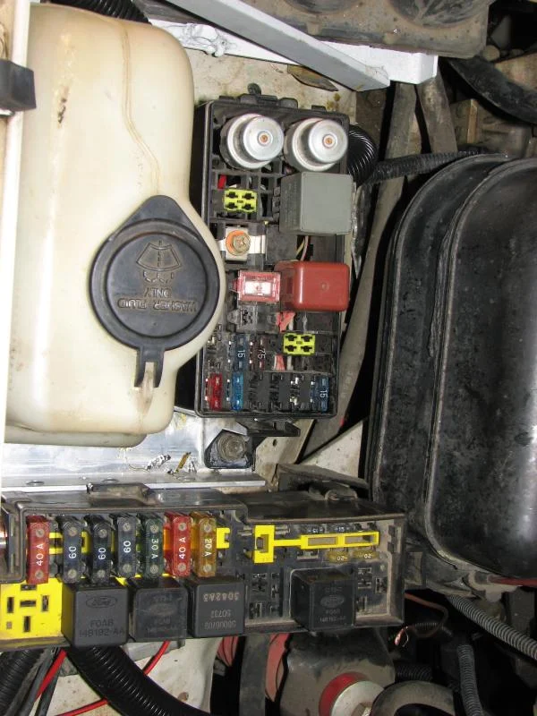

The cherokee fuse panel I added, it supports the electric vacume pump, glow plugs w/relay, alternator relay, starter relay. with a littlerroom to spare, maybe for those big hella's I got laying around.

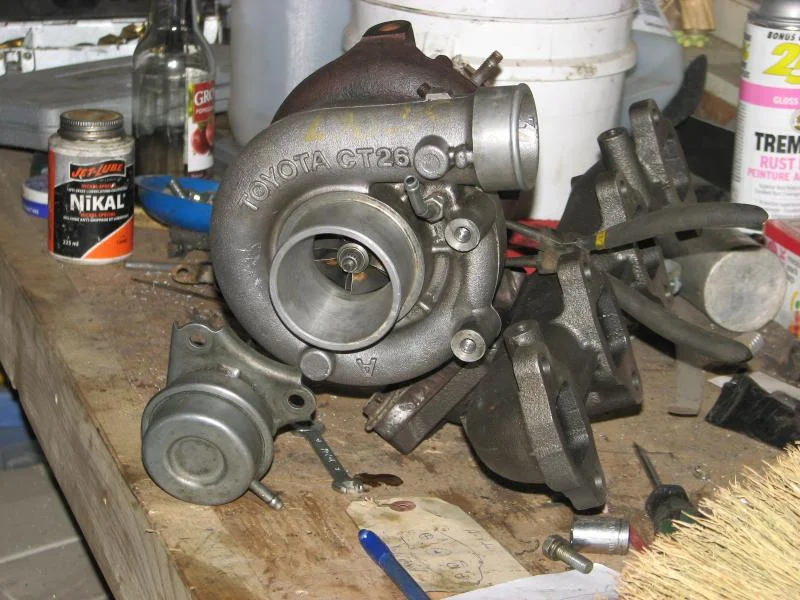

Were turbo'ing Ian's BJ60, maybe this week even. We already pulled the oil pan and welded in a bung for the return oil line, and got hose and fittings for the feed. We will be clocking the turbo and building a bracket to support the wastegate. This week Ian already installed and wired the pyrometer, oil and boost pressure gauges, so hopefully we'll get the turbo wrapped in a day or two, but Ill let him start his own thread in the 60 section...
