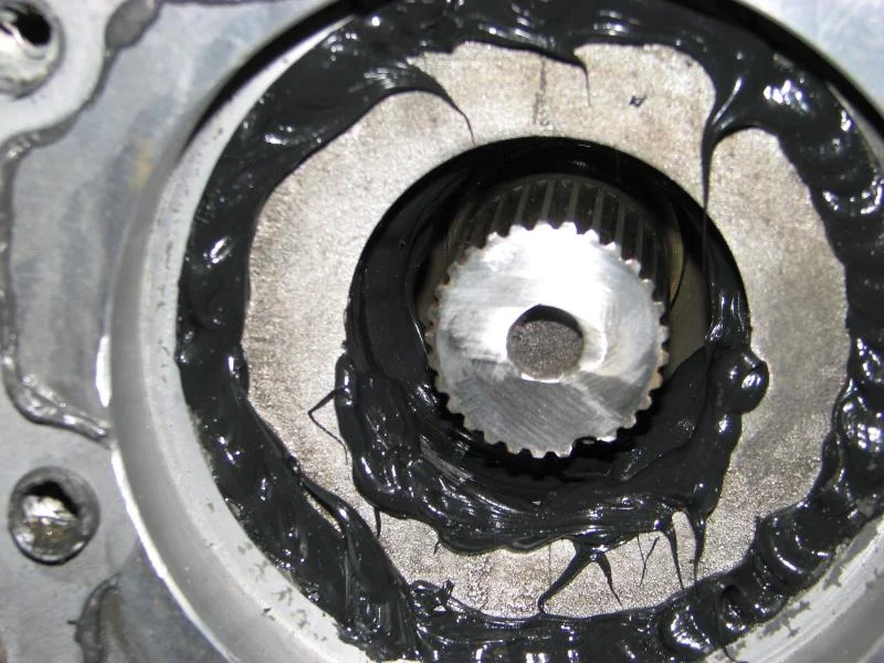

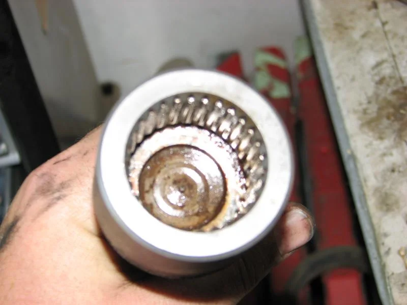

Also, I can think as to how or why the bearing split, there is no strange side loads, the bearing slides in there easily, its almost like it was a defunkt part from the factory.
One thing I did notice was a bit of wear inside the AA output shaft cup where the output of the NV4500 bottoms out at the back of the cup. I measured very carefully how much shaft to chop off as per AA's directions so this was strange. I ended up taking a flap disc to remove a pinch more material. I added some gasket silicone goop in the back to help keep the flow of oil backwards limited, it was moving past the broken bearing and lubricating the pavement and my parking spot at the office.
