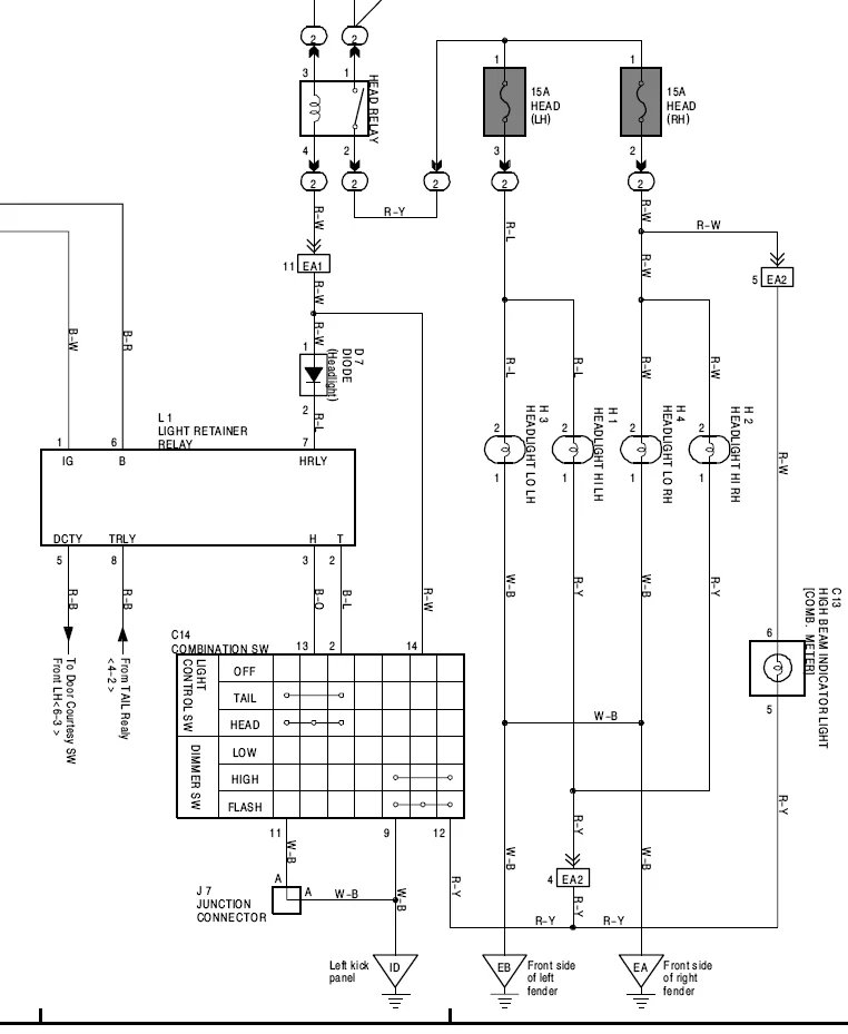

What is actually happening is that the high beams see 12v+ when the low beams are on and then see ground when the either the high beams are on or when low beams are off (if that makes sense)
So basically if you use the ground side of the relay as a switch, the relay clicks ON when everything is off, then clicks OFF when low beams are on, then ON again when high beams are on.
I thought I could just power the relay from the positive on the low beams side of the circuit, since they are positive switched. But could not make it work either.
The more I type the more confused I get, probably gonna leave this one alone for a couple days.

I think my set up might be weirder than the rest.
All I want to accomplish with this is to get a 12v+ signal out when the high beams are on. This will not power or trigger the actual aux lights.
I just need the signal to tell my switch control when the high beams are on.
Are you using a 4 pin relay? or a 5 pin relay? It is it normally open or normally closed?
I think you should be using a 4 pin relay, normally open.
You want the coil GND, Relay pin 86, to be from the high beam GND
You want the coil +12V, Relay pin 85, to be from the high beam +12V, after the headlight relay.
You can also use the high beam +12V for the signal wire, Relay pin 30.
Then pin 87 should carry +12V to your switch control when the high beams are on.

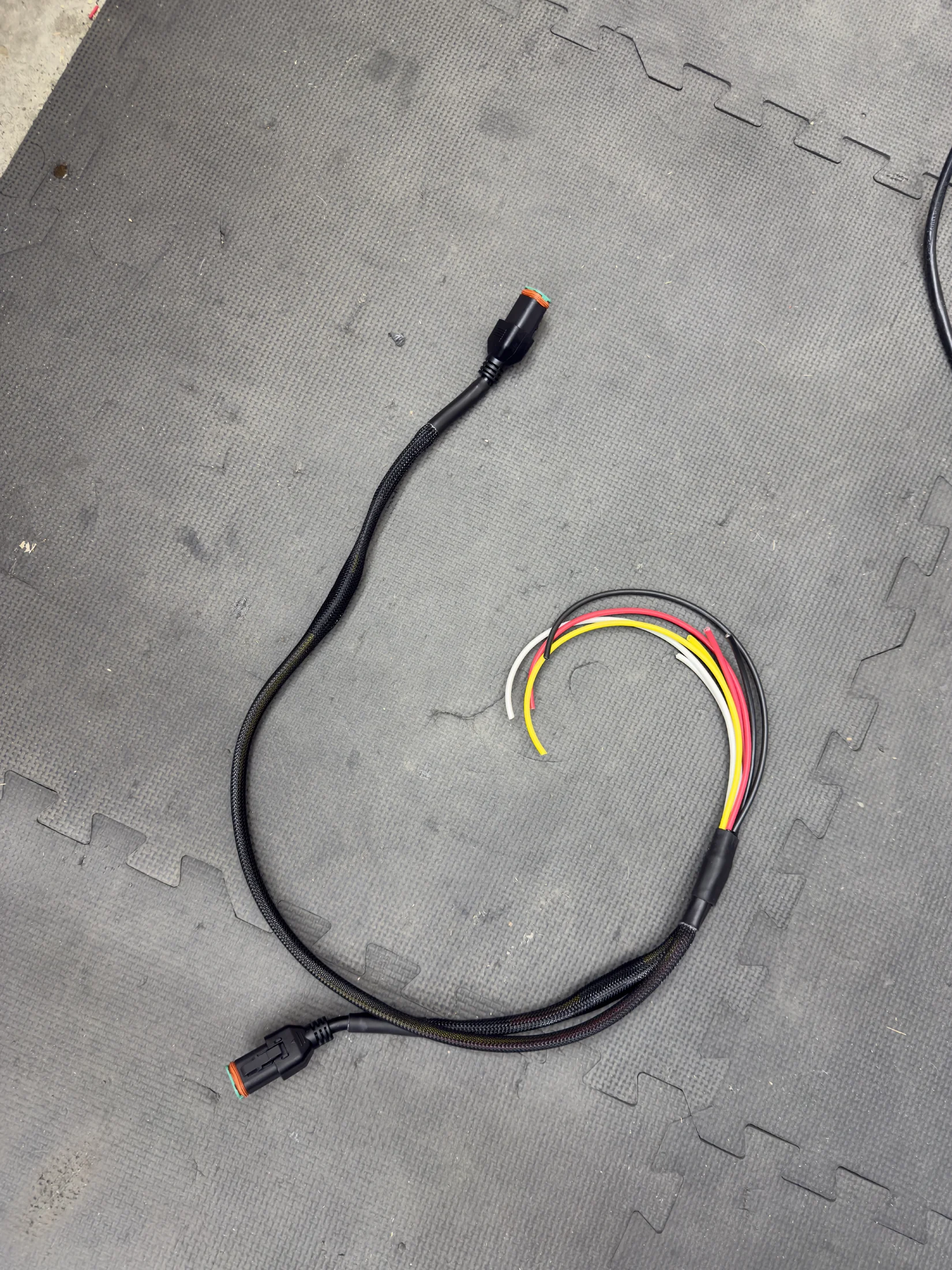

Went to HF last night and got my new lighs
Got started on the harness. A bit overkill but all I had in the proper colors was 12awg. Hopefully I can finish and test it out tonight

I was rereading this and thinking about it
Couple things
Do you mean pin 85 for ground and 86 for +12V? And would it work either way? As long as it is closing the circuit?
Second thing
So, high beams has a red/yellow wire and a red/white wire, and when I probe them with the high beams on, they are both just grounds. I tried tapping red/yellow to pin 85 and red/white to pin 86 and it did not work
Im starting to think this might be above my pay grade 😂
Couple things
It doesn't matter. Either can be used for ground and the other for power.
Second thing
According to my EWD, R-Y is after the high beam lights, and should have continuity (near or at 0 Ohms) to ground with the high beam lights on.
R-Y is what you should be using for ground for your relay coil.
R-W is before the high beam lights, should read a higher than 0 Ohm resistance with the high beams on. The resistance to ground should be the resistance of the light filament.
R-W is what you should be using for power for your relay coil.
Also, depends on which side you are working on.
R-W for Right high beam headlight
R-L for Left high beam headlight
I am actually using R-L for power for the coil as my relay is on that side.

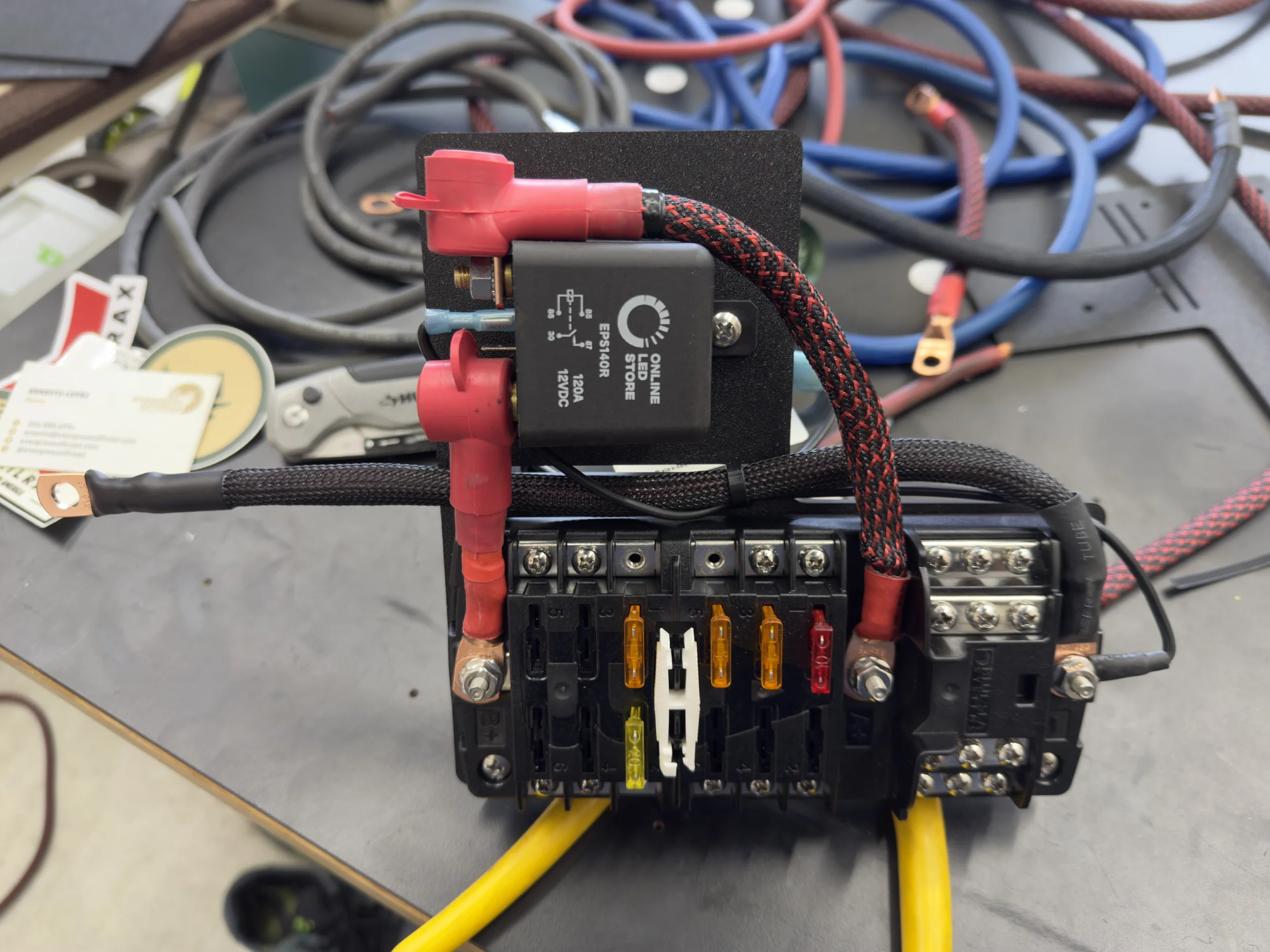

Had some free time today and got to clean some more old wiring.
I installed this split fuse box a few years ago to have a better access to ACC ON power. It is connected via a 120amp relay.
I printed a mounting plate and got it rewired
I also ran some 6awg to the secondary battery. Before it was getting power from the starter battery.

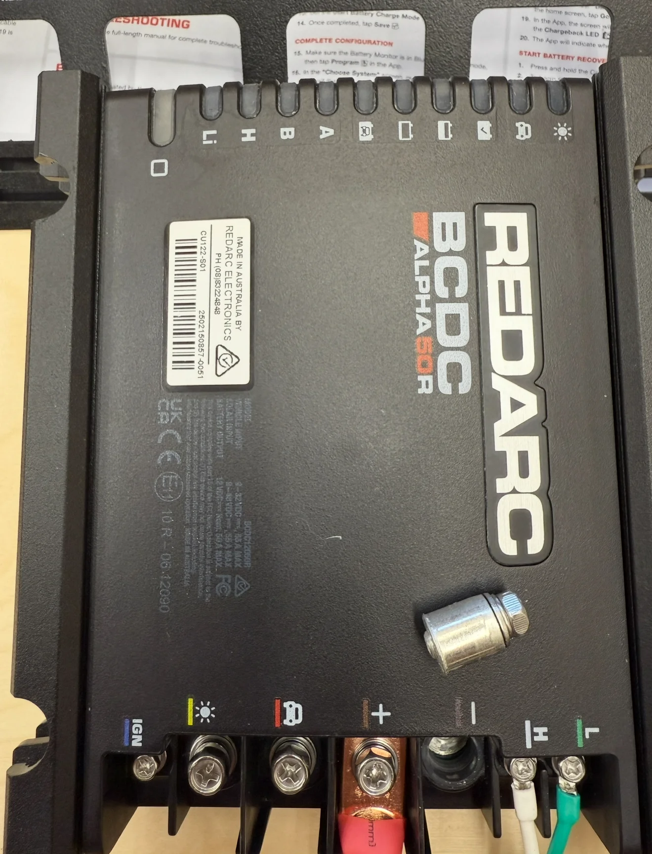

Now to the bad news.
Ive managed to make a very expensive mistake.
I decided to be a good person and use the torque values from the instructions, but I forgot to also use my brain. I misread it at some point and tried to torque a M5 bolt to 15ft/lb.
I emailed Redarc to see if there is any saving to this or if Im just SoL. Waiting for their response.
Some days I wonder if I should be allowed to work on any projects

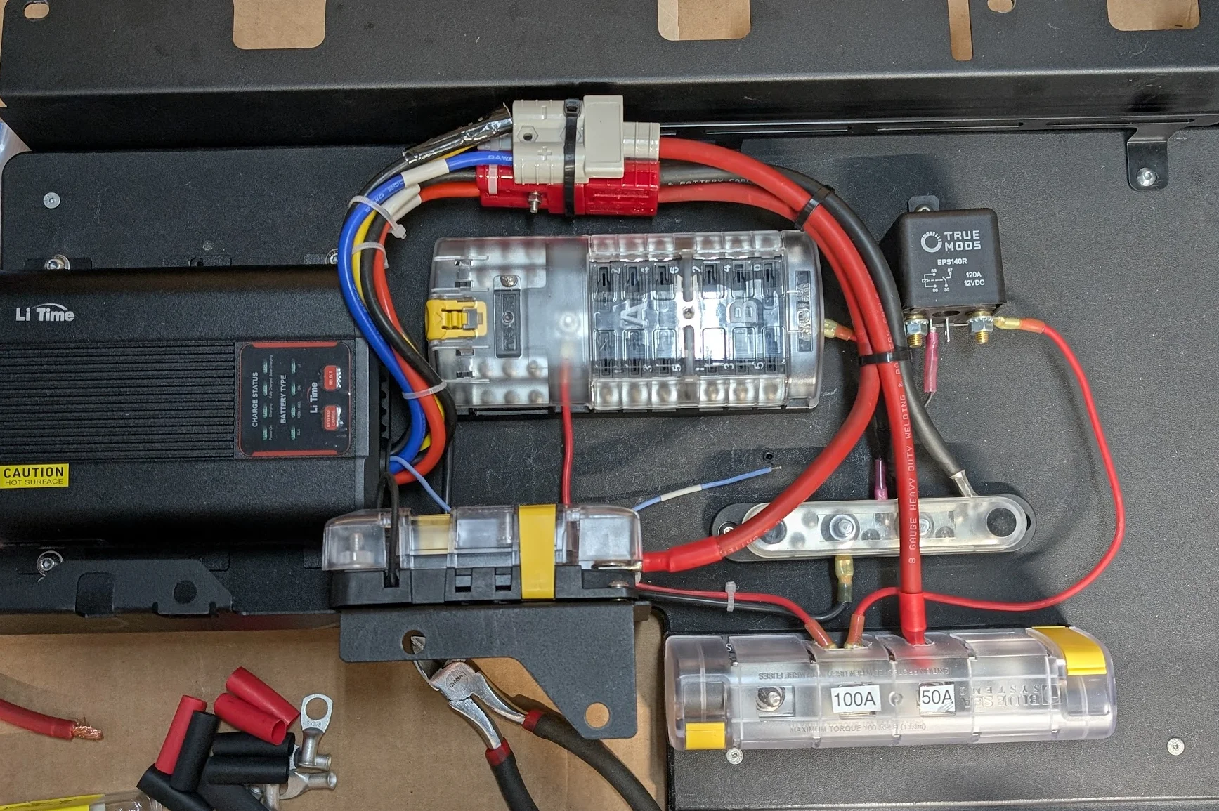

That is a premium bit of kit.
I went cheap with a LiTime DC-DC.
