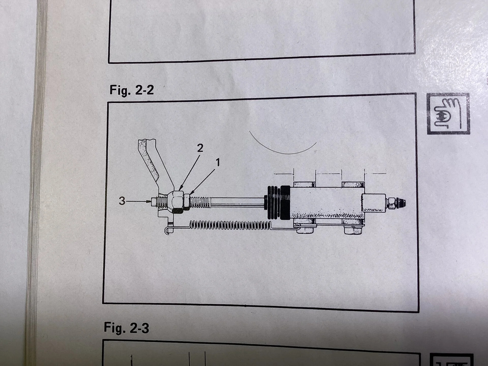

How is the pushrod free play and the pedal adjustment? Should be able to set both of those and see if it’s better.

I played with pushrod play and pedal adjustment, but if I set it for initial press, it’s way too tight for subsequent presses. Both master and slave were bought as a set for my ‘76.

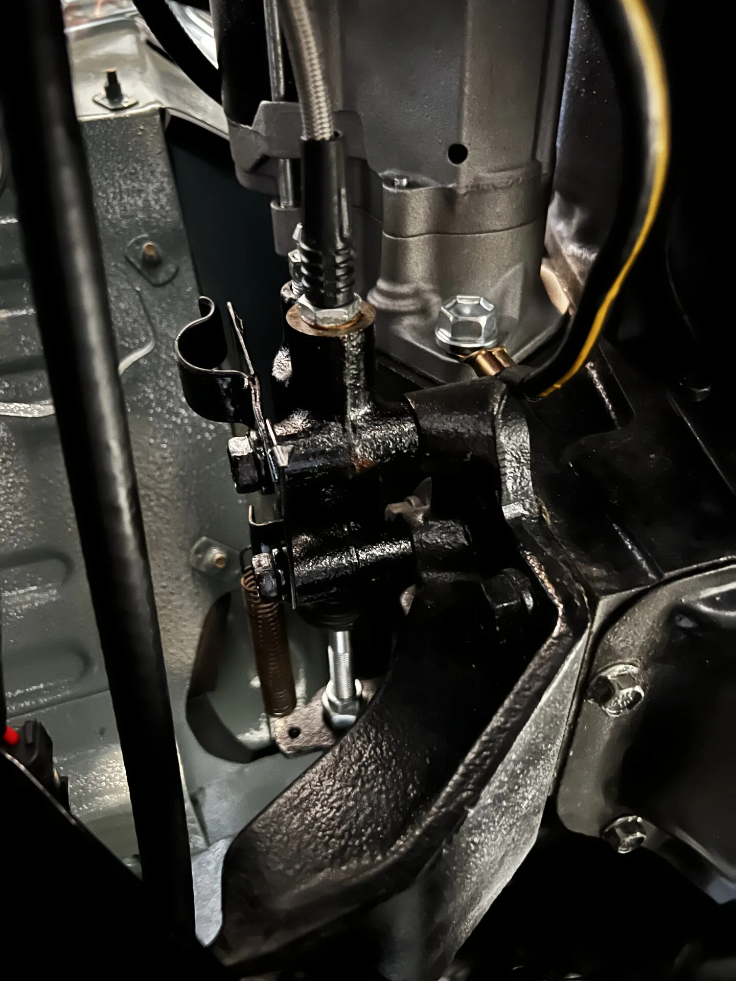

Just an idea, is there a return spring on the slave cylinder?
1st check pedal height. Then pedal freeplay adjustment insures a full stroke of the master. Have someone slightly depress the pedal while someone else watches the slave as it starts to move. Its not when you feel pressure/resistance. My slave is on the drivers side, so I able to use my hand on the pedal and watch the slave at the same time. After that adjustment, Then adjust the slave rod. The return spring is needed to bottom slave piston in the cyldr.
I went through that process. My pedal height was perfect at 8.5 inches. I then adjusted the free play and slave rod to specs. The problem is that when I do that. it's perfect for the first press of the pedal, but then the second press gets pressure much sooner than the first and the adjustments are way too tight. If I do the adjustments after the second press of the pedal, then the first press(es) (after waiting for 10-15 seconds) take the pedal almost to the floor before engaging the clutch.

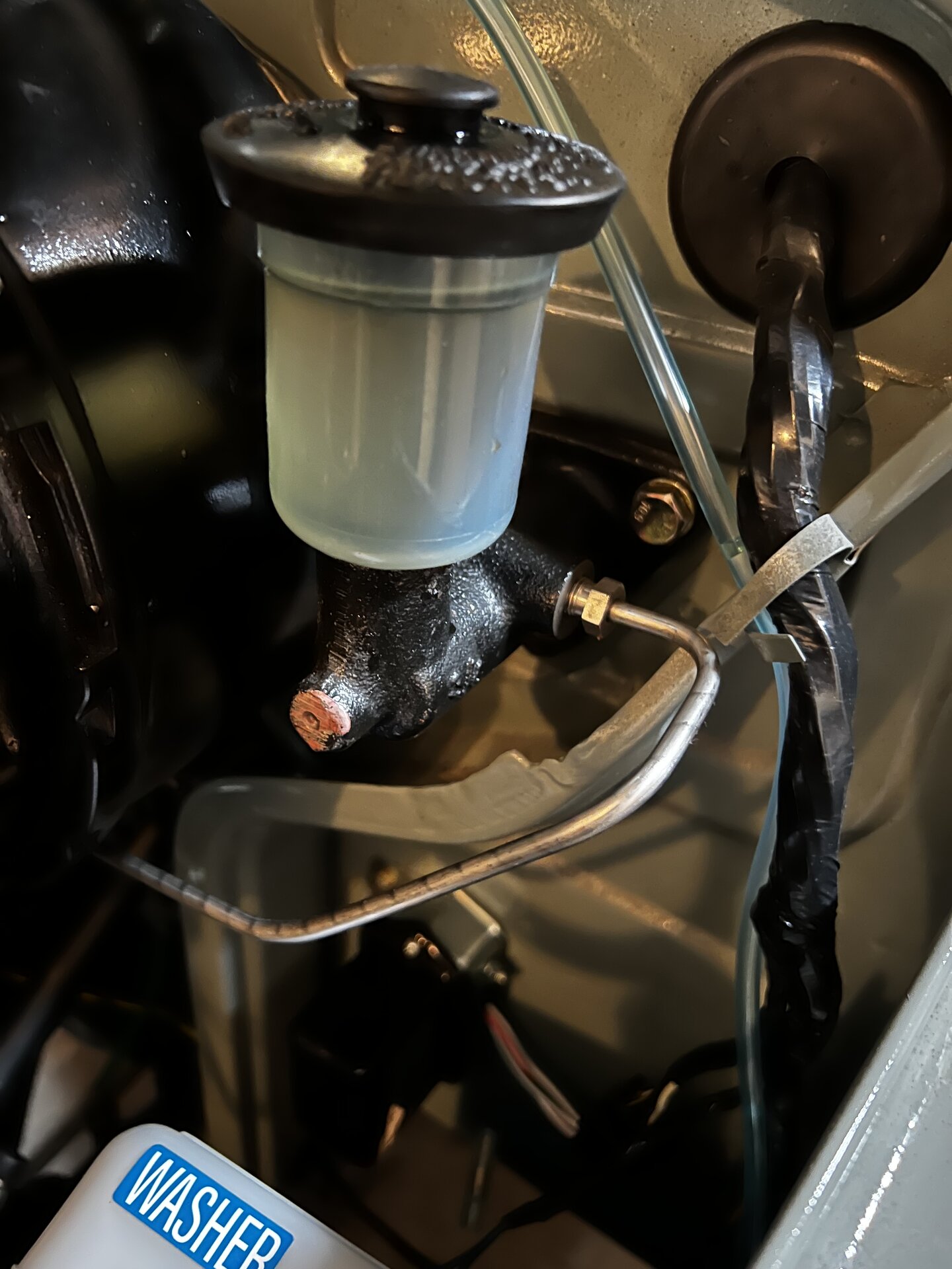

There must be air trapped somewhere that isn't making it to the slave when bleeding the system that requires me to do a double pump. I'm gonna try bleeding the master by itself as igotta40 suggested and see what happens. It's weird because I've never had to bench bleed a clutch master before and most of the posts I've read say it isn't necessary on a 40. We'll see...

What year ? stock trans & motor ? where did you get the new oem MC & slave ? any pics of these ? was any clutch work done ?

Set it all up tight with the first push like you had it with correct pedal , even if it pushes to floor does it release clutch ? when foot off clutch take inspection cover off and see how far fork is from throw out ? If these are right then you either have air or the MC is not moving enough fluid for the slave, in any event you have to verify all the above before going after either of those issues. I have always gravity bled the 40 with success.

‘76, all stock. They match exactly the Aisin master and slave I replaced. No clutch work done.
