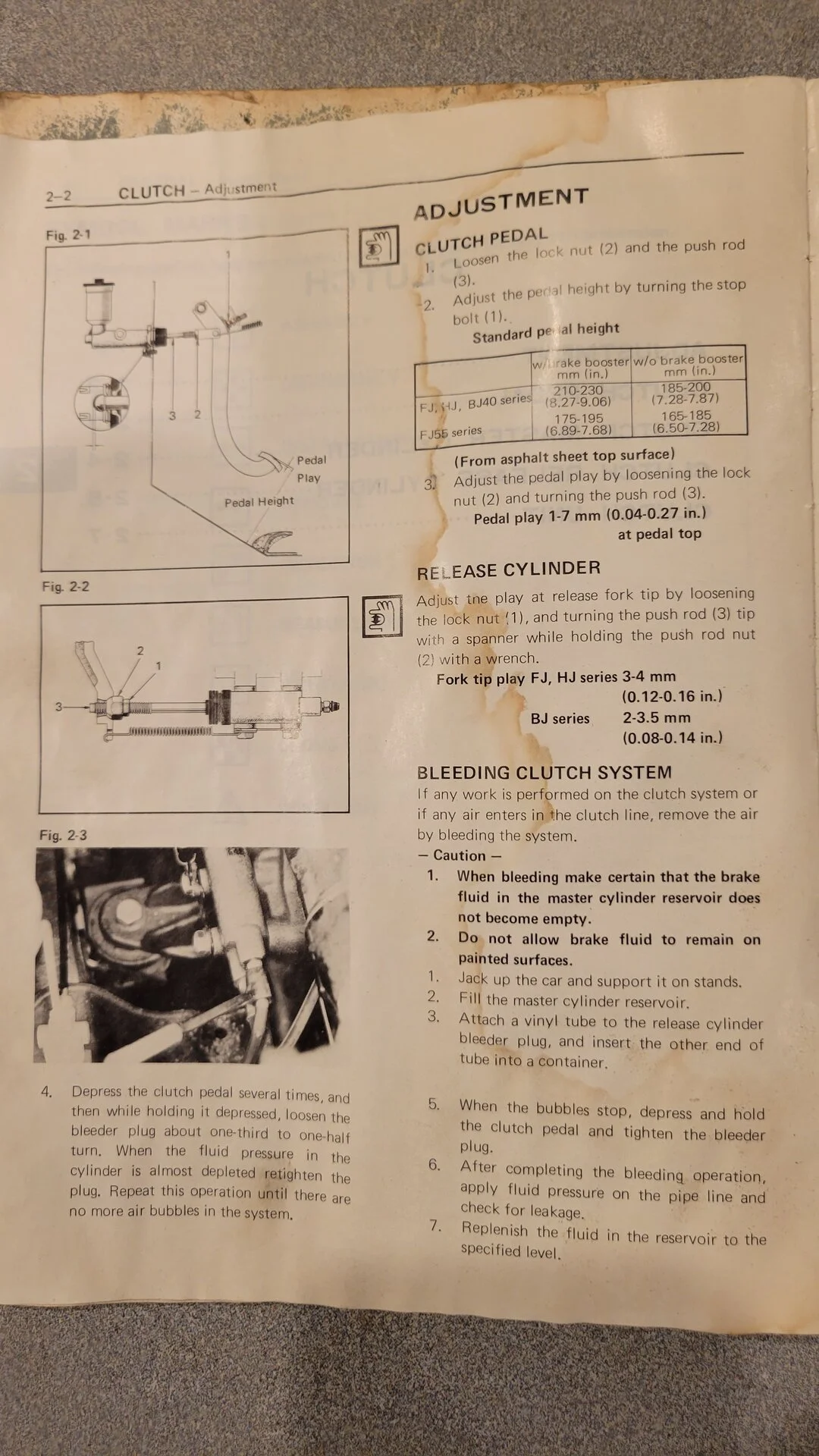

This is fromthe FSM copyright 1974. Idk if earlier models are the same. Set pedal height, pedal freeplay, the adjust the adjustment rod at the slave.
Play between the clutch fork and Push Rod Nut on Slave Cylinder at 1/8" (0.125").
Pedal Height adjusted at Master Cylinder Push Road for pedal at 8 1/2+ inch (8.50").
