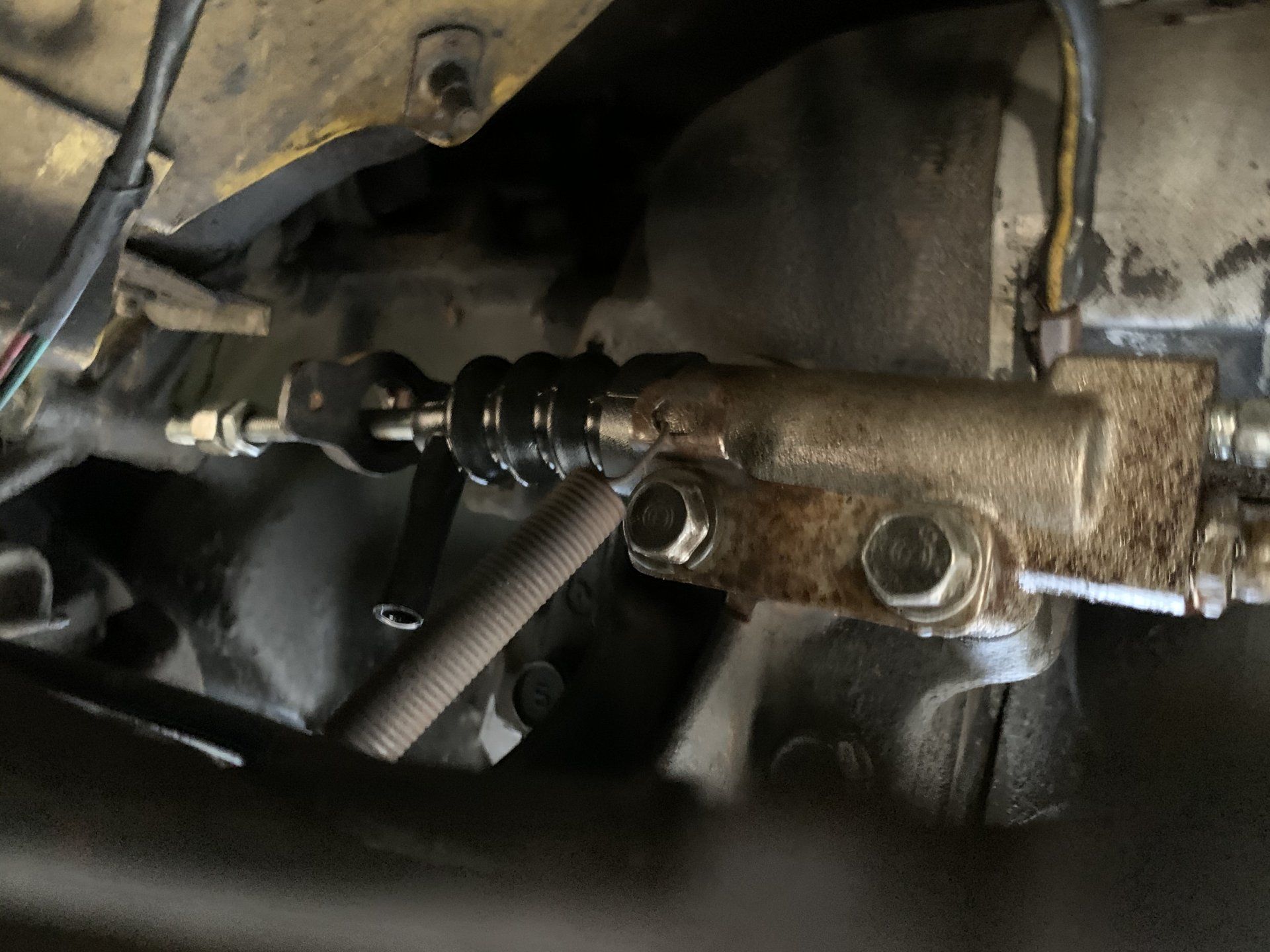

How is it possible my clutch rod is popping through the eye hole - wtf
and what do I do add a washer? My car is in front of a randoms house so
