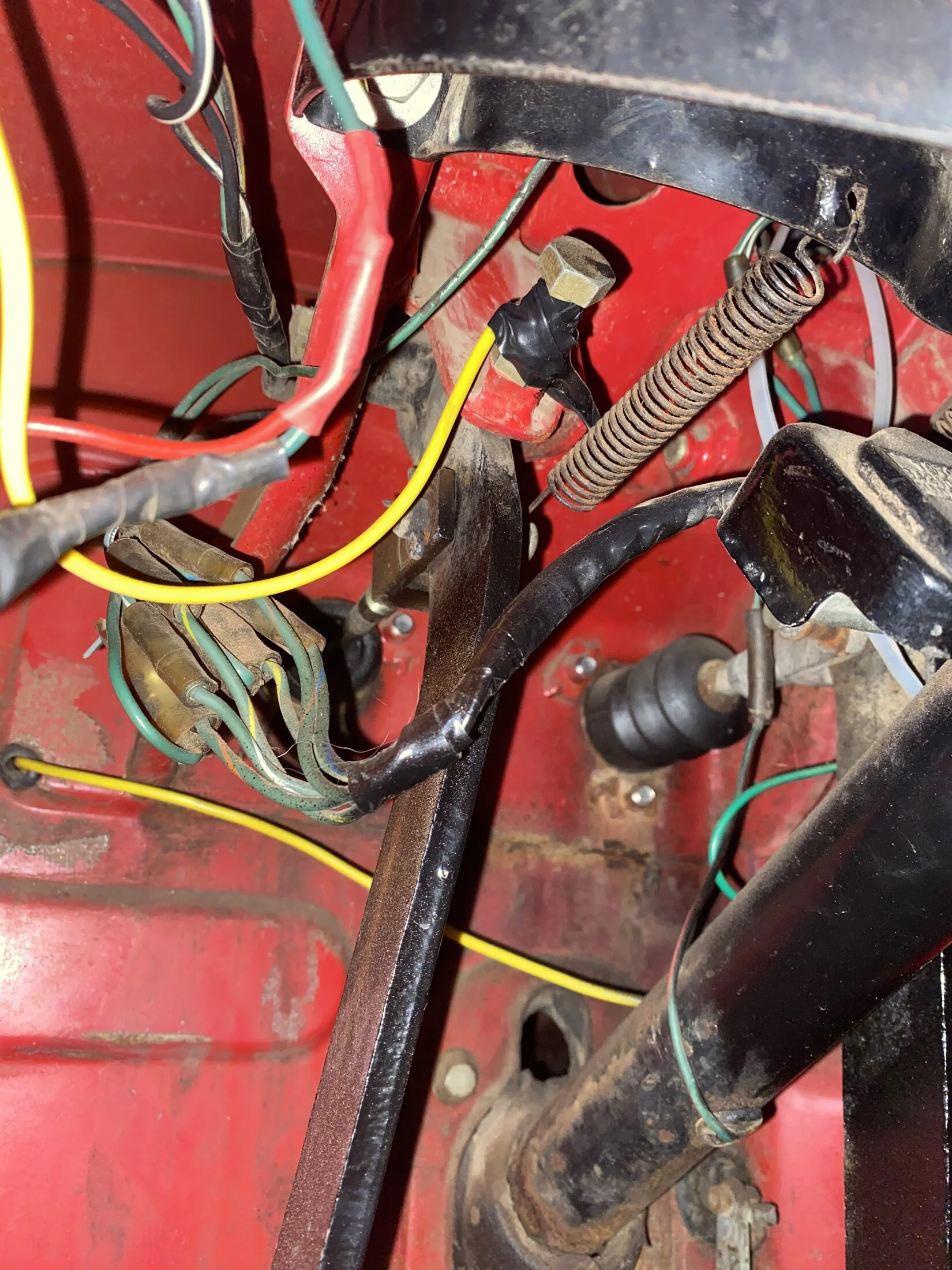

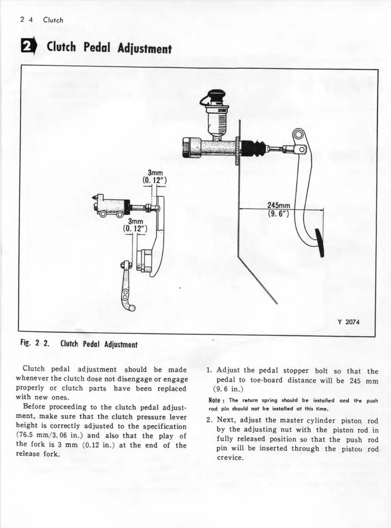

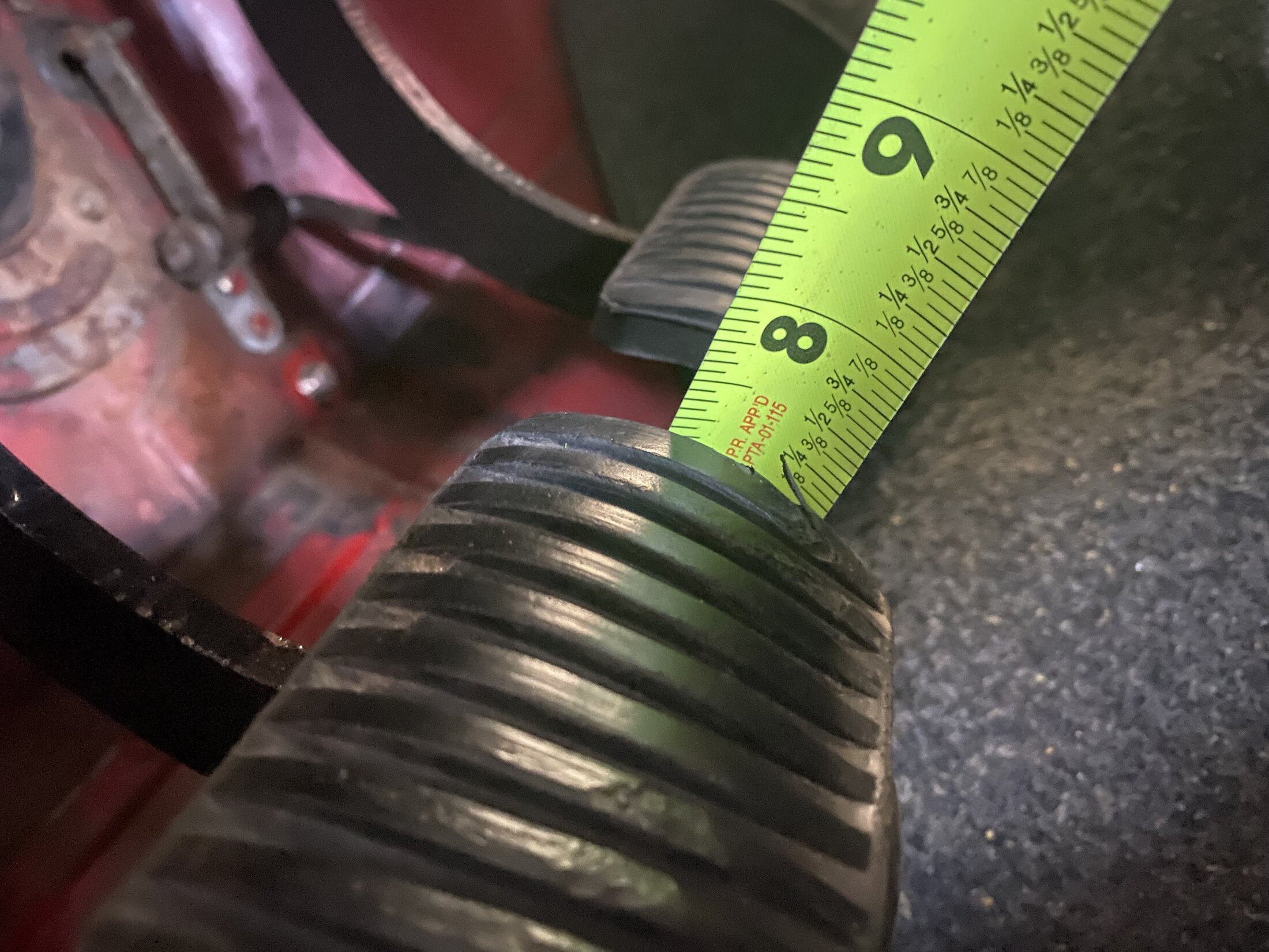

So trying to adjust the clutch pedal. It is about at 7.25” to the top of the pedal, which according to the FSM page is about 1” too short. However, it is the same height as the brake pedal (which I read they should be similar), but when I look at the bolt to adjust the pedal higher the pedal is maxed out against the part where the adjustment bolt is…so there is no way to adjust the clutch pedal higher, unless I am misreading how to make the adjustment.
Excuse the electrical tape on the stop bolt…using it as a ground.
My clutch pedal was set down about 2" by the 6'5" PO when he put on the hardtop. With rag top door he could bow it out enough to shift, not so with hard top door. I'm only 6'2" but it works for me so I never changed it.
The more relevant question is how far you can push it down before you feel it making pressure inside the MC? If you’re not familiar with how the hydraulic system works, you might have to temporarily remove the return spring in order to make that evaluation.
The fsm page I posted I'd from a copyright 1974. 1964 might have a different spec.
As Mark mentioned your freeplay might be off. I found having someone watch the slave for when it starts moving while you start pushing on the pedal. I found using my hand to push the pedal because the adjustment is slight. Once height and freeplay is adjusted you can adjust the rod at the slave. Make sure the slave piston is fully retracted in the bore. Push it in, then adjust the rod. Be sure to use a return spring when your done.
It feels like about 1” of free play. I measured how the FSM page above shows and it is right at 9”, although as mentioned, since it is now a 4 speed who knows what it should be.
