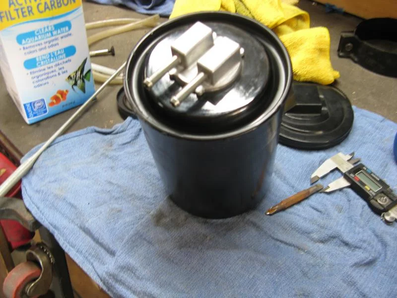

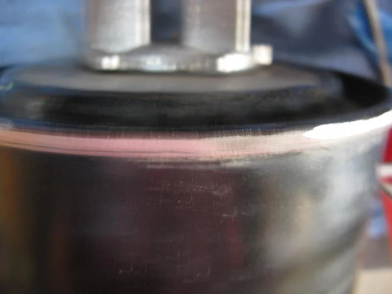

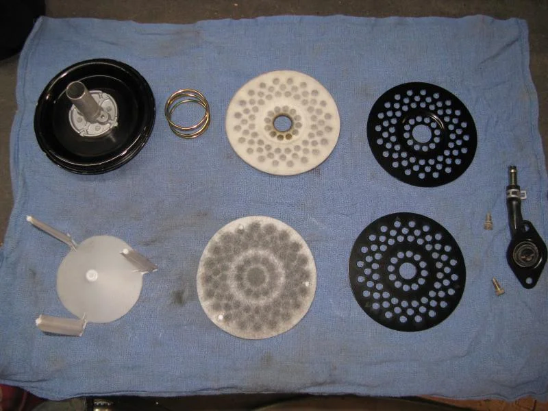

I just did the rebuild on the OEM charcoal canister with good results. Cost was ~$12 for new charcoal and some time to cut it open replace the charcoal, clear the sticking vavles, and reseal the can. Not much saving it you value your time:rolleyes: I was more curious on why it failed.
So where did you make the cut, how did you cut it and how did you reseal it? I need to replace mine, but don't like the aftermarket solution.
Make sure to blow out your check valves really well with compressed air. After spraying mine with carb cleaner they were sticky after I reassembled and waited a day. I couldn't blow through the input valve with my mouth anymore. I ran a couple small tanks of compressed air through it at 43 psi (like the FSM says) and it fixed the problem. I guess there was still some residue or something in there. Not sure if this will actually be a problem on the vehicle, but the FSM says you should be able to blow through the check valves with ~1-2 psi which is about all you can generate with your lungs. I've been running my refurbished one for awhile now with no issues. Just filled up my gas today and I had absolutely no venting.
As for cause of failure, I think the check valves just get dirty and stick. This causes the high pressure. Also, the carbon loses it's ability to release the adsorbed fuel vapor and adsorb more. At that point, it's just venting fuel vapor to the atmosphere instead of storing it in the canister. This causes the bad fuel vapor smell.
I agree the sticky valves are the main issue, not so much the charcoal but its open so why not.:meh:. There are 2 active valves and 1 open, the large tube that goes down into the canister is one of the active valves. Brake klean worked well for clean the sticky valves for me.
