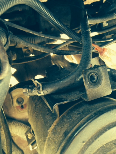

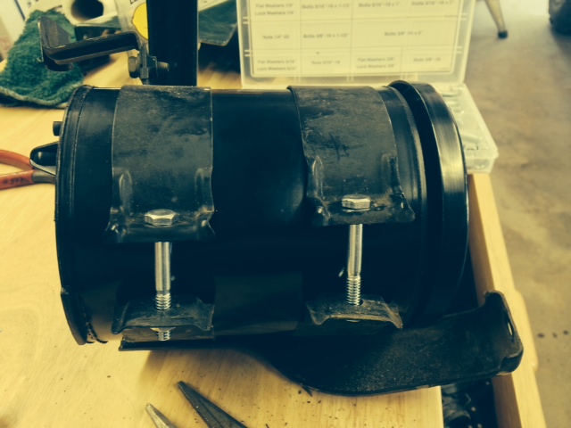

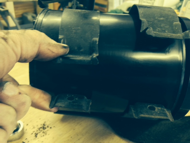

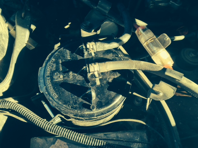

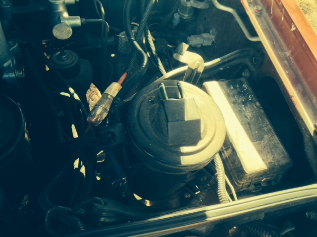

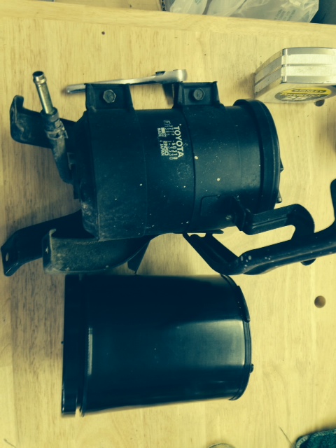

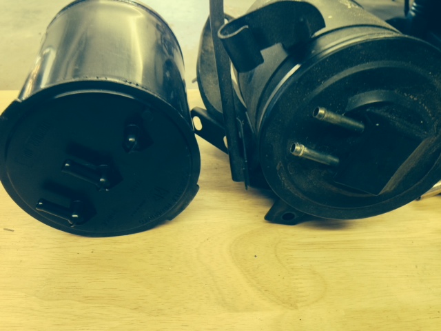

Just completed my change out. Removed the 3 bottom bolts on the bracket, top bolt for hose holder, 1 on the sidewall and removed the canister and bracket. I replaced with the Autozone GM unit and even though the inlet was slightly larger than stock, all I did is reuse the lower hose that is no longer used and used it as the inlet hose and it fit perfectly. Below are my pictures.
Stock one.
Looking down at all three bolts that hold bracket at the base.
Canisters new and old.
Top of side by side view.
Side view of new canister, note, you will need longer bolts
With bolts install, old canister pinched the brackets, new one you have at least 1" space.
All mounted back in place using the left over lower house now for the inlet hose.
I just did this. I removed the lower clamp holding the new canister prior to installing it as that was hitting the wire bundle coming out of the fuse panel. It's just one bolt and opens up some room down there.

You don't need to change hoses with the VC120, but the hose from the tank is a VERY tight fit (it is too small but will go on with persuasion).
alright , im just still not clear on how the drain in the bottom of the factory one matters or not when you put on the vc120
matters not. the stock one goes into the fender, vc120 goes straight out the bottom

One tip I would offer is to make sure you have the head of the bolt holding the clamp on the canister in the side closest to the fuse box (in a 96). I didn't do that first and the threaded end was rubbing against the fuse box.
I removed the bottom bracket/clamp all together and made it so the bottom of the canister doesn't touch the bottom of the mount.
