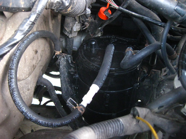

Here re two pics of the installed CC. I used a piece of 1/2" fuel line and ran the bottom vent to the fender well right at the upper coil bracket. I used one zip tie to hole the canister to one side in the original brackets.
Appears to be much smaller diameter that the original, how did you secure it?
Via a single zip tie around the canister as well as one side of the original bracket, it just pulled it to one side and is holding it there against the bracket. There is not much need as I see it to really clamp it hard into place, just need to hold it secure. I have taken my old canister apart and will be cleaning it, replacing the charcoal and putting it back on eventually so this is a temporary fix. This unit was cheaper than the other canister and more important to me is that it vented out and could be directed away from the engine compartment. Just my 0.02!!

I just installed the "BWD Fuel Vapor Canister" from Pep Boys. It cost $35.99. I had to remove the lower bracket and use a zip tie on the upper bracket. The lower bracket, when stretched to fit around the new, bigger canister, interferes with wires coming from the fuse block. It seems plenty tight with only one bracket and a zip tie.

Thanks Jeeper for starting this thread and all others with info. Just installed the pontiac canister (ebay for 50) and no problems with gas tank venting now properly. One word of CAUTION-- The lower braket was hitting/rubbing on the wirebundle from the fuse block. I removed the braket and all is good.
