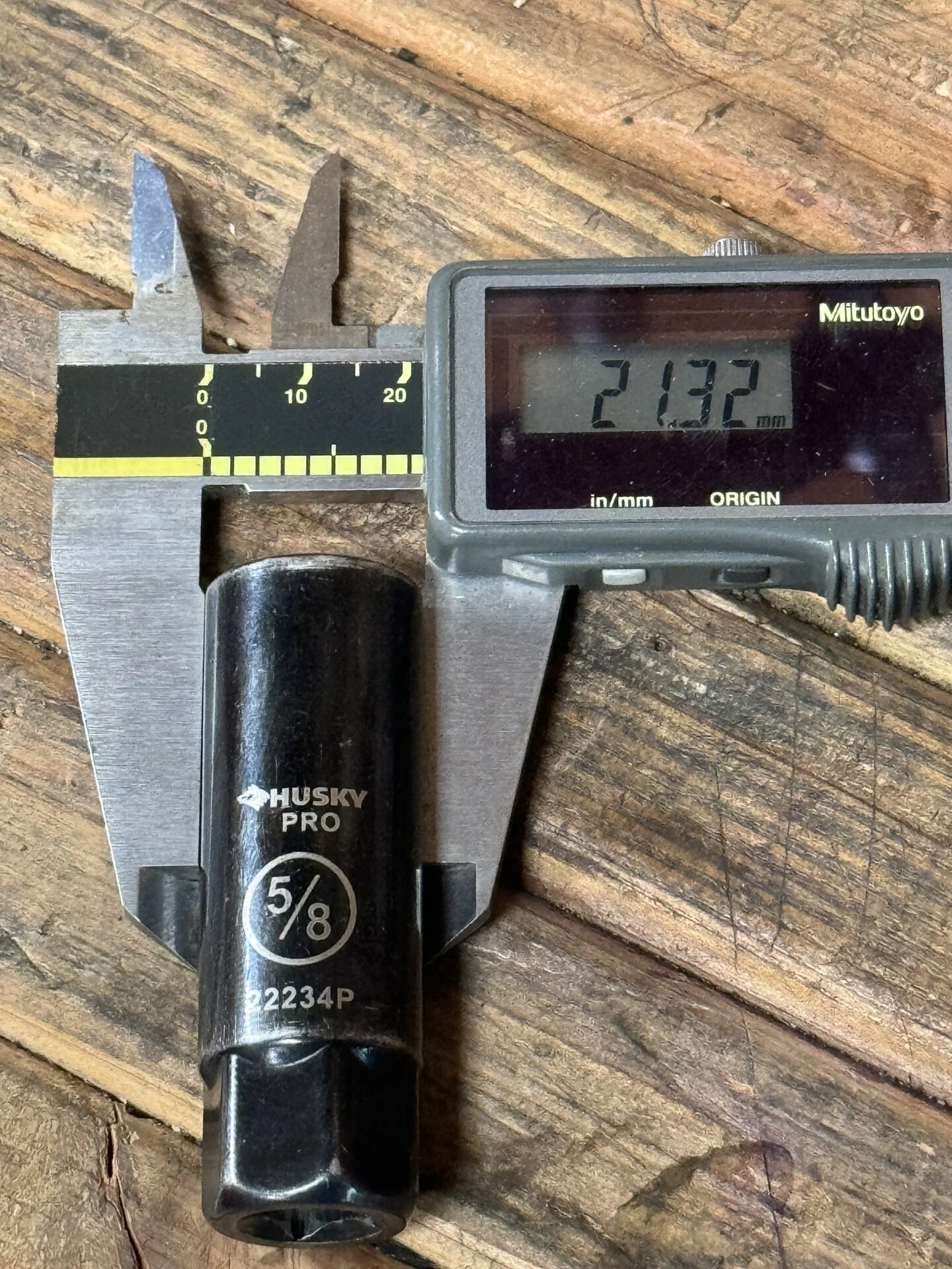

I have a weird quirk to add...
I recently did the second plug change on my 200 and had some issues. The spark plug socket I was using could grab the plug and turn just fine, and would come out with the old plug. But when running the new ones in, the thing would get jammed and refuse to come off the plug, with the extension slipping out.
I've had vehicles do this in the past when the rubber gripper was too strong, but in this case I lubed the thing and it was still happening.
It turns out my spark plug socket was -just- large enough to get stuck in the well behind a small shoulder down at the level of the plug when it was seated, but not grab it enough to impact the feel of turning it in. As the old plug was unthreaded it would push the socket above this shoulder so it no longer grabbed. When I figured this out and prevented putting the socket all the way down in the well, I had no more issues.
So I measured the socket and figured I'd post the dimension to help people prevent this problem. I'll now hunt for a thin-walled spark plug socket to avoid this problem when I do my next plug change in five years..

Also @bloc my plug socket is 21.71mm in diameter.
