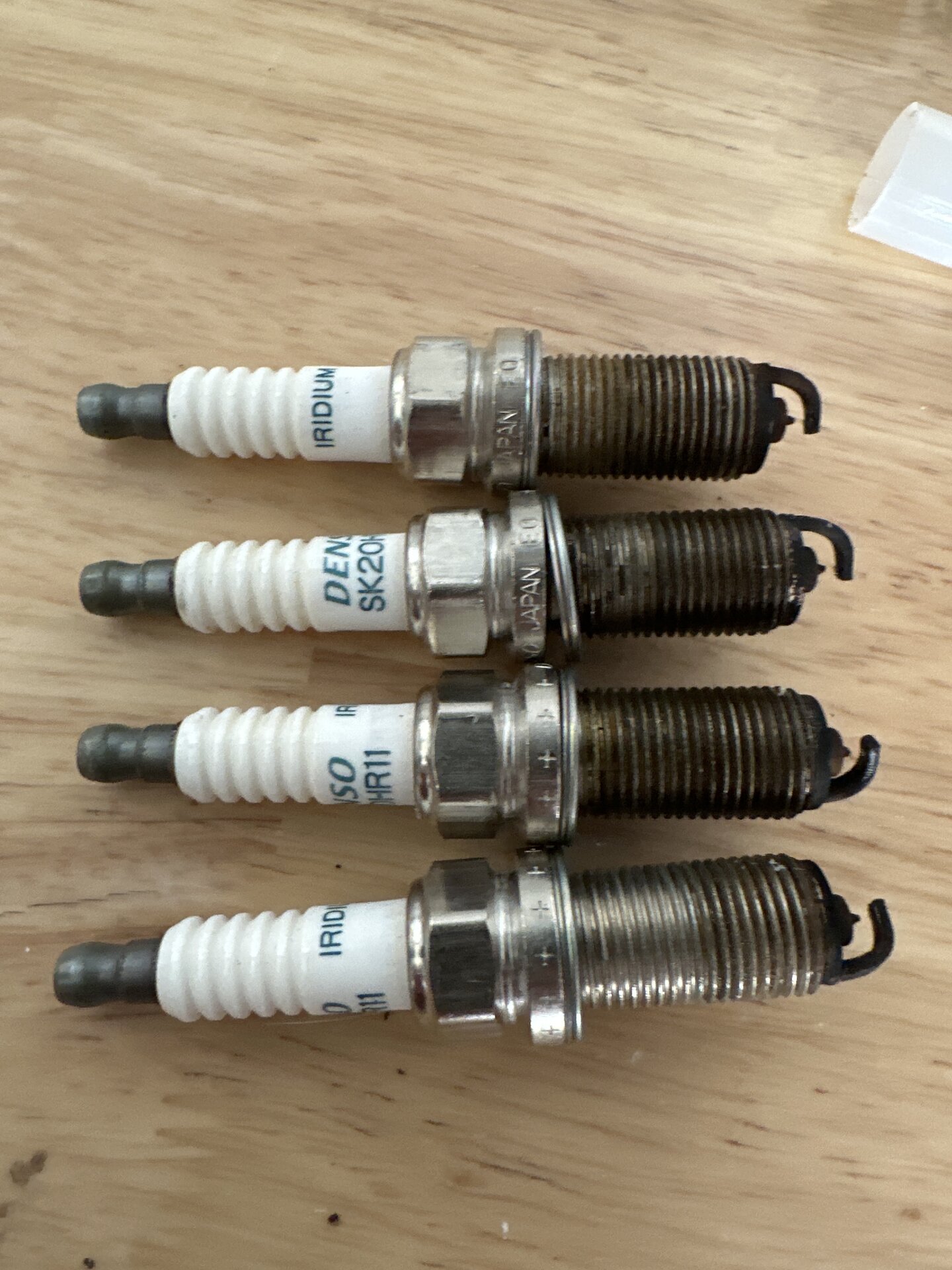

Here are my plugs from a 2015 LX570 with 150k miles on them, never changed before. Noticed some powdery rust on the threads of cylinder 1 and 5. They were noticeably tighter when trying to remove. I did purple power and wash the engine bay about 2 weeks prior to pulling these plugs. This may or may not have contributed.
When putting new Denso SK20HR11 I put a very very small amount of permatex anti-seize on the threads. I backed off the torque spec by a couple pounds.

I wish I had made notes of exactly how I did the firewall plug for future reference, but I did all 8 in a little over an hour and definitely didn’t unplug anything from the firewall or remove the air box. The plugs were likely original with 260k miles. Note the points are worn completely off of all the electrodes. Yikes!

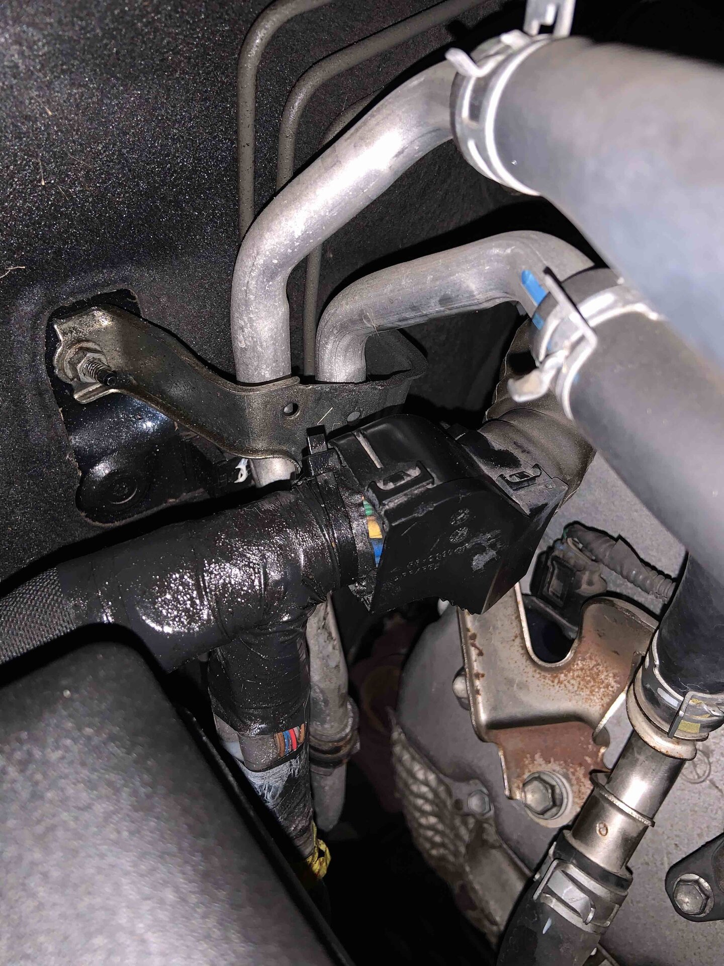

Release the wiring harness thingamajig that hold the wire bundle. This will help move the bundle out of the way.
How did you get the wiring harness and plastic bracket off the metal holder? I'm having some trouble getting it off. (Pulling doesn't seem to work). Did you just remove the metal bracket itself?

Pull up on the small tab in the center of the harness locator pointing toward the bottom right of the image. It'll slide right off the metal bracket.
Hmm this is interesting. It seems like I have a different plastic bracket (2017). It looks like the one in this video:

I just went to look at mine. Yours has a tab like the above picture but it’s on the bottom so you’ll need to feel around for it and push down instead of pull up.
