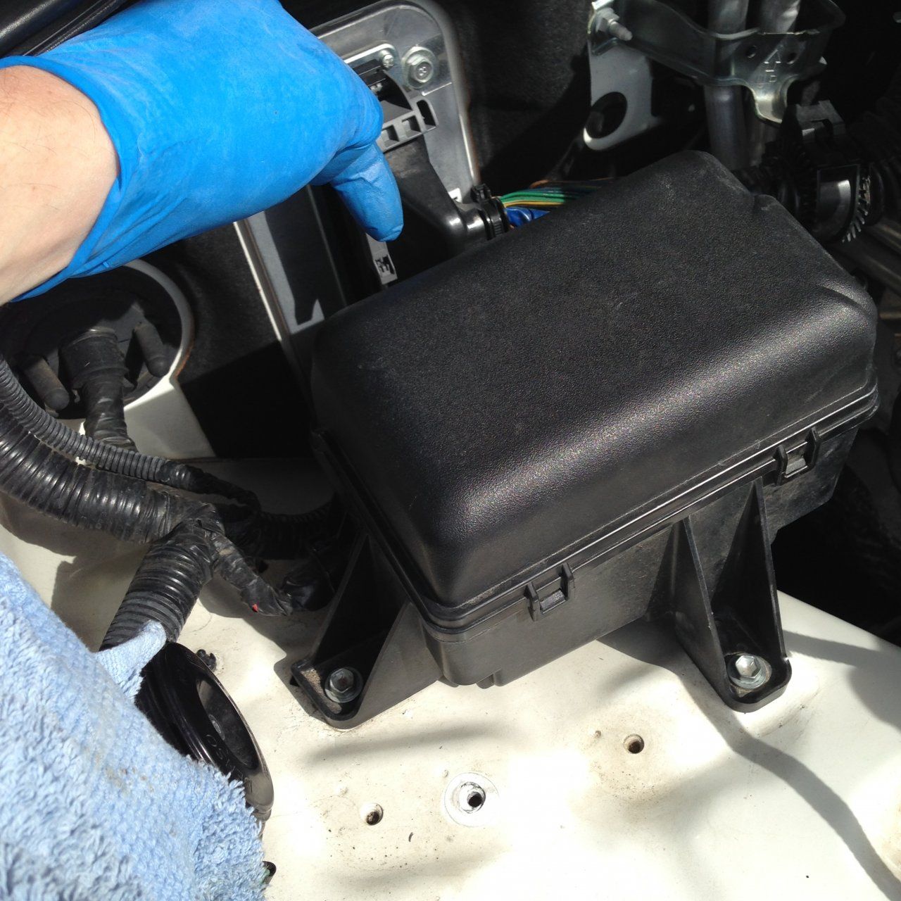

To get to the firewall plug, remove the three bolts holding the black electrical box (finger pointing to the third bolt).
Disconnect the wiring harnesses from the firewall. To do this, flip the gray lever all the way up and the plug will disengage.

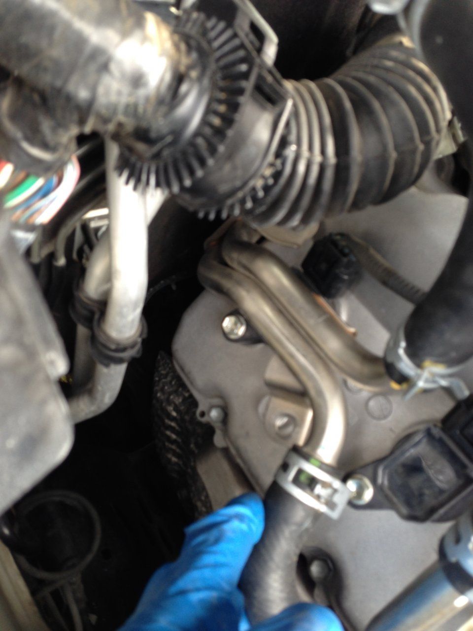

Now I loosened the coolant tubes overlying the plug. There were two in this area.
Now I removed two more bolts on another set of coolant tubes to free things up all the way. Sorry I don't have a pointer, but I tried to place the relevant bolts in the center of the picture.

If I remember right, I needed to do that to get more movement from the electrical box (relays?).

I didn't remove the electrical cable or back fuse box, just the 2 bolts that hold down the coolants hose bracket closest to the firewall. I did however disconnect 3 of the coolant hoses to get better maneuverability, spilled about a cup of coolant all over the place, which is probably why FSM says to remove the bottom plastic cover under the truck (plastic skid plate thing - don't know what it's called). Otherwise I'm not sure why that's part of the process.

Passenger’s side was a little more time consuming, but once you unbolt the four coolant hose brackets mentioned in the photos, everything is pretty straightforward. I did the firewall plug first, so it was all smooth sailing after that.
