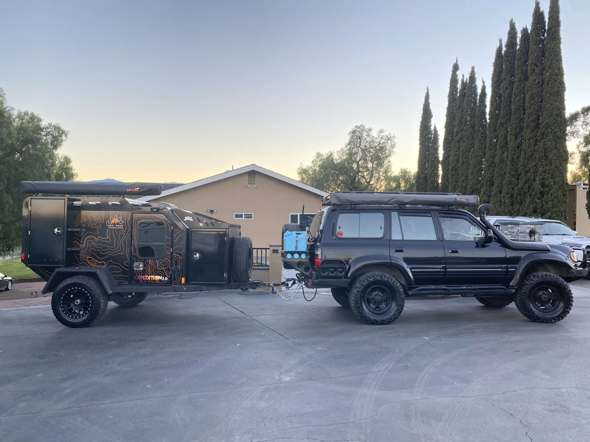

My 80 is converted to 2WD and now I'm towing a OTG trailer. The 80 is running 315s and 4:88s and even with the trailer in tow I still see 45-50 more miles per tank on flat roads of course. Trailer and Rig feel pretty solid on the road to me.
