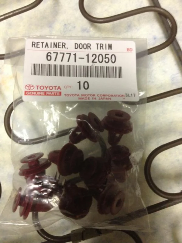

I just got the push pins that hold the rear trim in place.
Here is a pic & part # 67771-12050
What did those 10 retainers cost?

If you are ever at a pick n pull you can grab the same plastic fasteners from other toyotas. If I get charged at all for them I think they are 10 cents a piece. I break those things all the time when reinstalling the trim. Sent from my iPhone using IH8MUD

I bought those red clips on ebay. They were NOT the same size and would not clip into place on the panels.
