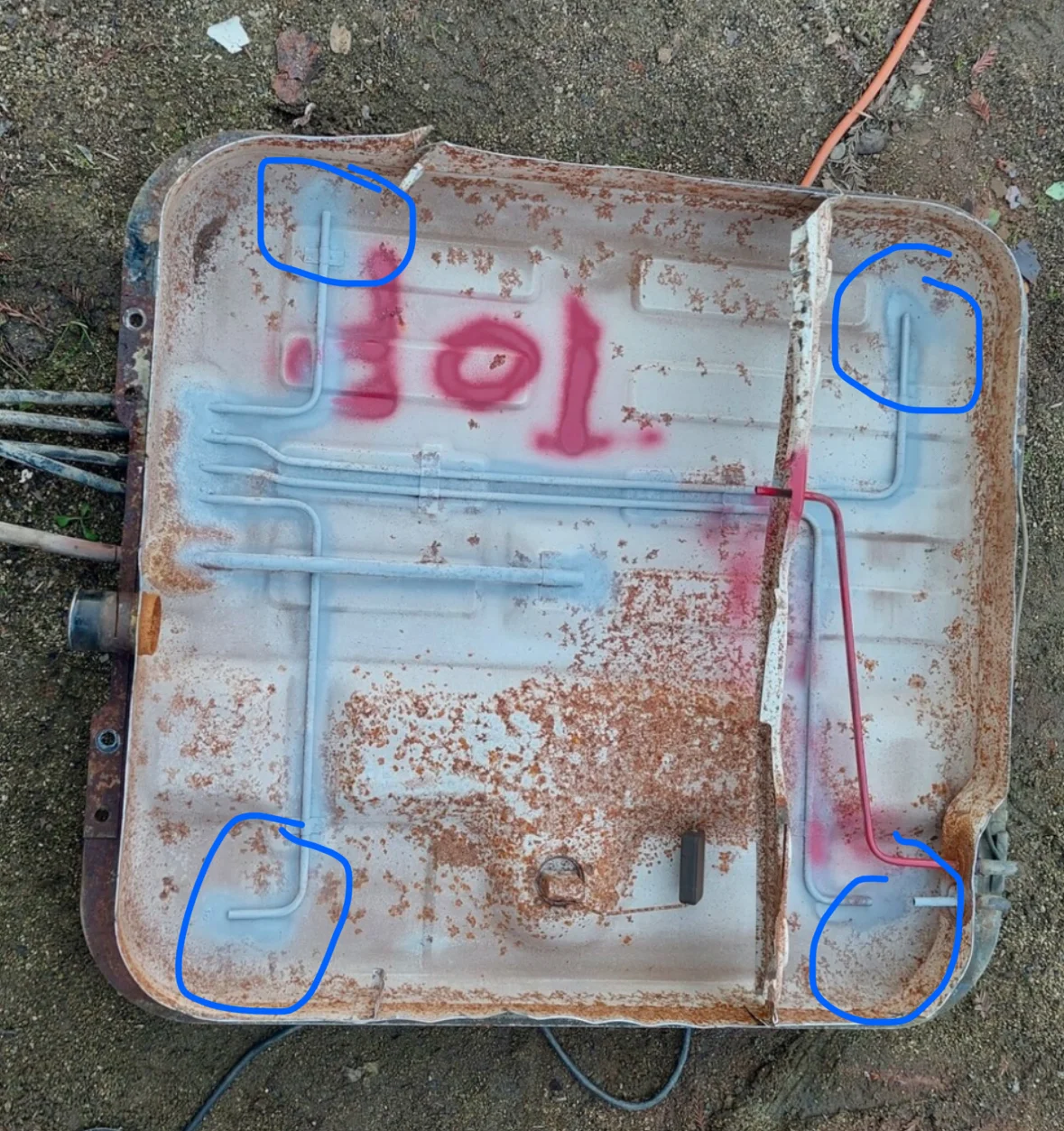

Either way im going to blow some low pressure into the 4 vent ports i see. Adding some more pics of the actual vent hoses from vapor separator to the tank itself.
Okay, that is interesting. There should be zero pressure in the tank, and there is still pressure in the tank. Haven’t yet heard of tank internal vent lines being plugged, but anything could happen. All the hoses appear to be in good shape.
Yeah, I’d blow air through each of those vent hoses (with the gas cap OFF) and be sure they are clear. Check that vapor separator can to be certain it’s clear (I’ve always thought they were empty, but don’t know for sure).

So I just blew into all 4 gas vent hoses and felt air coming out of the inlet. So I’m guessing theres no clogs, the fuel vapor separator also doesn't seem to have any obstruction , blew into all ports and felt air coming out, no fuel was in it.

Yeah, kind of at a loss as to how there could be either pressure or vacuum in the tank when the vents are wide open.
From the video it almost sounds like the vents you’re blowing into are submerged. There shouldn’t be any gurgling when blowing air into the tank from a vent line.
The air is going through the lines and coming out on the ceiling of the tank, which should be an airspace, unless for some reason they’ve all broke loose and are hanging in the fuel!

Nice work @RUSH55 posting the picture showing where the vent lines live.
With the tank half full now those vent lines should not be gurgling at all.

No matter how many times I blew into the vent lines I could hear gurgling, I could also see fuel coming up the filler line too (not overflowing but slowly rising the more air I pushed in). I was blowing air at about 10-15 psi and would hear gurgling, but when blew with my mouth it wouldn’t really gurgle and there didnt seem to be any back pressure.
I did in fact blow air towards charcoal canister and it was all clear (posted a short video clip of it). I also blew air into all inlets of the separator and the outlet, all seemed clear and free flowing.
I am almost thinking that maybe I am blowing air at too high a pressure and its causing just enough pressure inside the tank that it displaces the fuel a little bit and causes it to rise + gurgle? I am not too sure… I had to leave again for the weekend but Ill be doing more testing this coming weekend.

You might try putting the cap on, and putting a small amount of air through one of the vent lines and see if you can feel air coming back out the other vent lines. Regulate it to only 2 - 3 psi if you can. 10 - 15 psi is too much IMO. No telling what’s going on in there with that much pressure.
That's a good idea I'll try that this weekend. Thanks
