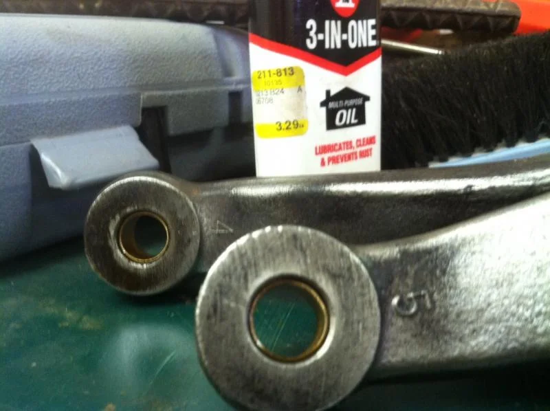

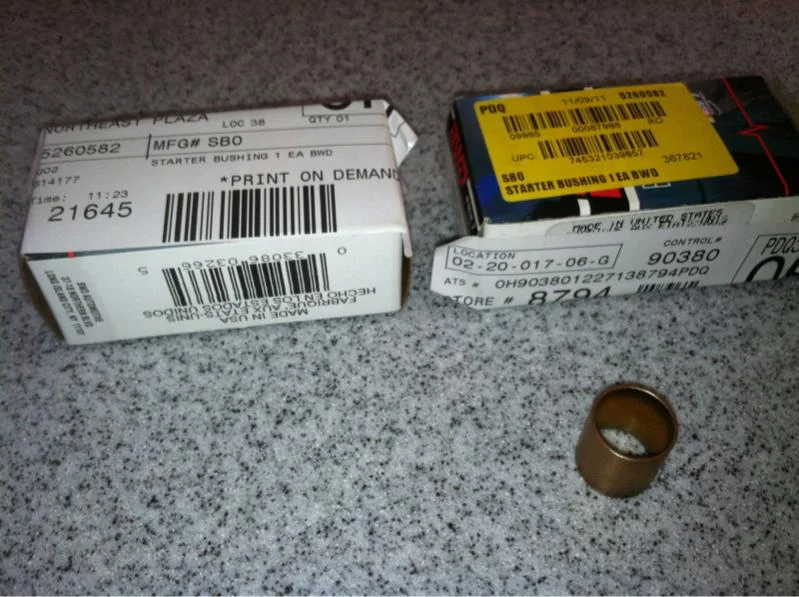

Sb0 at any local auto parts store.
I chose orileys.
Order one or two Extra...you'll crush at least one
That is what I am doing - I've actually already mounted mine. And yes, I did crush one before I got it right.
Haven't installed them in the truck yet so I can't speak to fitment.
Chevrolet Starter Bushing, Part # SB0, or 4200B (different manufacturers, same part).
They are brass, so not as strong as the steel, purpose built bushing. Several folks on mud swear by them, several folks say they will fail. At $4 each, instead of $15, I decided I'd take my chances and see what happened.

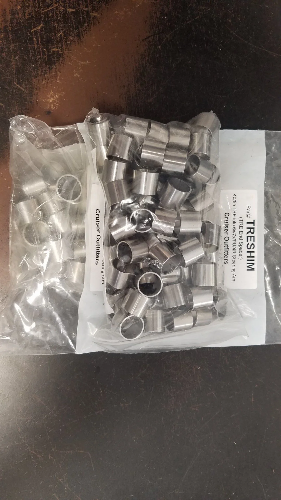

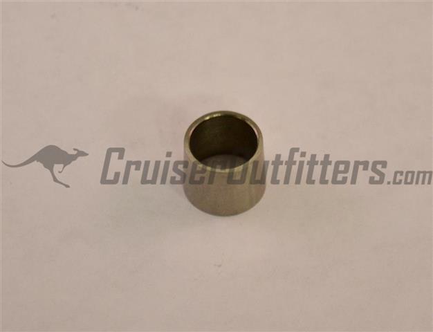

FWIW, I just received a couple pair of the tierod reducer bushings from CruiserOutfitters.com.
We've got a few bags full of them. We make them out of 17-4 Stainless Steel so they don't seize to the TRE end shaft. We've sold hundreds over the last 6-7 years with great results.
