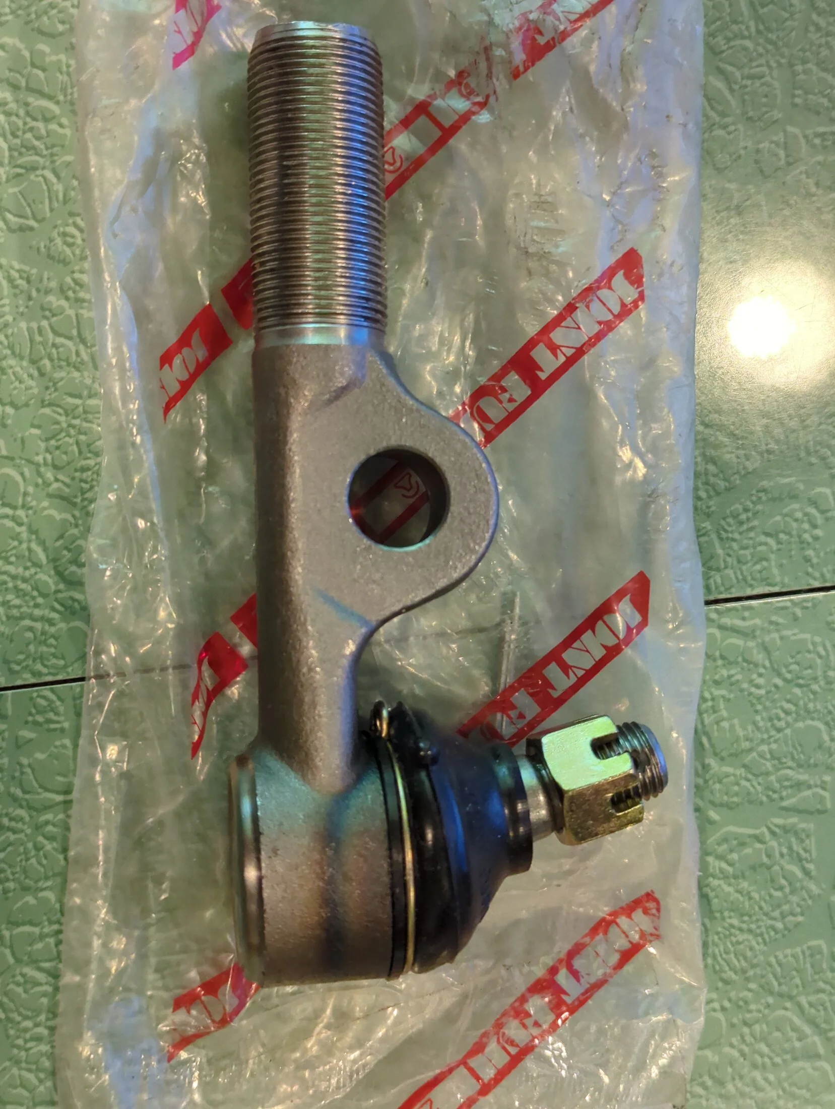

I have a (incomplete) set of Joint Fuji ends that I believe (are labeled) FJ60 ends (pic below). Those appeared to fit up into the steering arms when I did a quick test fit. They do screw into the BudBuilt TR properly.

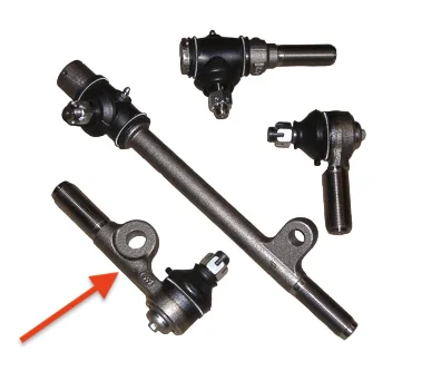

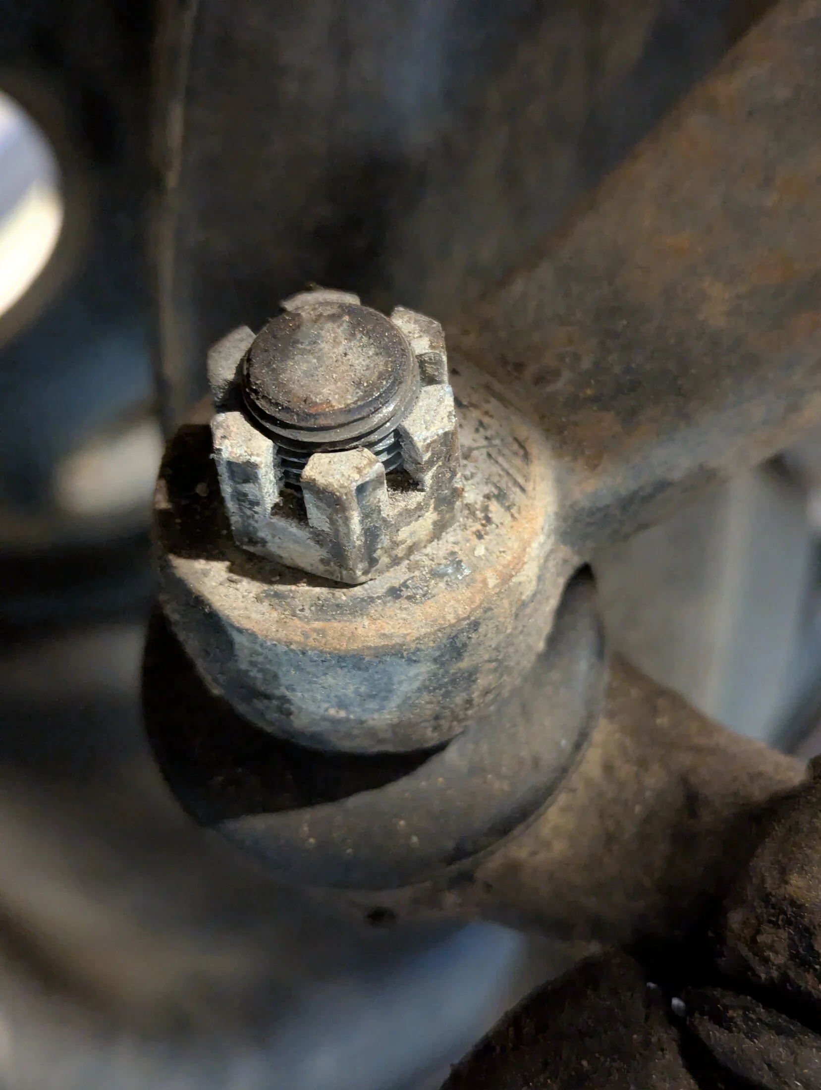

I have a new heavy duty "FJ40" tie rod from BudBuilt that I intend to swap on and keep my current one as a spare. I'd like to get new ends for the BB tie rod.
Is it that I just need to source (or find in my chaos) the arrowed part from the 60 set?

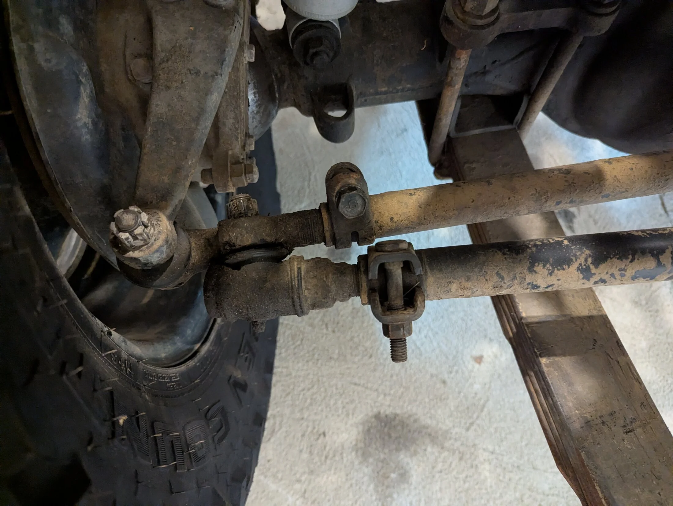

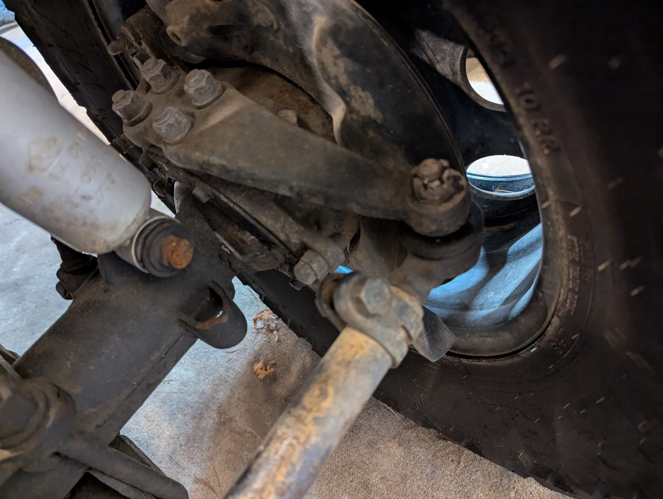

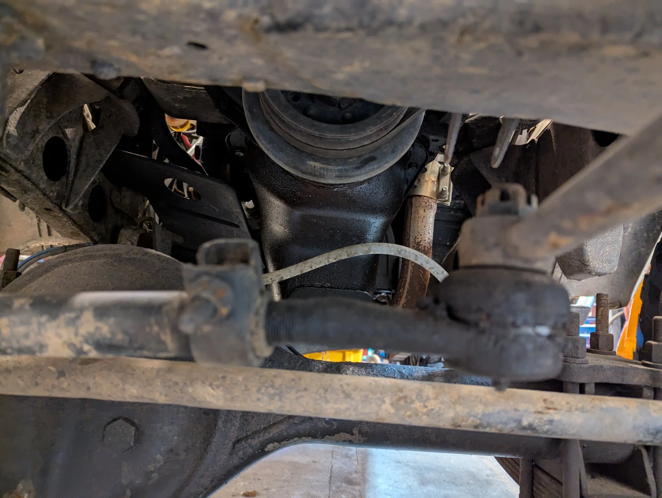

Shown is what is on the truck now.
This should do it.
From what you describe you'll probably need fj60 stuff.
