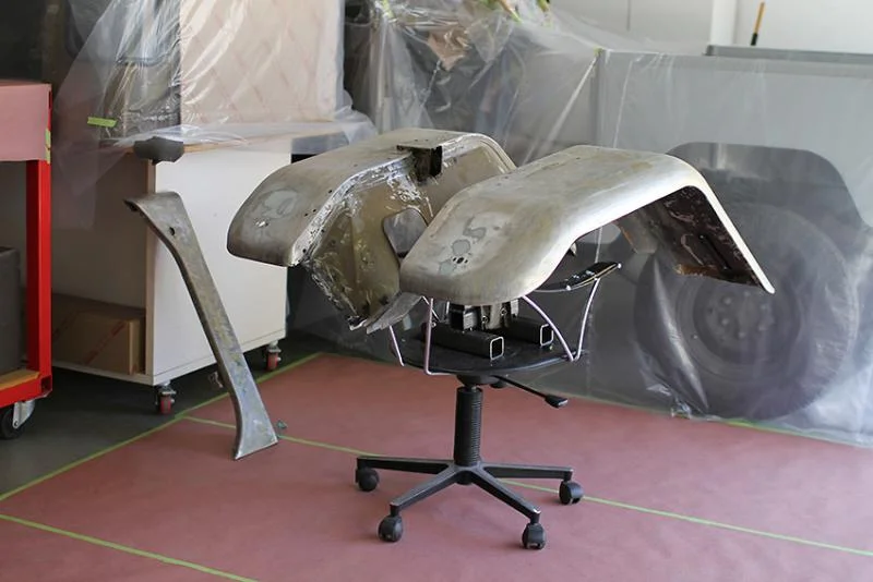

Got a little time in the garage. Need to finish up my fenders and get them sprayed with EP and maybe some finish color on the areas I won't be able to reach after they go back on. These guys are kind of a pain to move around when banging on so I rigged up a carousel with some 2x2 scrap tube and an old office chair. This will be a paint rack too :)

Yeah, he's back! Nice idea! I made something similar but not using a chair. It was helpful but I did find that having the inner skirts close together made painting a little tougher. It was hard for me to manuever the paint gun in that "V" and get an even spray pattern. If I remember correctly, I think you bought a smallish gun, so maybe not an issue using yours.
Good point (unfortunately :grinpimp:) - I may need to rethink a few steps. Was going to just EP and reassemble before final color but I'd like the engine-bay areas to have the stock color - may just touch up a few spots . . .

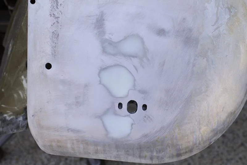

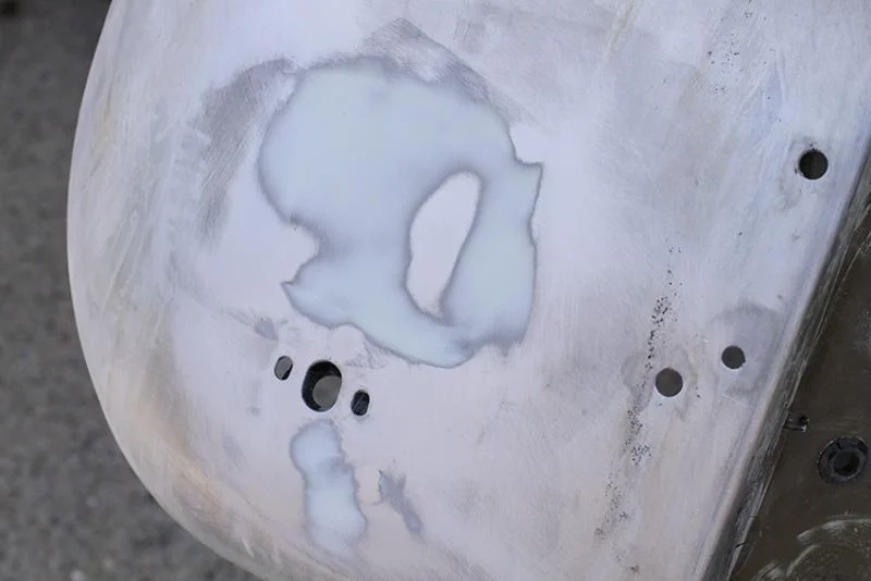

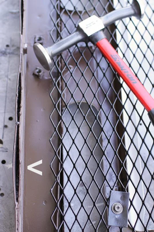

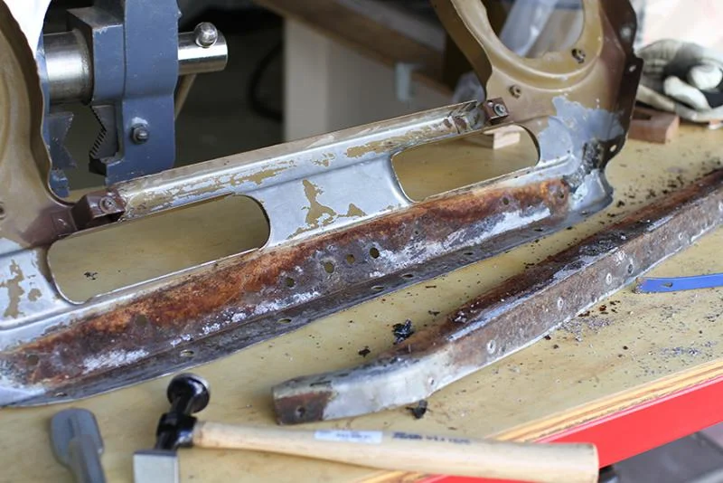

Turn signal bracket/mount areas - a little plastic but mostly steel :)
Bib area I cleaned up and rattled-canned when I got the truck. Probably a good time to try and fix the rust sandwich in the lower bib.

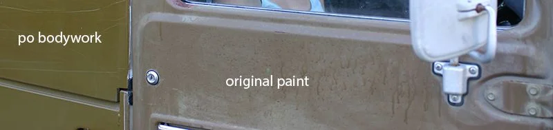

Anyone out there have solid info/formula for for 653 (olive brown) in a PPG paint product? I've been searching here for, but can't find, a thread that had a really nice restoration (653) and the guy was nice enough to supply color info. I'm going to take the paint guy a stock apron with good original paint I'm hoping he can match. Last thing I want is for everything to go too green (see 2nd photo). That original paint on the door in the second photo and the PO's repair on the rear can look close depending on the light but as the photo shows they're really way off.
I think the paint guy had mentioned Omni for a single stage which I think is made by PPG? I want something single-stage I can just touch-up when needed. Any opinions appreciated - thanks!

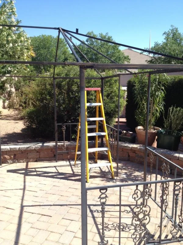

home made paint booth:
bought 2 gazebos on craigslist, the walmart kind with the metal frames. I suggest 12 x 12.
$50 and $60 from 2 different people. all nuts and bolts included. one of the kits came with instructions in 3 languages. Bought 2 because 12 x 12 was not big enough to paint the cruiser in there. UBolted them together $15.

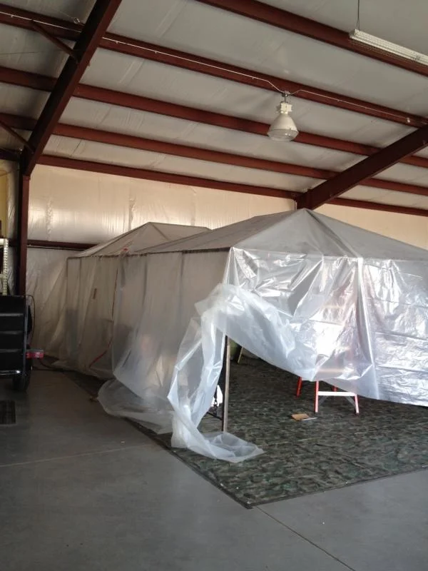

Plastic sheeting from Home Depot, the big pack, around $100. 20 feet by 100 feet, 4 mil i think. It's thicker than I expected and feels solid.
Huge tarp from harbor freight, 19 x 25 I think. $40. To cover the floor. Tarp taped down tight to avoid tripping on it.
Duck tape, more than I thought. gray stuff is fine, but the extra wide stuff (gorilla brand/home depot) is excellent. also at $15 a roll, I have it hidden from my sons.
fans, Lowe's, I bought 4 box fans @ $15/each. A/C filters for them were about $10.
We have the air, etc. at the shop, might spend some $$ on a couple decent spray guns from ebay or craigslist. Gas masks (is that what they're called?) from harbor freight.
Afraid to add up the $. We'll load black and cruiser gray on different days and maybe I'll invite the phoenix crowd over to get some stuff painted.

Just a staple gun, roll of plastic sheeting and paper taped to the floor. I try to get the garage as clean as possible first and use 3 to 4 medium size fans pushing air out the main, lowered garage door. Have two additional side windows which seem helpful for an air "feed source". I thought about putting together some sort of reusable frame but being the garage it's really easy/flexible to just staple plastic up everywhere, seal things off and just rip most of it back down when done. I only seal off about half the garage on the door side. The plastic I'm using (roll stuff by Sherman Williams) is great - not too light like the cheap drop cloths but not too heavy either. I can get you a few more details/pictures up at some point if that would be helpful.
I try to keep the air moving but nothing is filtered of course. Not perfect but for laying down small amounts of EP and working small spot areas, which is all I'm trying to do right now it seems fine. I don't like the idea of a big plastic air-tight balloon of paint spray ready to blow. Oh - and I always kill the hot water header, turn off all gas, etc.
