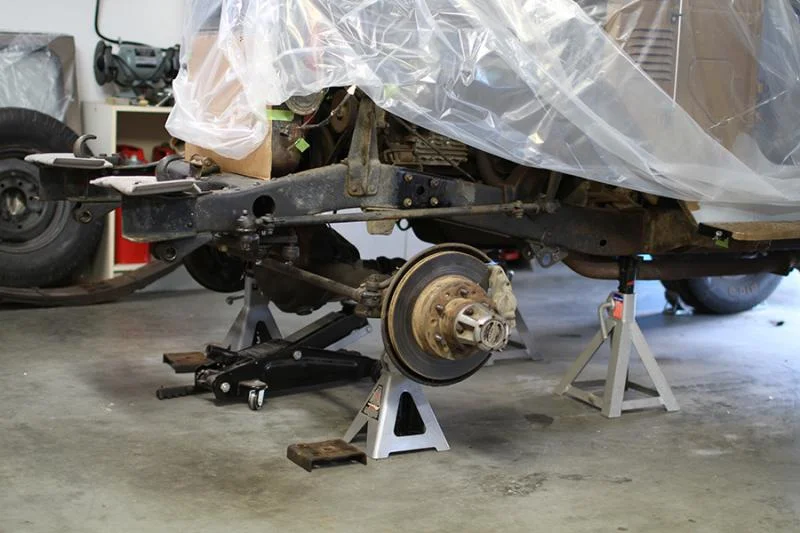

After spending a good amount of time stressing the suspension issue - I've decided to go ahead and replace everything with an OME complete kit. Ordered the "light" kit from Cruiser Outfitters and Kurt says everything should arrive on Friday.

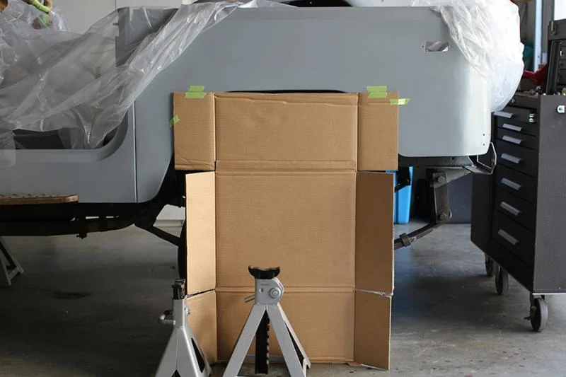

Will be great to pull all that old PO miss-matched stuff off. I put together a high tech height gage to check out before/after. Any advice, things to watch for, etc. appreciated - never done this before.

With the new lift and if you go with 33's you should make sure your bump stops are such that you don't get into all that nice sheet metal work you've done. ;) It would only be a problem in the front (might rub the inner fender well on the rear at full flex, but not enough to hurt anything except maybe rub some paint off), and if you leave the axles as they are (no spring 180) you might not even have an issue at all, even in the front.

iphone photo - please excuse the quality.

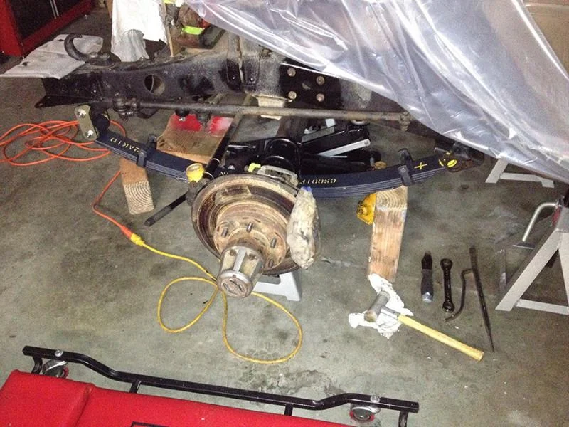

Trying to work that 1st spring into place. I thought it was hard to remove the old stuff and easier to install the new - not my experience so far . . . :)
I the plus (+) always goes on the driver's side? Each front spring has a plus. For the rear springs I have a plus and a minus.
The longer end of the spring (distance to center pin) is always on the shackle - the short end goes to the static pin?
The bushings don't get grease on the OD - press fit area?
I expected those weird "triangle-type" shackles from OME - instead I got something more simple looking (which I like)? Have they changed the design?
