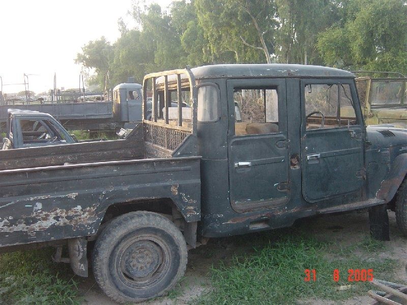

If I had know you were changing direction with your build and just doing a 4 door 45 you could have just bought this... It's in a junk yard near ya :)
Some place near Islamabad ... Ehsan Kiani knows where it is ... He took this picture... If its still there that is
This place is actually just a half hour away from where I live, and I'm there on most weekends, like clockwork. :)
Sadly, though, there's been no double-door 40 there for ages...
