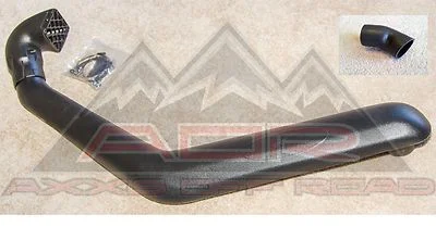

So I pulled the trigger and bought one this week. Purchased on eBay from seller motorbone2012, price was $165.80 shipped. My snorkel was shipped within 24 hours via Fedex Ground Home. Since they are located in CA it arrived at my doorstep in 3 days. Clicked purchase on Monday, arrived on my doorstep Friday. So far zero complaints.
Out of the box, I have to say I'm more than surprised. The plastic mold seems are rough on the snorkel head, but fairly smooth on the snorkel itself. I really don't care, as long as it's sealed I'm happy. My truck looks 100x worse than this brand new snorkel. The bolt inserts looked to be SS and are nice quality well molded into the plastic. I can't see these failing without some serious user error. The overall quality and craftsmanship on the snorkel overall is excellent, especially considering the price paid. Still zero complaints.
On the back of the main snorkel body there is a web URL molded into the plastic.
www.rv4x4.net
That site doesn't load for me currently, but Google search has a description of "Telawei 4x4 Off-Road Accessories Factory". Further Google search turns up an ad on Alibaba showing the LC 100 snorkels along with many other models and random 4x4 accessories. Almost all of them are mirror copies of ARB products, right down to the identical tow/snatch straps.

Yes, we do have 100's & FJ Cruiser snorkels as well. I can post pics on Monday if anyone is interested?? We have a lot more stuff for 80's 100's & FJ's that I don't have on the internet yet. Roof racks, ladders, tailight guards, JDM style swing aways, JDM style fender mirrors etc.
