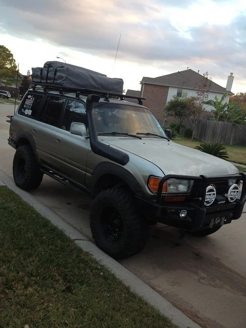

The snorkel does obstruct the antenna by a few millimeters. You can hot form into the snorkel and Make room, or get creative and cap the antenna opening. We have two 80's series left and two 100 series if you were considering one of ours. I'll post up some pics later today.
Sorry Anthony, I was on my phone earlier when I answered Dragon, didn't see he was asking you. I have enclosed some pics of our 80 & 100 series mounted if it helps anyone:cheers:

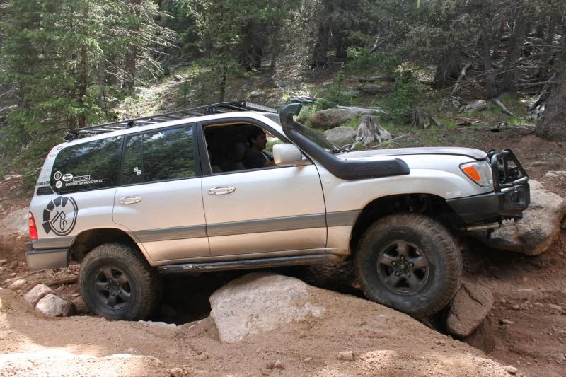

No issues the plastic fading, cracking, or bleaching. The only rust is on the screws that secure the snorkel intake grate on. The plastic is not as hard as the Safari, I will admit. Every Safari I see has no scratches. Mine has huge scratches all over. I can't tell if the plastic is soft, or the branches I drive into are on steroids.
Here is the best picture I could find.

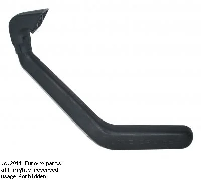

This one looks like the older Safari design and doesn't appear (in the pic anyway) to have any logo or wording on it. $100 shipped too.
Here's the Newer Style that has the longer "arm" running down the fender. $139 shipped. The pic in the listing also doesn't show "LAND CRUISER" down the side like the earlier ones in this thread.

Two year update for me, zero fading or cracking. The only thing I've touched is the two black screws includes to secure the plastic guard on the intake started rusting as the black finish wore off. I replaced them with stainless steel screws for $.25 and it's been perfect since. Zero other issues. Very happy with the purchase and modification.
Recent picture, scratched and dirty but holding up well.
