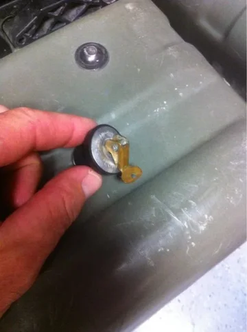

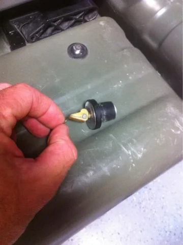

Ok so I just looked in my air box cause I drove in the rain earlier today and I didn't see any water. I did see very small water spots, but that could be from before installing the pre-cleaner. I'm thinking if I were to put a drain plug in for peace of mind then I would go with something like this:
You could put a small hole at the inside bottom of the air box and have the plug loose in there and blammo a river...stop, pop the hood and air box...in goes the plug as well as you across the river. Hmmmm...I think I just convinced my self. :D It rains like clock work in Honduras seemingly every evening and I hope to be crossing rivers regularly so I can scale sweet mountains, so I guess if that becomes the case I could just leave the plug in. ;)
