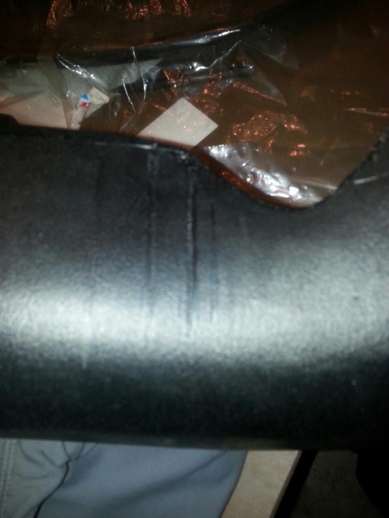

I ended up going with jdm-motorparts on ebay and it did not come with the landcruiser markings It also came with deep gouges in the main area you can see. Not real happy with it so we will see what he says.
Parting lines look horrible.

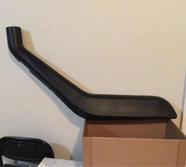

Have you installed this yet? I ordered mine from the same seller, but they sent the wrong one. I ordered the smaller one (pic attached) but they sent me one like yours. They have told me that the one sent will fit a 100 series-and I am ok with either style. After looking close, this is definitely different than the OP's Safari "lookalike" but the same as the one you ordered.
Did it fit correctly?

The long one like pictured in the last photo is the one I got and it fit fine.
So does yours have gouges in it where it makes the bend ? like in my first photos ?
The one I got looks the same as the OP's other than not having Land Cruiser on it.
Did it fit correctly?View attachment 1006529View attachment 1006530

The one I got looks just like the OP's just not with Land Cruiser on it.
So does the one you got have gouges where it makes the bend like my first one did
I installed mine today, and upon a closer look it is very similar to yours, minus the raised lettering. It only took about 3.5 hours with minimal issues. It didn't have the same damage as ScubaJon's, but it wasn't perfect. I didn't have to do any modifications for the antenna, which was nice. Good for the price, IMO.
