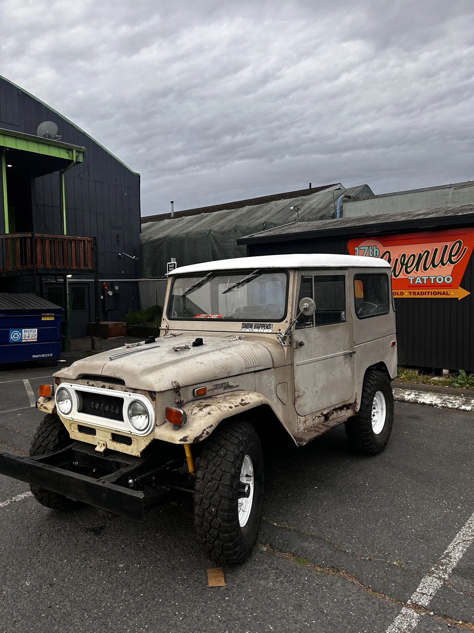

Finally got my exhaust done for my 40 - was the last piece of the puzzle. Went to drive it home, steam in my face. It seems to be coming from the tubes the heater box should connect to - id taken it out to help with wiring, lost it, and never put it back in. It never did that when there was no exhaust on it, my guess is the back pressure made the heater tubes actually work? I'm guessing that hot steam is how its supposed to work, just supposed to go into the heater?
Except now it wont start. So maybe i broke something. It cranks just fine, sometimes makes noises like it's firing a couple times, but wont hold it.
Any ideas? Did i break it? Thanks y'all.

Steam coming out heater tubes indicates no water in the system . Did you drain the radiator and refill it by chance ? I’ve seen more than one cruiser over heat because the system wasn’t burped to get the air out.
Im guessing this is it - just replaced it with a new radiator. Filled it with coolant but thats it, didnt "burp" it.

Sorry if I'm misunderstanding, but from your description it sounds like you removed the "heater box" and just left the hoses hanging there? Like, not connected to anything?
If so, that's *no bueno*. Those hoses are supposed to be full of coolant - not steam. Steam is one thing you don't want in your cooling system. It's a closed, pressurized system that should definitely not have any open hoses - especially in your cab. That's a recipe for a serious burn - as you almost found out!
Anyway, it's almost impossible to diagnose your no-start condition without a lot more information. As mentioned, there are tests you can do to verify that you have fuel and spark. But before you do anything, get your cooling system sorted. If you can't find your heater box, at least find a way to connect the two heater hoses that used to connect to it, and close that loop. Your auto parts store might have something of the correct diameter.
