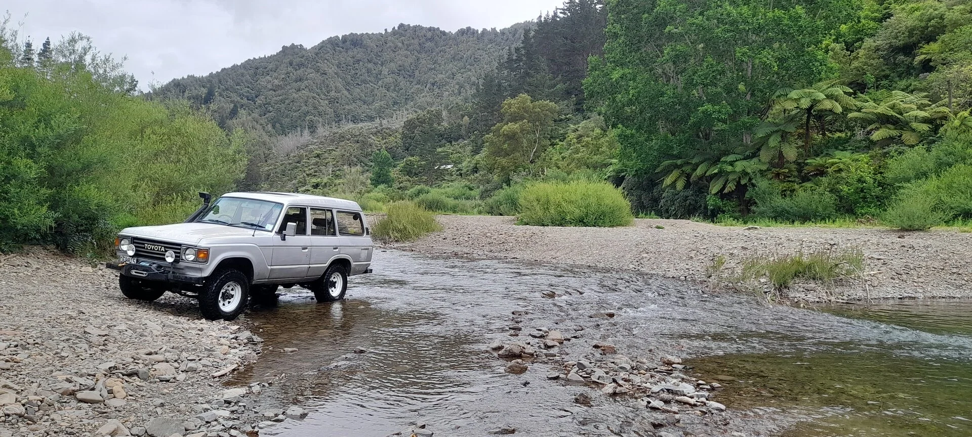

Hi team,
this afternoon I explored one of our local backcountry valleys - of course there is a stream in it and the track crosses it many times. I would not call it fording , today it was up to the hubs at the deeper parts.
Enough to give the underbody a wash and definitely totally wet all the brakes. This is about 1.5 hours return of constant in and out of the stream...
So far so good - done that many times.
But why are my brakes so badly affected by this even when (I think) all the water has dried off - after half an hour driving on the highway ...including brakes being used on downhill streches of the road ?
Before - and I know well that the 60s brakes are average at best - they were actually really good, they had that 'biting'
feel of expotential rising brake force with only a bit increase of pedal pressure.
Now it is all gone...the pedal is rather soft - they also seem to fade heavily. Ok, the enclosed rear brakes will need longer to dry - and they would have also accumulated brake dust which could turn into a lubricating grime - but the front brakes should dry fairly fast and should anyway be responsible for about 70-80 % of the brake force anyway.
By the way - the stream water is cristal clear... It will be fine after an hour or two of highway driving...but why so long ?
Maybe my brake pads and shoes friction material is too cheap and acts like a sponge and lubricates the brakes ?
The picture is from todays trip - but as I was alone and didn't want to get my feet wet - I choosed not to park it in the deepest parts.
What are your experiences ?
