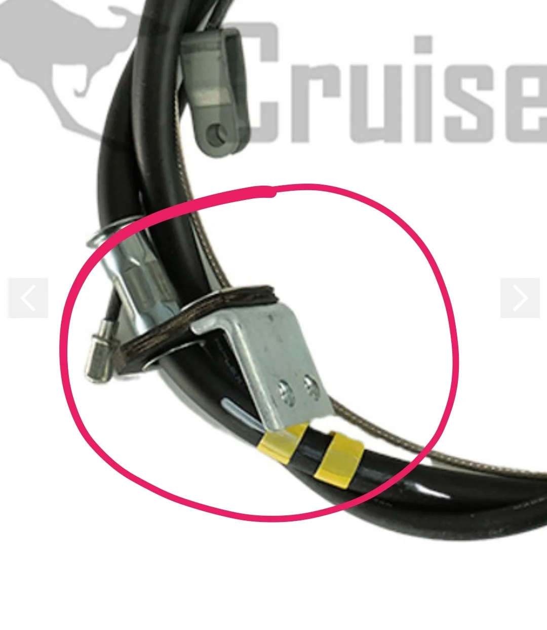

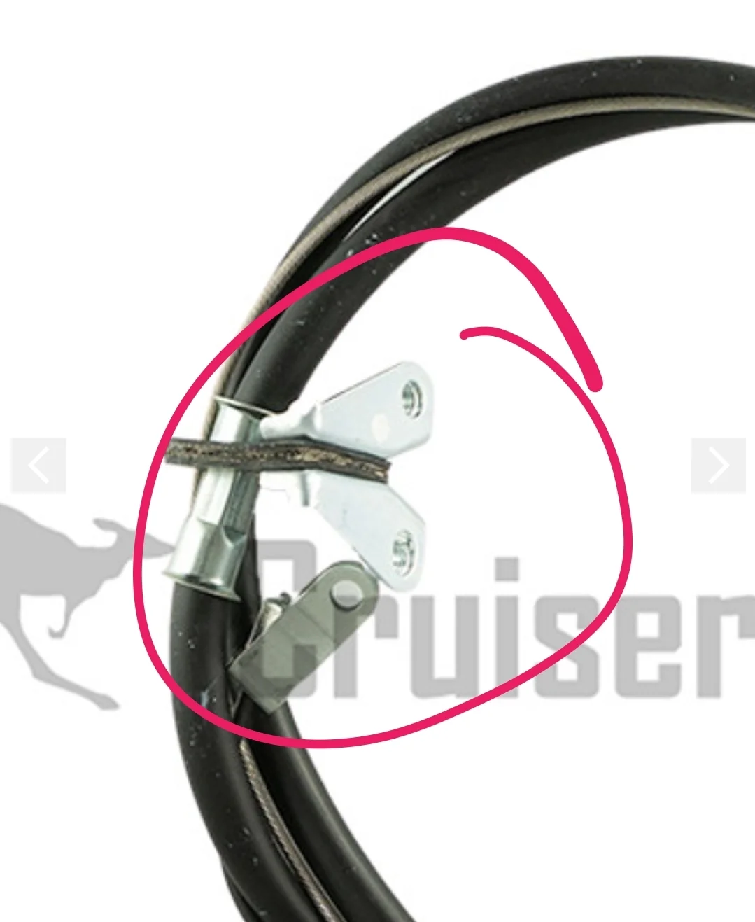

The difference is the mounting tabs on the rear axle.
All versions of 60 cables are available from Toyota so they are all equally easy to acquire.
There are two different mounting variants on the rear axle housing itself.

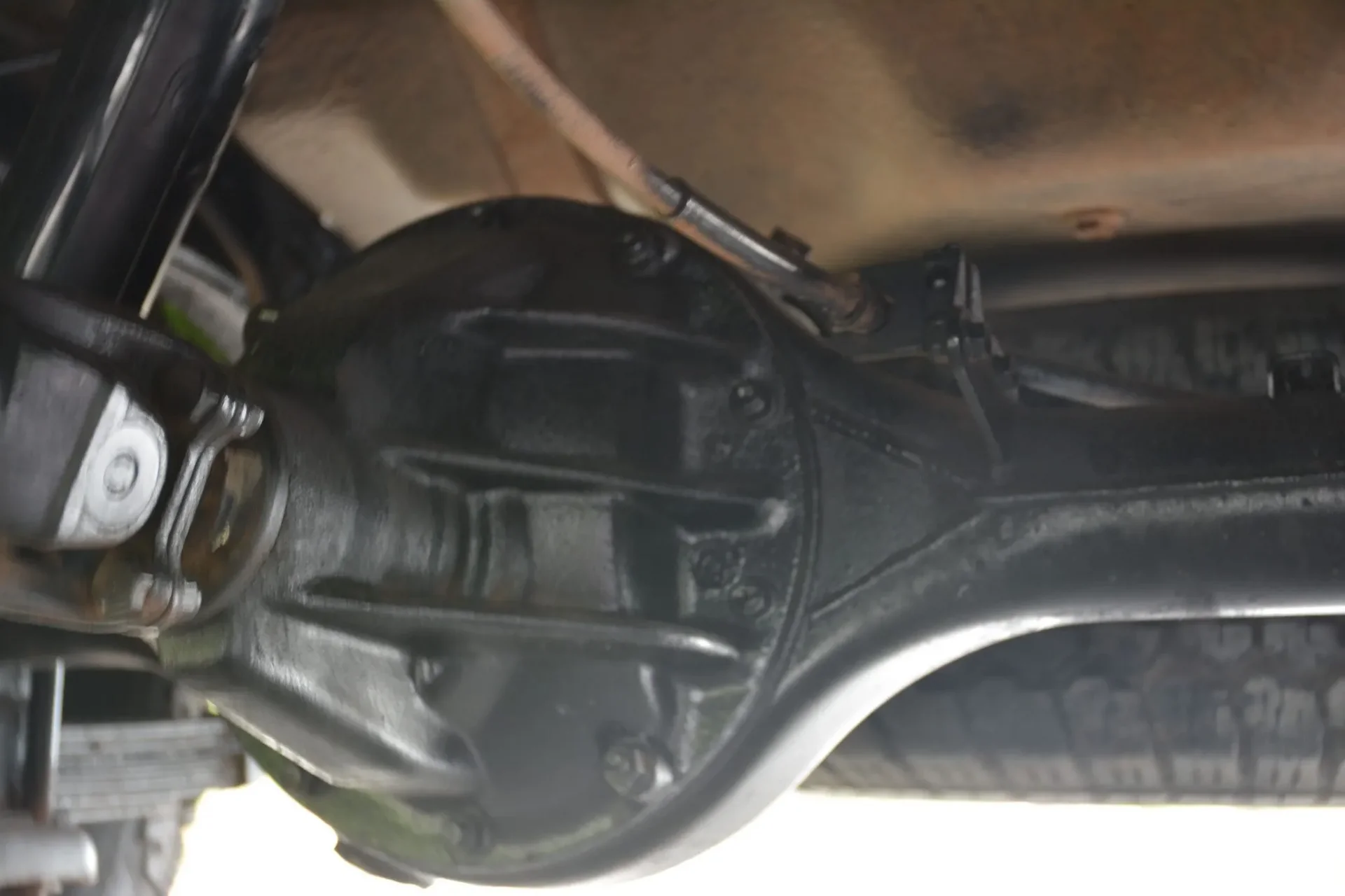

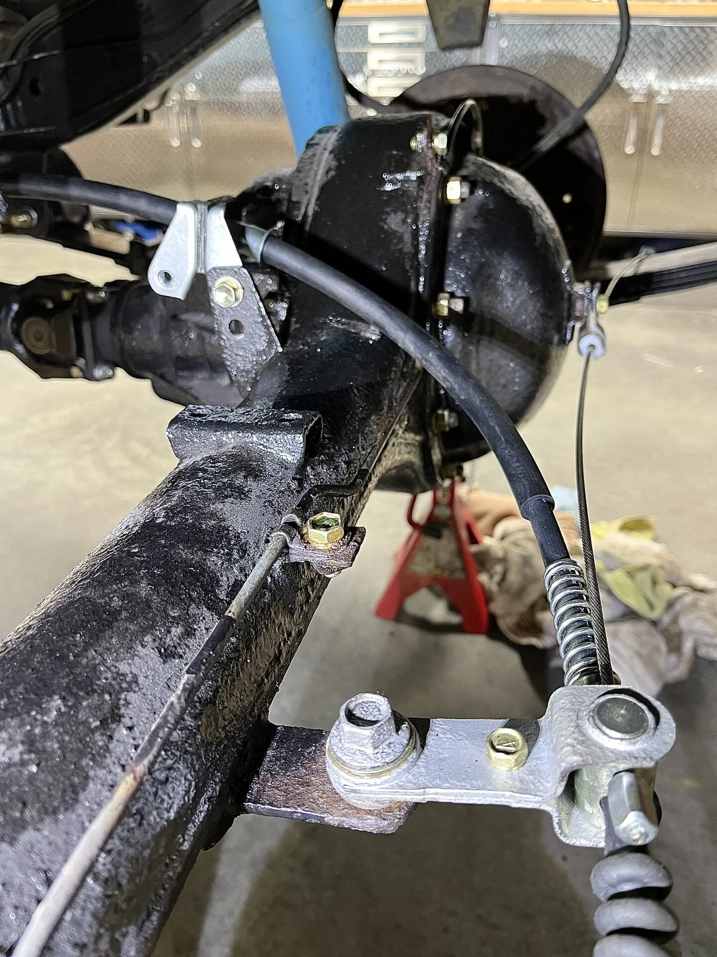

Early:
Late:
@cruiseroutfit Thanks for pictures. I have the late cable for sure. I guess I'll be stopping by to pick a new cable up :)
Sounds great! 😎

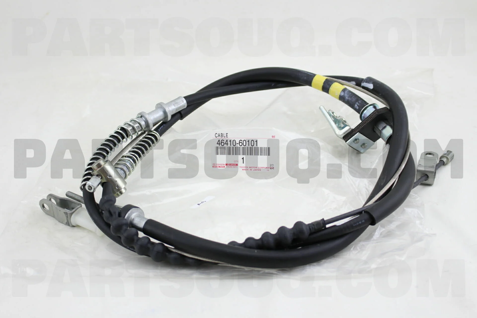

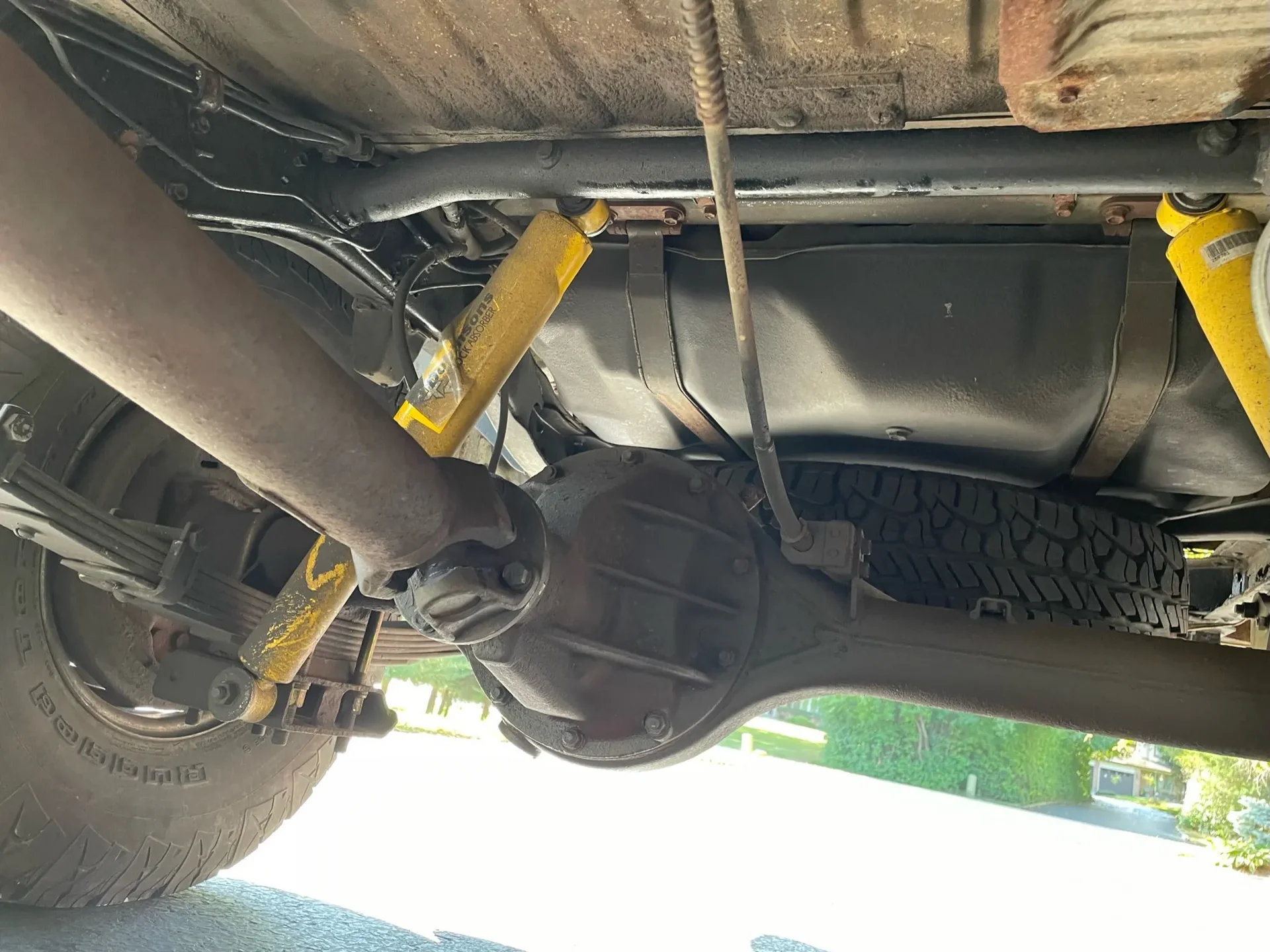

@cruiseroutfit Kurt, maybe you can solve this mystery and suggest a solution. I bought the early cable with the moth-like axle mount for my '83 60. Part number 46410-60100. The later cable, 46410-60101, has the square axle mount (like your link above) which is what I weirdly have on my original 1983 axle. The early-model, moth-mount can be fastened with one bolt to the same spot on the axle, and since it's really only holding up the cable, should be adequate. But it's kind of bugging me that it's not factory perfect. Getting the new cable out again is a royal pain with that one-way clip at the hand lever. So do I keep this set up or buy the later (square-mount) cable for my early truck?
I'd probably build a small "L-bracket" to make it mount with two bolts and not worry about it until you need to replace the next time

The only one I could find with the early style was this '82 ('81 build date) on BAT. No Reserve: 1982 Toyota Land Cruiser FJ60 - https://bringatrailer.com/listing/1982-toyota-land-cruiser-fj60-28/

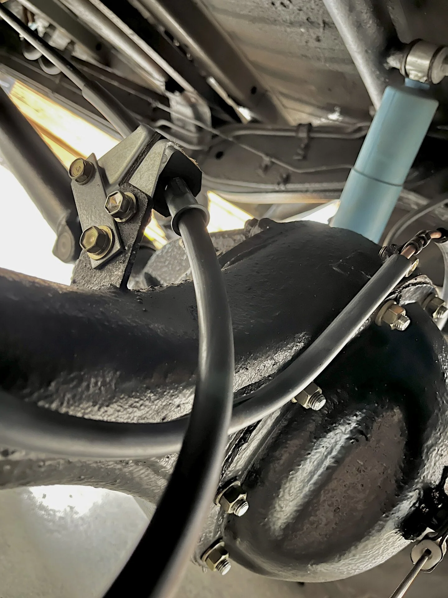

Compare to later style cable with L bracket and bolt pattern perpendicular to cable (old style has bolt pattern parallel to cable).
Image taken from 1984 listing: 1984 Toyota Land Cruiser FJ60 4-Speed - https://bringatrailer.com/listing/1984-toyota-land-cruiser-fj60-110/

When I replaced the suspension on my previous 60 - it was an 83 model with a build date in very early 83 I think - I ran into some goofy stuff with it having some features of a later "84+" axle. It was such that I started thinking somebody had maybe swapper the rear axle out. Perhaps the rear axle tweaks weren't 84+ but actually 83+.
I'm just adding wild speculation to the fire Ian.
Good info, Ian, and I think you are right, Jim, it may have been 83+. I also thought maybe my axle had been swapped but there is no way. Probably has more to do with model year changes and the assembly line getting parts for the coming year change. I just made a bracket for mine in the end, keeping the later bracket on my early truck.
Yep so that's 7 datapoints. Haven't seen a single 84 with the early parking cable as described by the interchange. So I'm thinking the interchange is wrong because what are the chances we all had swapped axles? My brown 84 was with the same owners since 88 and they said they only ever changed fluids on it.
