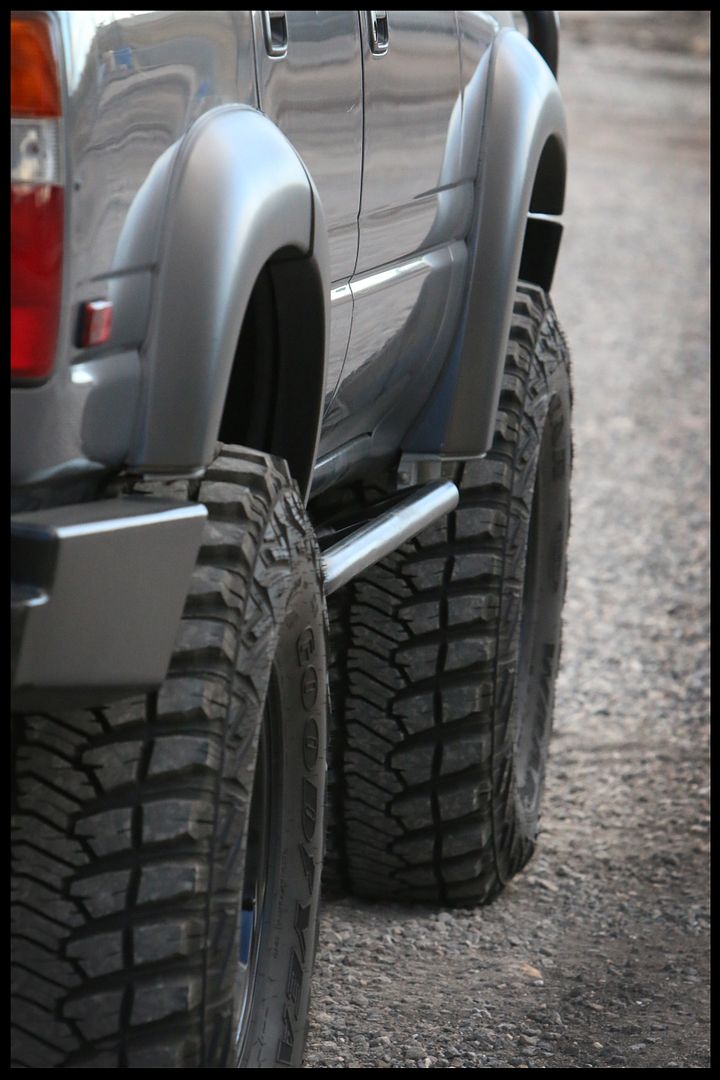

Finished up the sliders over the weekend. Not many people use the Trail Gear sliders, but I ran a set on my old '93 for years and was very impressed with them and how well they've held up. As will any slider, proper gussets at the frame are key to keep them from flexing. There is some fabrication involved with the Trail Gear sliders since they are made for Tacomas. The sliders ship with the main slider fully built but with the legs un attached so that you can set the angle of the slider where you want it. The forward leg that is supplied is too short so that what you need to handle on your own. I used some 1.5" 0.25" wall square tube for that front leg. It's crazy beefy but since it's a longer leg it helps to have heavier material. I made some big gussets from 0.5" plate. The sliders are welded to the frame using some 3/16" scab plates on the frame with the slider/gussets welded to the frame plates. On the passenger side I needed to bend the forward leg to pass under the cats. All in all I think they turned out nice and for the cost, they are the best bang for the buck sliders out there for the 80 IMO even with the extra work involved. Hard to go wrong for roughly $200. You'll want the 67" versions.

I don't have a good photo of the new sliders at the moment but here's one of the same kind of sliders used on my old '93. I welded frame plates to the frame and then welded the legs to the plates and put gussets on top. It's also necessary to notch the rocker panel pinch weld for the legs and even then then legs will weld on almost flush with the lower edge of the frame.
On my '93 I lined up the legs with the spreaders in the sliders. I think on my new ones I spaced the front and back legs out a little more to the ends. Not much difference but a little. On the passenger side you'll need to bend a new leg to pass under the cats If you have the dual front to back cats like mine, I made that leg pass right between the two cats to keep as much clearance as possible.
Curious as well to see your passenger side mounting, and did you do three supports or add a fourth?
The passenger side is essentially just like what you see in the above photo. Just three legs. The front one needs to be bent to pass under the cats and I located mine so it goes between the two cats. The small heat shield that hangs just below the rocker panel also needs to be clearance a little for that leg.
This shows what I did a little better. I have a small angle-iron "skid" under the cats. Right now it's just welded to the forward leg and is working fine for now but I'll be adding tie-ins for the skid at the front and back of it to make it more sturdy.
