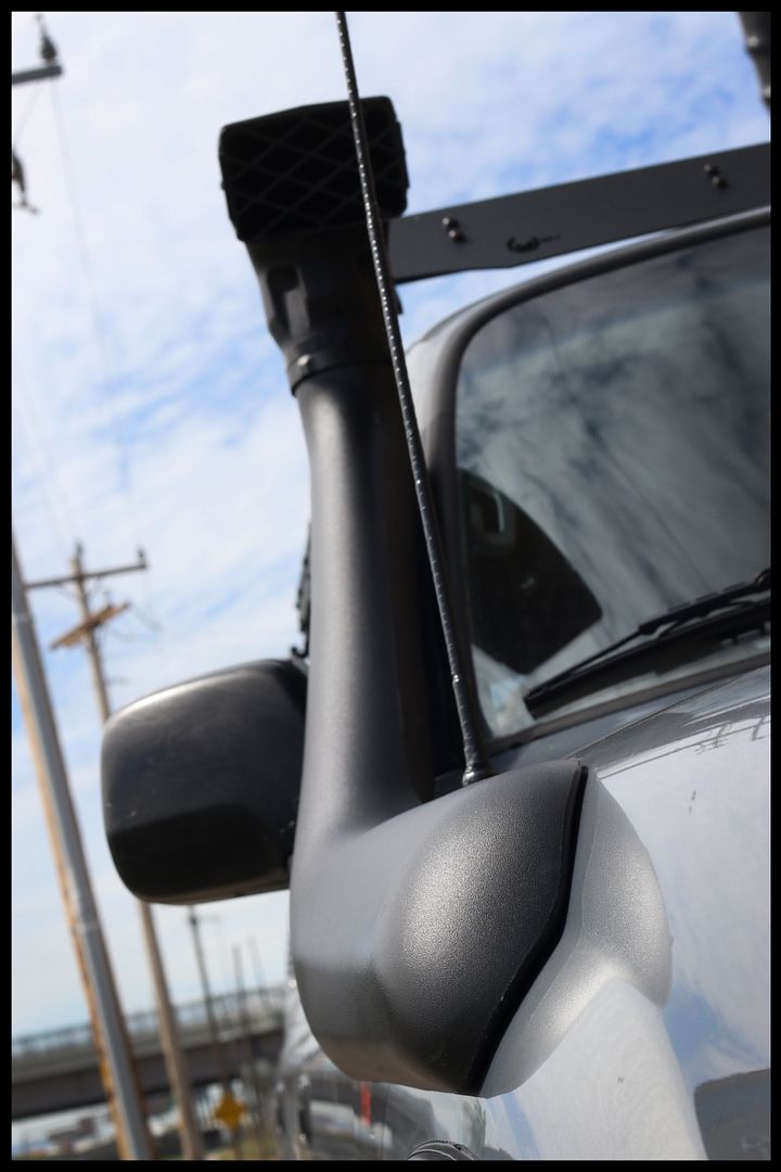

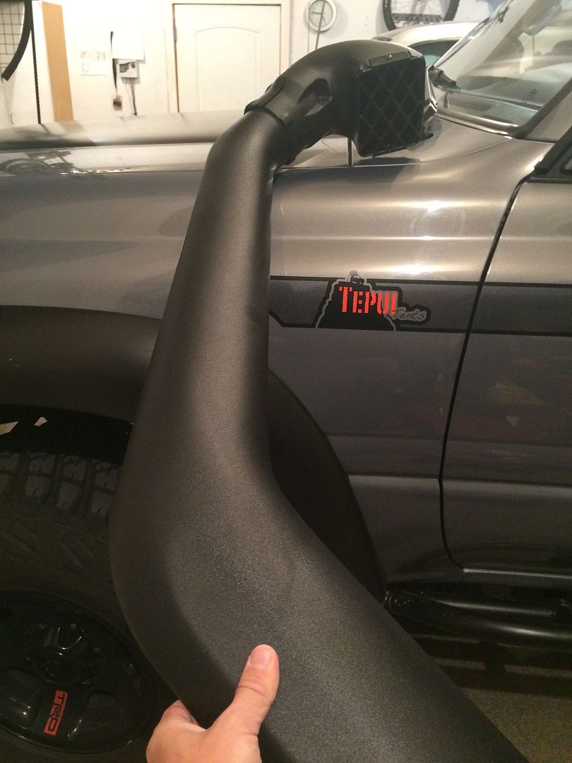

Ordered a TMS snorkel today on Amazon. It's a Safari knockoff.....yeah I know, you get what you pay for. I have had a few safari snorkels in the past and the quality is great. We'll see how this one compares. For the cost, I won't be too hurt if it doesn't stack up. But if it's decent, I'm sure it will do the trick. I'll occasionally venture into deep water but I like the snorkel more for the help in the dust on the local trails as well as to reduce my intake temps which can get pretty toasty in the summer time.
TMS Snorkel showed up this morning. Initial inspection looks really good. I see very little difference between this TMS snorkel and the Safari ones I've had in the past. Obviously it doesn't have "Safari Snorkels" embossed in the body so it's a smooth exterior but the plastic is thick and looks to be well formed with no flaws that I could find. I haven't had time to install it yet or check the template for accuracy so I can't report on fitment quality yet. But for now it seems like $40 well spent. :)
I finished up the TMS snorkel install last night. Overall pretty smooth. The supplied template wasn't quite accurate. The two holes closest to the windshield were not in the correct place but that was about all I needed to change. After drilling the holes, I removed the fender to make it easier to tighten all the bolts and remove the factory intake plumbing. The quality of the snorkel is really quite good, in fact excellent considering the price. For a $40 Snorkel it is great. Comparing it to the Safari snorkels I've used in the past, the obvious difference is the lack of the embossed Safari logo on the main body. Fitment is and construction is good although it may not be quite as precise where the snorkel follows the contours of the fender at the front, but I'm getting quite nit-picky. Material seems to be the same plastics. Time will tell if this one has problems with UV exposure and fading or cracking, but I doubt it. So with the exception of needing to do some double-checking of measurements I'm very please with the purchase.

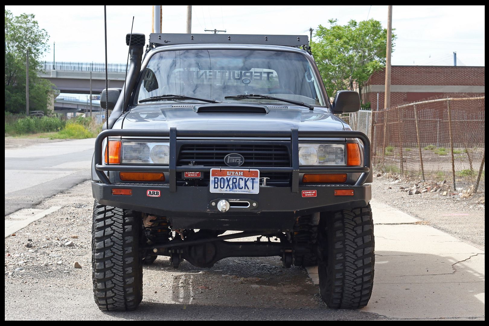

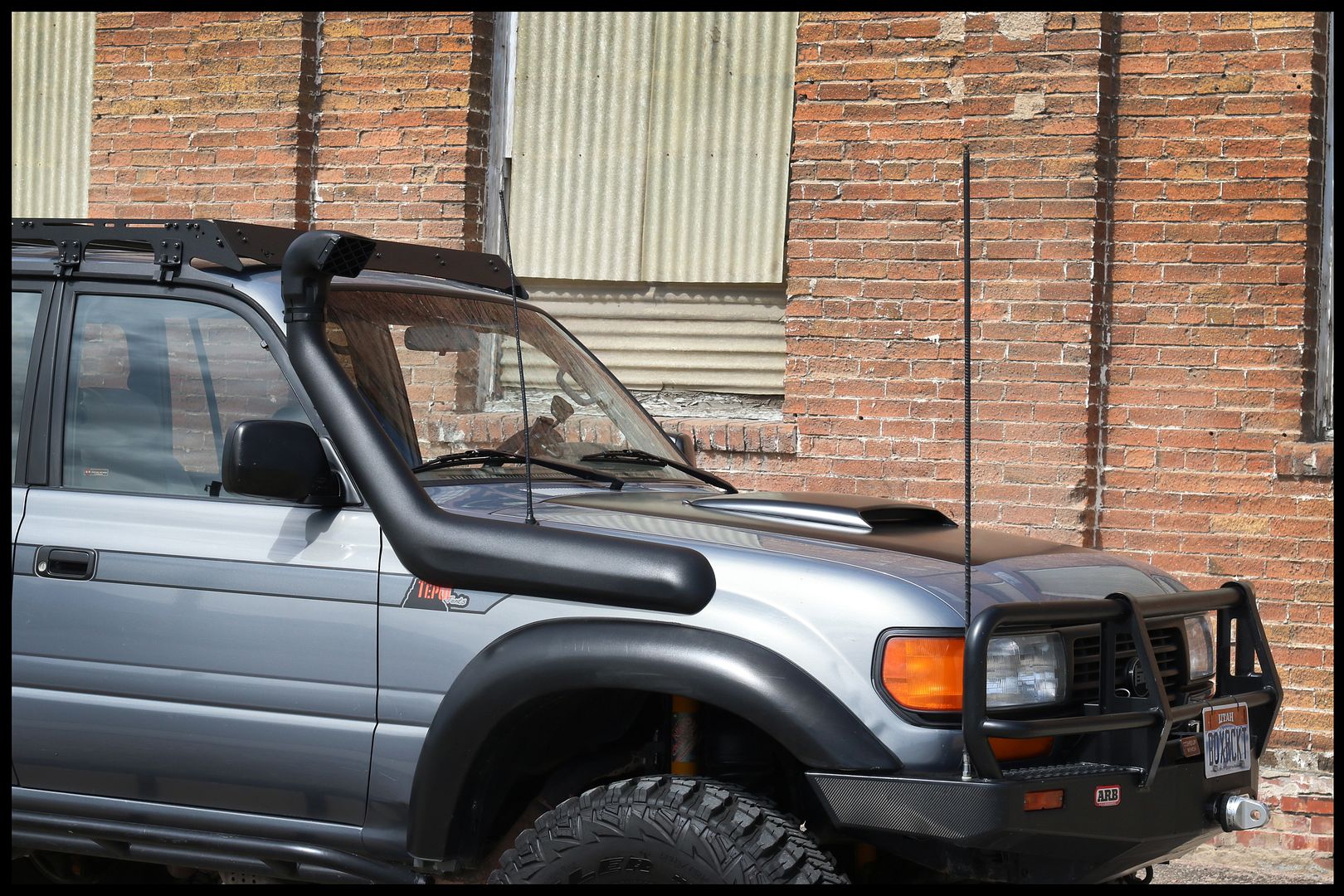

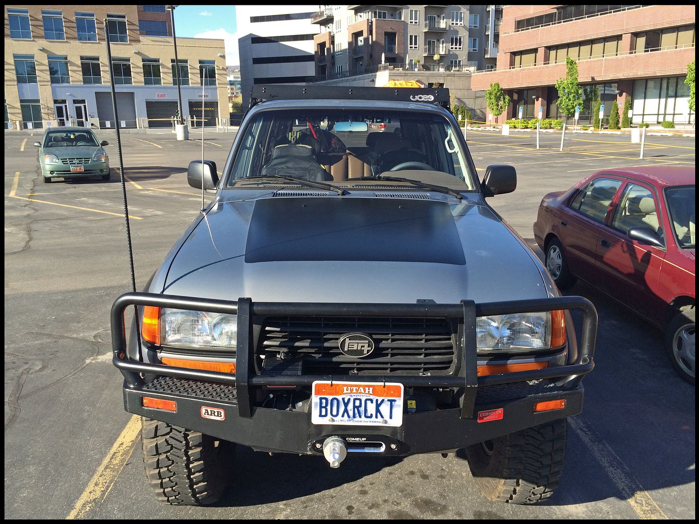

lastly. I've been going back and forth about keeping the hood scoop. I put it on just to help cover up the peeling clearcoat (and I don't mind the look) but I'm not sure how much I like it and I'm thinking of taking it back off. What say you?
Keep it or lose it?
with it:
without it:
I like it! Keep it!
Weld in a 78 series hump. There's quite a few 80's in Australia who have done it, me included. But I guess you don't have 78's in USA :-)
View attachment 1097492 Weld in a 78 series hump. There's quite a few 80's in Australia who have done it, me included. But I guess you don't have 78's in USA :)
yes I would do that if I could source a 78 series hood without it using up my retirement fund. Sadly, too hard to find one in the US and far to costly an option to get one otherwise. But I agree with you, it is by far the best looking and cleanest option if done well (like yours).
