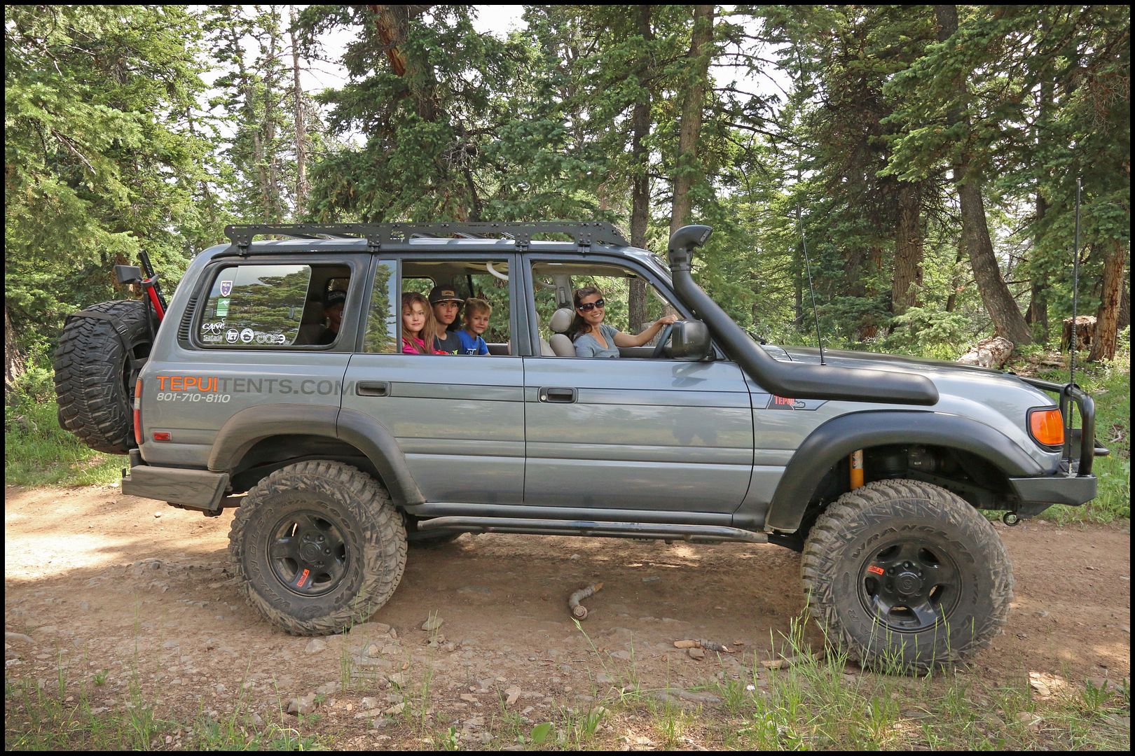

Hey Box Rocket what springs are you running. Looks good. Do you ever load it heavy enough to level it out?

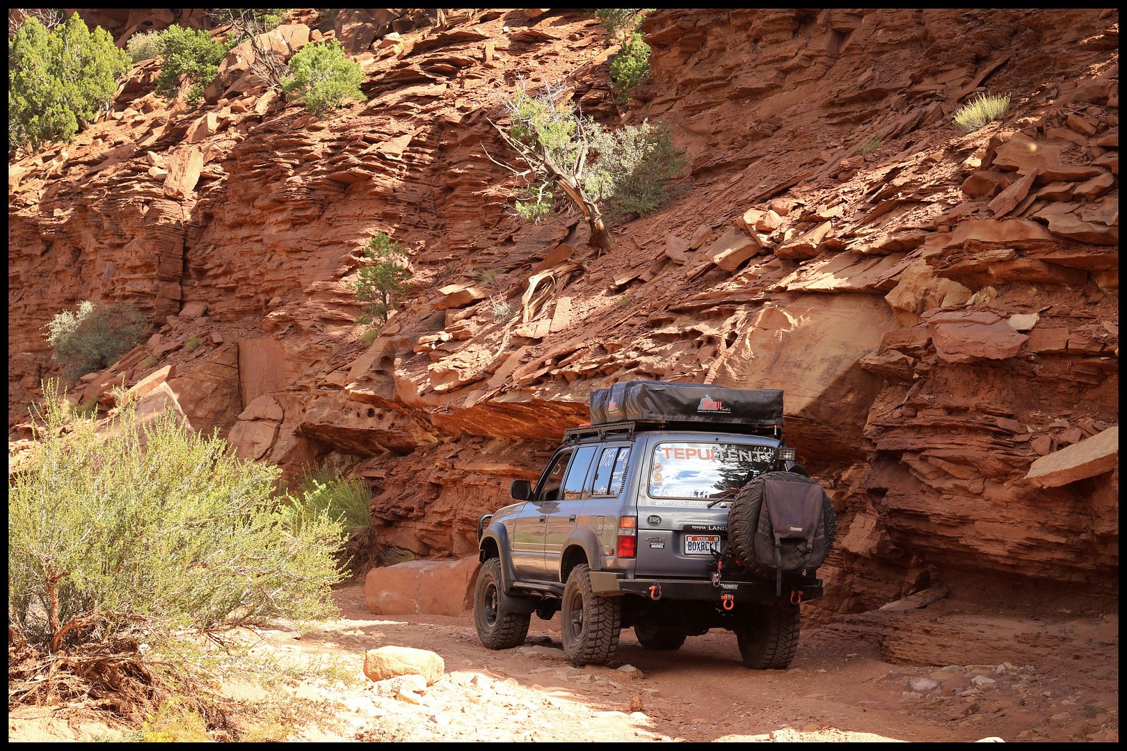

It sits almost level when it's unloaded. But yes I carry plenty of weight when I have my whole family (6 of us) plus gear, plus the RTT and pulling the trailer. Here's a shot with no gear or people in the truck and no RTT on the cruiser but pulling an empty trailer with RTT.
I'm running OME J springs with 1.5" coil spacers.
It sits similar to mine. I started off a year ago with J's up front and 863's rear for a pretty level stance but decided I want more so for a cheap experiment I bought Slee 1" poly spacers. The rear spacer is more like 1 3/16. I sit a little more stinkbug than you unloaded. I figure this will allow me more height while testing the J spring rate for a season before I pull the trigger on taller rear springs to get rid of the spacer. Based on the loads you carry, the J's should be enough for me and of course the MT spacer in front. Thanks for the info. Super nice looking 80 too btw.

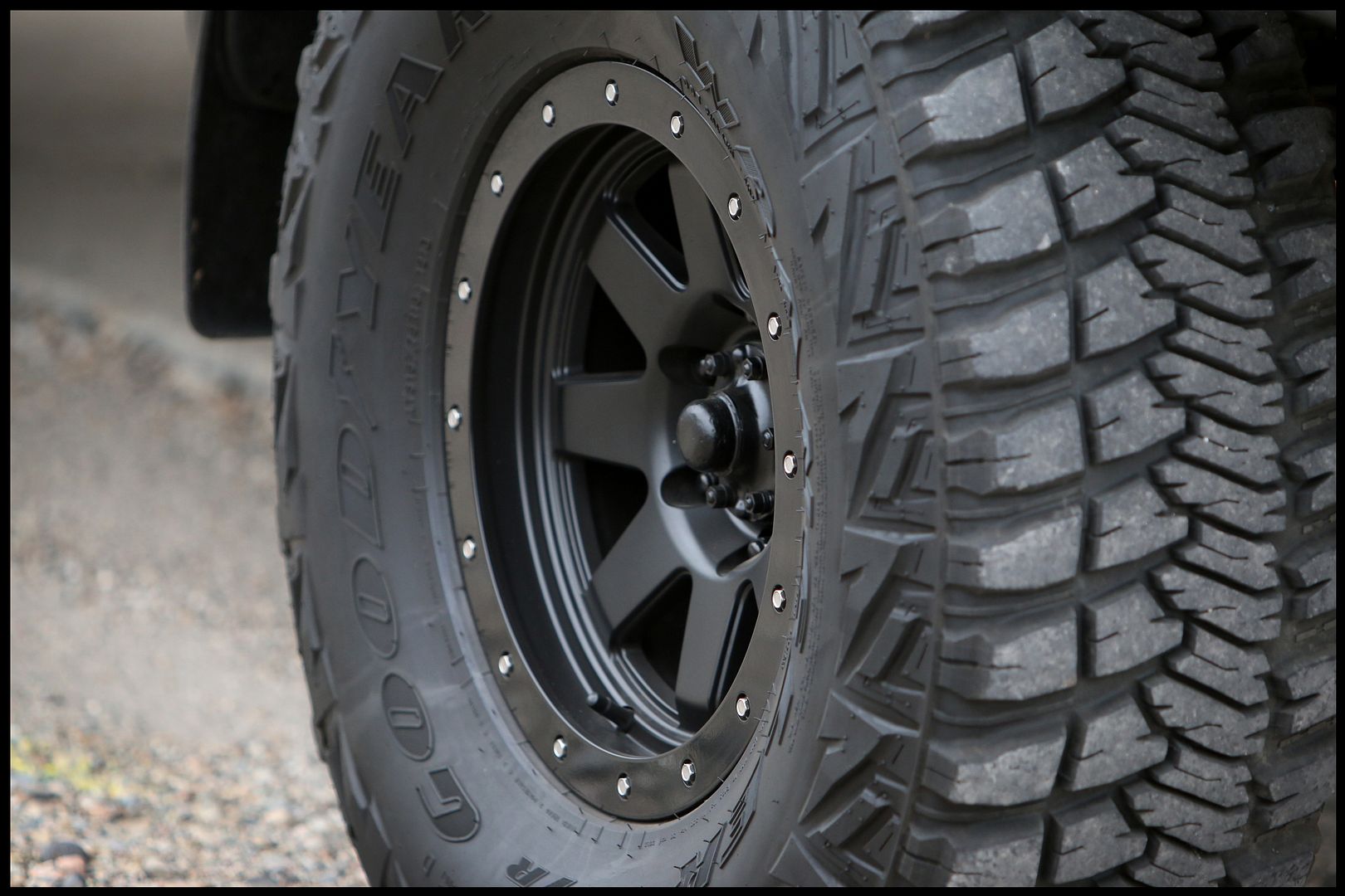

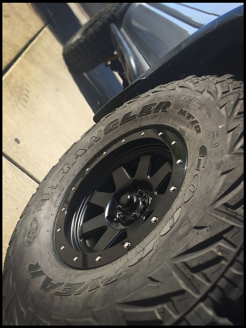

Got my SCS Wheels SR8's mounted up on the 80 this morning. I really like them and the quality of the wheels is great! These have a small lip for the center cap that needs to be machined off o fit over the wheel hub on the 80. It was a pretty simple tweak for a great wheel.
That is one sweet looking truck!
Snapped some better photos of the SCS wheels so here's a few for anyone looking for aftermarket wheels for their Cruiser. I really like the SCS stuff. These are 16x8 with 4" BS which is perfect IMO on the 80. It's puts the outer edge of the tire out flush with the fender flares for a really nice look. I still need to really stuff them but initial flexing of the suspension doesn't rub the flares.
