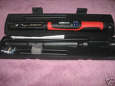

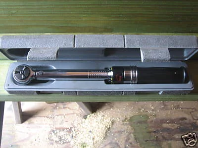

In its place, I have bought two wrenches:
Husky 39102 25-250, in/lb (certified range of 70-250 in/lb or 5.8 to 20.8 ft/lb)
Snap-On TECH2FR100, 5-100 ft/lb (certified range of 24-100 ft/lb)

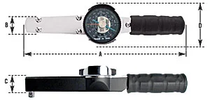

However, I may sell the Husky and get a CDI 3002LDIN 0-300 in/lb (certified range of 60-300 in/lb or 5-25 ft/lb) as this wrench will span the missing range from 20.0-23.9 ft/lb that the Husky/Snap-On combination misses.
The CDI 3002LDIN is a dial wrench and that would require you to watch the torque value and stop yourself at the desired torque (tell me if I'm wrong here). I think I would prefer the "click" type wrench as you don't have to be looking at the display as you are wrenching; which can be difficult in some positions.
Picture 1 - Husky
Picture 2 - Snap-On
Picture 3 - CDI
