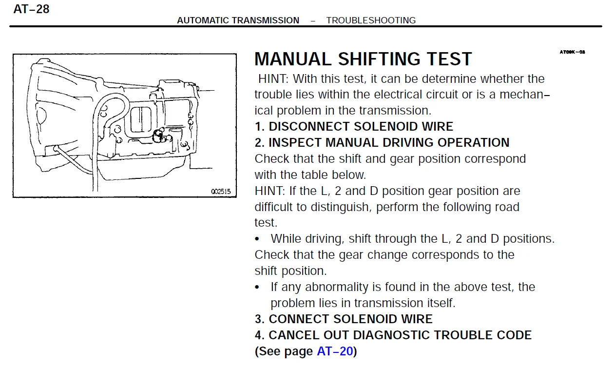

The bad news is this disables automatic control of the transmission. If you do this, you really need to know how the transmission is designed to operate, or you will have a very expensive paperweight. Details are on page AT-28:

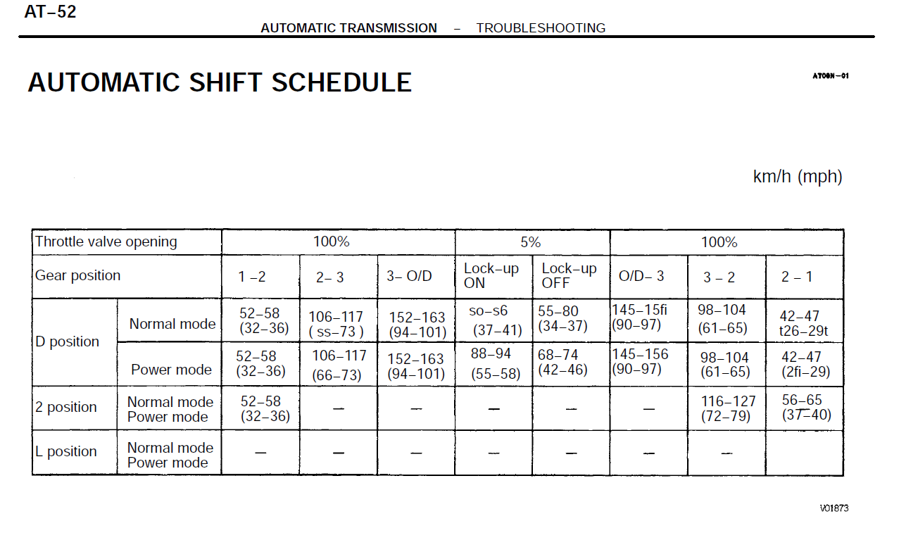

The programmed shift schedule is:
From above, the predetermined shift point (at 100% throttle, and either NORMAL or POWER mode) is a minimum of 32-mph. At 5% throttle there will be no upshift from 1st to 2nd at any speed.
The take-away here is that at 5% throttle, you're stuck in 1st gear. This table is pretty much worthless unless you assume that you can interpolate linearly between 5% and 100% throttle...and if you have a means to determine where your throttle position is, while you're driving.

Incorrect, if you disable the tcu or solenoids you can't manually select second gear.
Shifter position- actual gear
1- 1st gear
2- 3rd gear
D- 4th gear
While this allows chosing and starting in a select gear, second is not avaliable.
1- 1st gear
2- 3rd gear
D- 4th gear

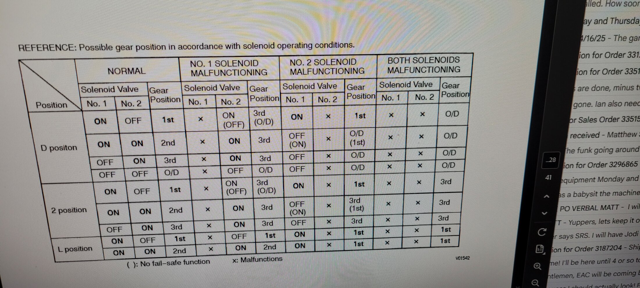

So I guess the service manual is wrong.
I'll bite, how did you determine that you get overdrive in drive and third gear in second?
Actually did it years ago.
Service manual isnt wrong, just not super clear. If you look at the chart, it's described as both solenoids malfunctioning.
You're comparing apples and oranges. The chart you referenced is a troubleshooting chart. It was intended to be an aid to someone trying to find an automatic operation fault, not a manual operation checklist, which is what the section of the service manual I posted states.
And, you never explained how you knew the transmission never shifted into 2nd gear. I don't expect anyone to take my word for anything, that's why I posted the excerpt from the service manual. Unless you have either compared engine rpm to transmission output shaft rpm to verify gear ratio (and that's an indirect proof anyway) , or had rigged up some way to "see" the 1-2 shift spool action within the valve body (which I'd really like to see), I don't know how you can categorically state the transmission never shifted into 2nd gear.

We have gotten off track talking about the logic with the solenoids disconnected or tcu removed from the equation.
