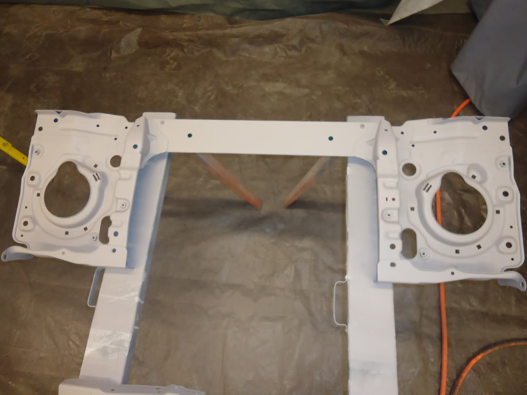

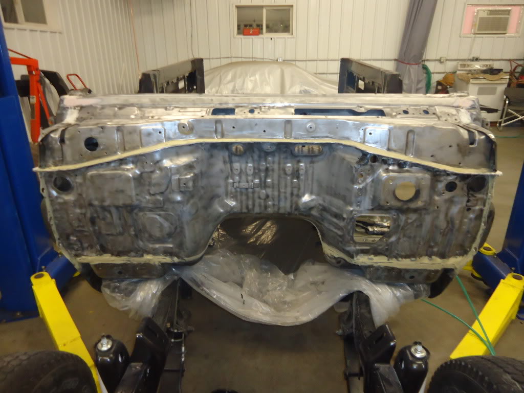

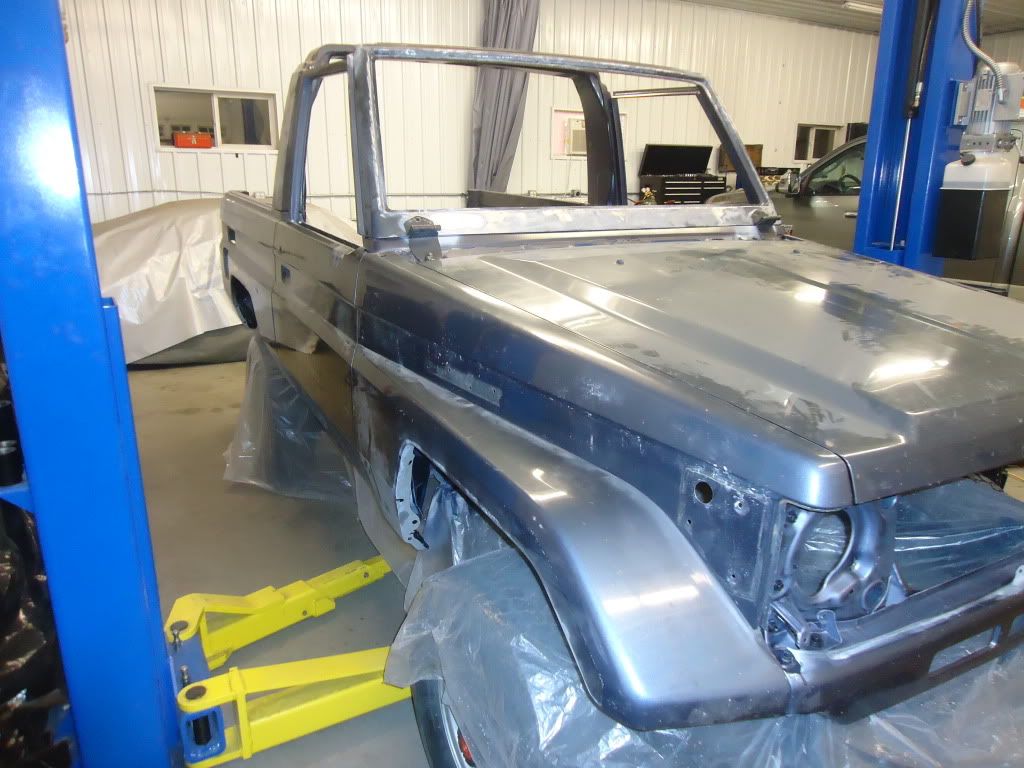

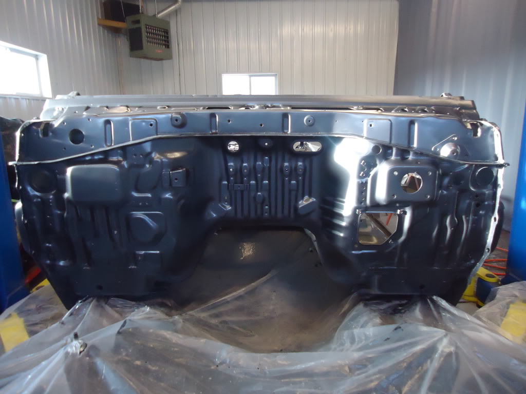

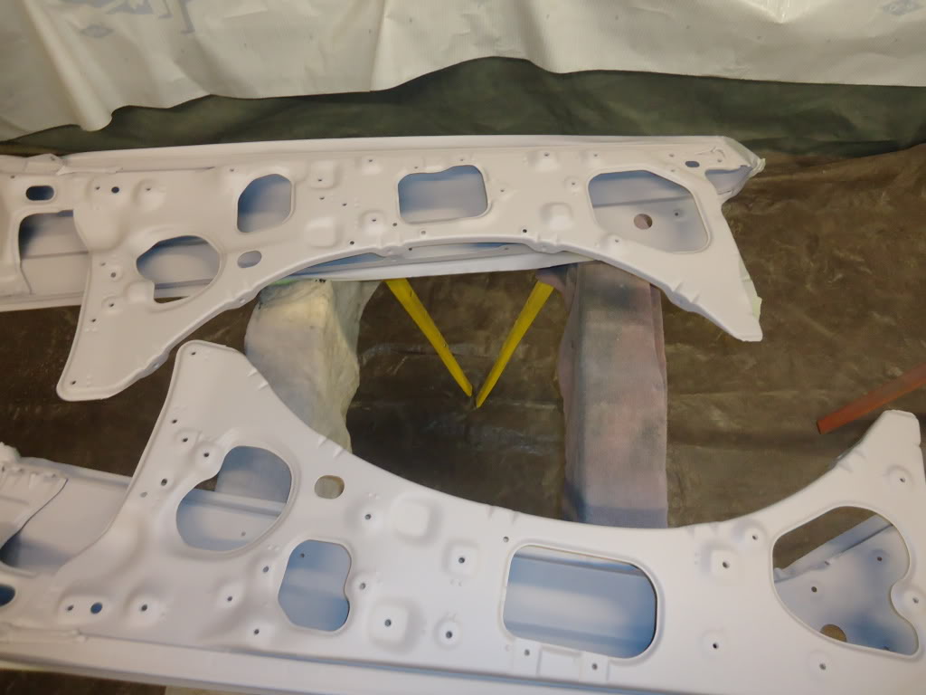

I haven't heard back on the wiper issue yet, so I went ahead and made another mount for it. The firewall is pretty much in and done, and I will be putting a coat of 2K primer surfacer on it. I need to give a little more attention to the top corners. I will also put a coat of base color on it, since I can't get to all of it when bolted together.

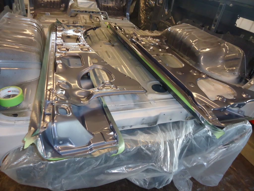

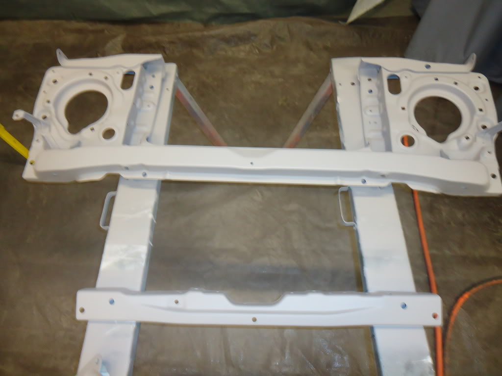

Once that is done, I'll be cleaning up the aprons, fenders, core support to get them ready for paint on the inside. I plan on getting it painted when it is together, so I have to get the insides primed and a coat of base on them before it all gets bolted together for final prep and paint.

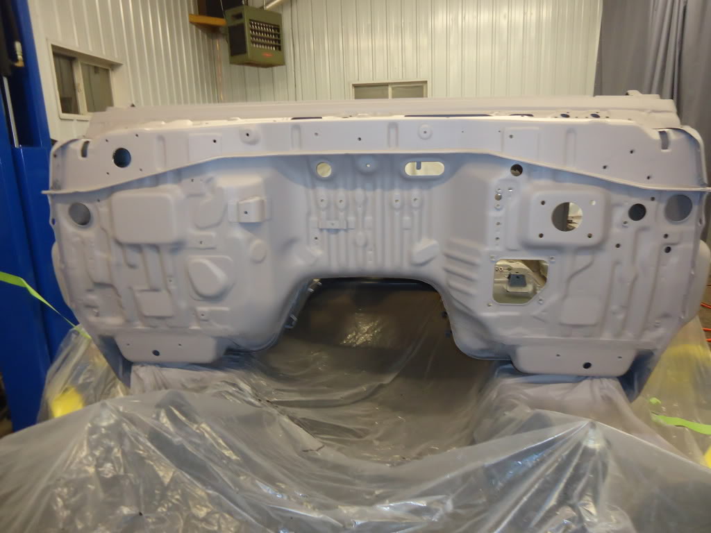

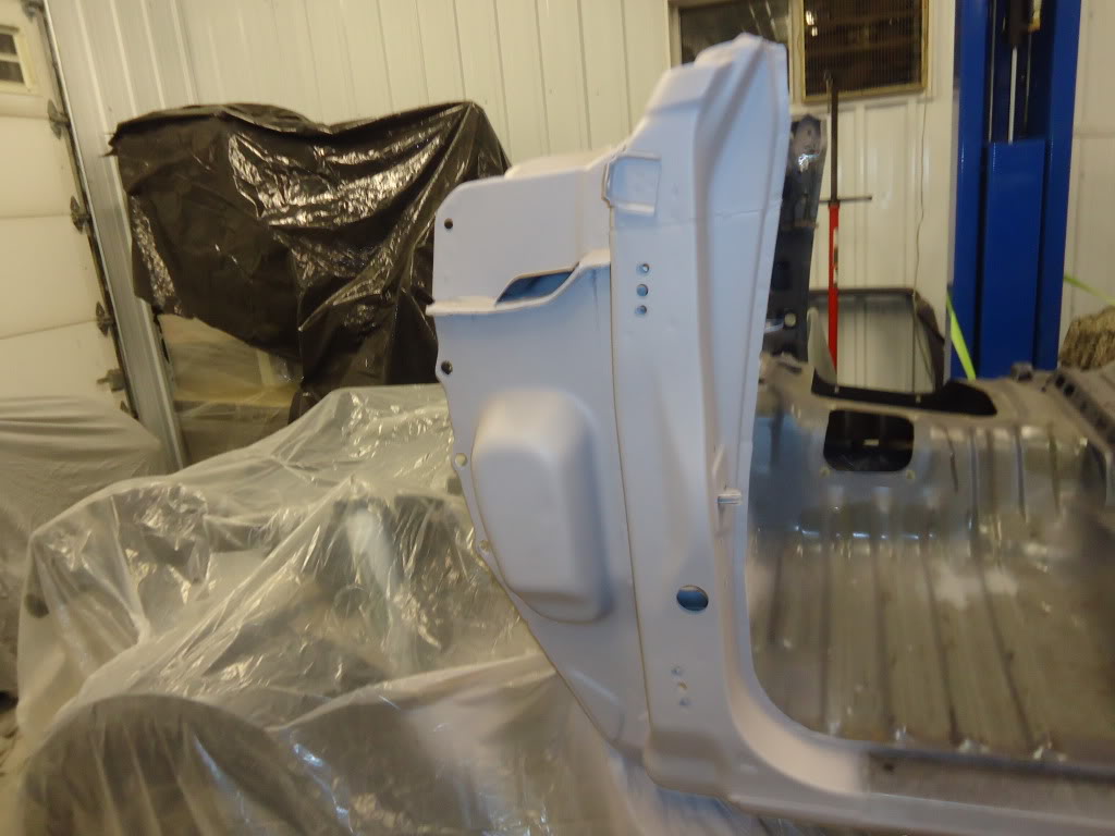

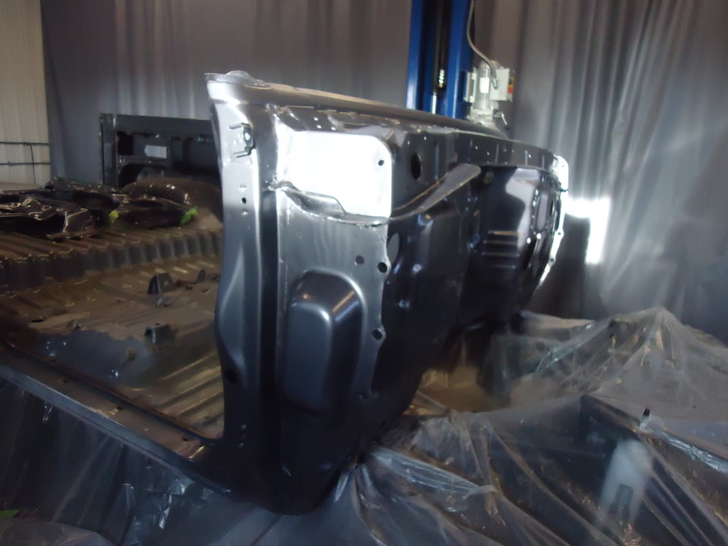

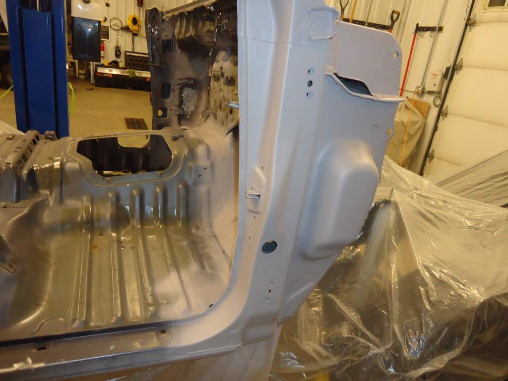

I finished the priming today. 2K primer applied to the firewall, pillars, core support and the inside of the fenders. I will be scuffing and wet sanding it tomorrow, and spraying some color on it.
I got some color on it. Basically this was just to get some color in areas where it would be difficult when assembled. I will be scuffing this all, then assembling the front. It will get another coat of base, then clear when the final paint is done.

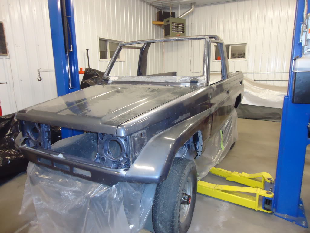

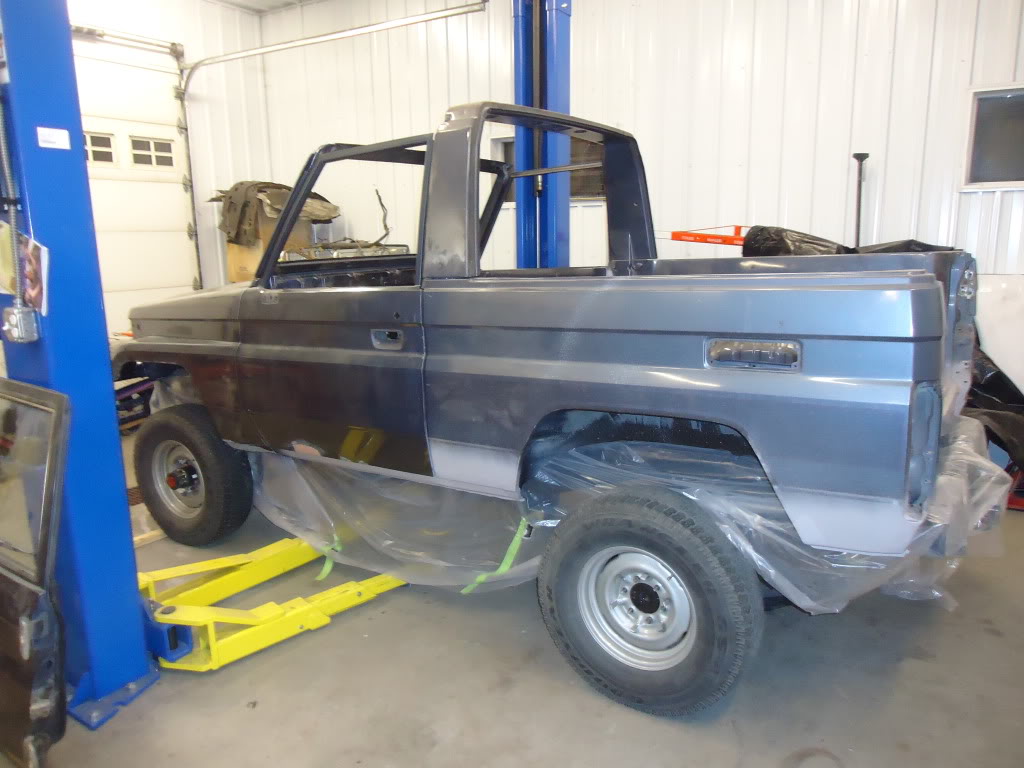

I have been out of town a lot, so I was not able to get much done. However, it's starting to come together.
Today I got most of the sheet metal bolted back on. I was pretty pleased at how all the gaps and lines came together. Nothing that bothers me more than big hood and door gaps, or uneven gaps. I got everything on but the rear doors. They need to be taken apart and cleaned before I bolt them back on. Then it will be going to paint!
It's starting to look like a truck again! It really sits high with the new springs, and little weight on it. The Ironman springs are only 2.5" lift, but I must have had 2" +of sag in the old ones. It's about 6 inches higher than it was since it has no weight on it!
