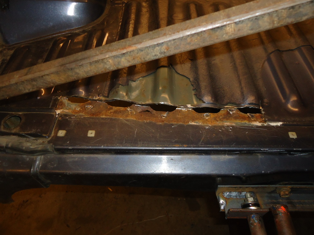

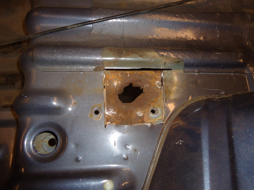

I cut most of the rust spots out of the tub, most in seams. I will sandblast this tomorrow, and get some paint on the bottom of the tub to keep it from rusting until I get the firewall cut out and the new one installed.
I didn't cut out the rust on the right floor, because I do not know how much I an going to take out when I replace the firewall. I will address it then.

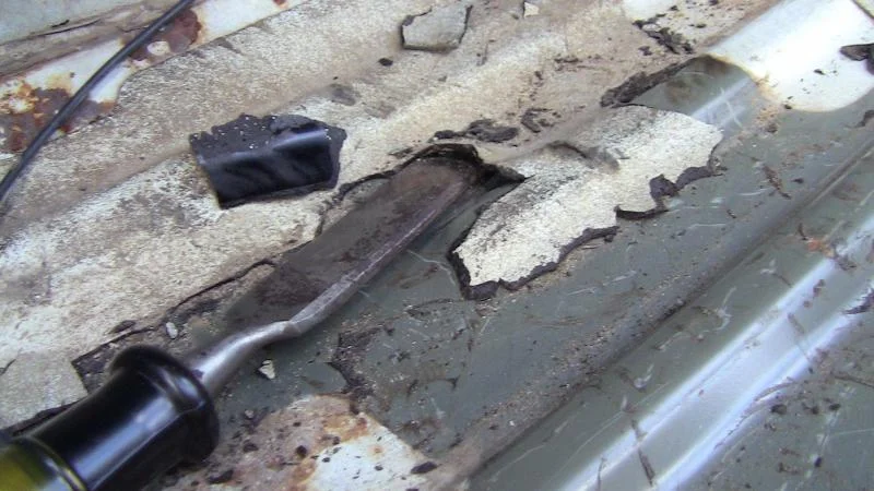

take a hammer and beat the factory liner material. the vibrations usually cause it to let go and you can take it off in large chunks.
slide a chisel or puddy knife under the loose piece, hammer on the adheared piece and when it lets go, proceed with the wedge till it lets go.
if you try and sandblast then the stuff just heats up and rolls like a wave and takes FOREVER to come off.
just a suggestion.

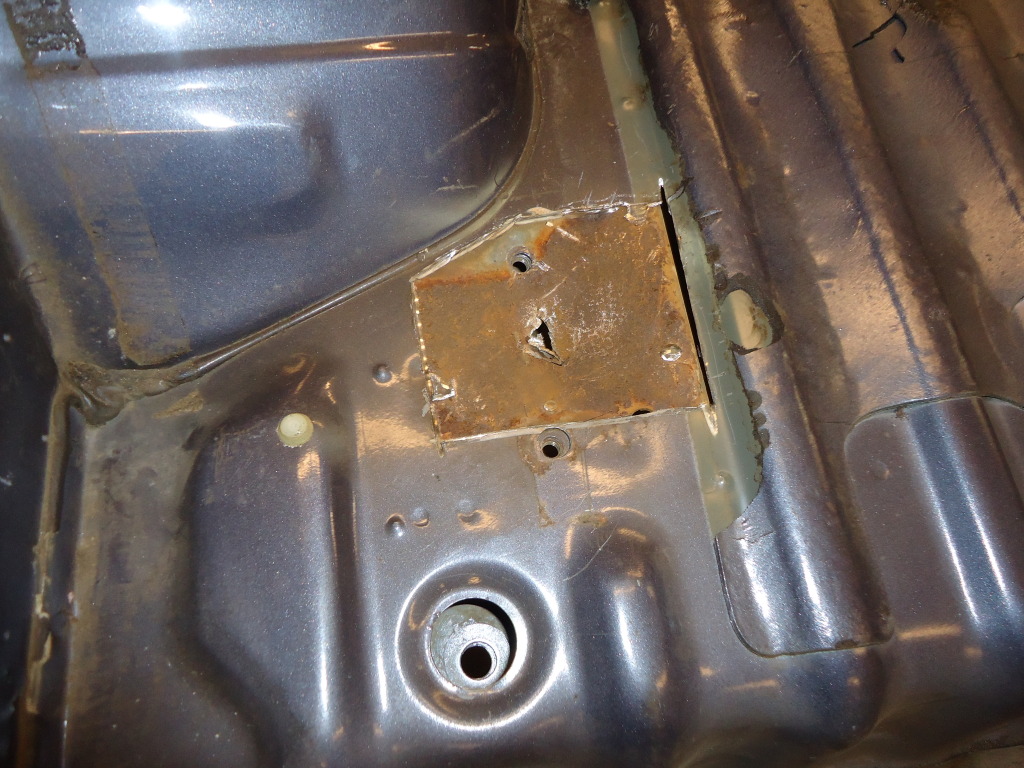

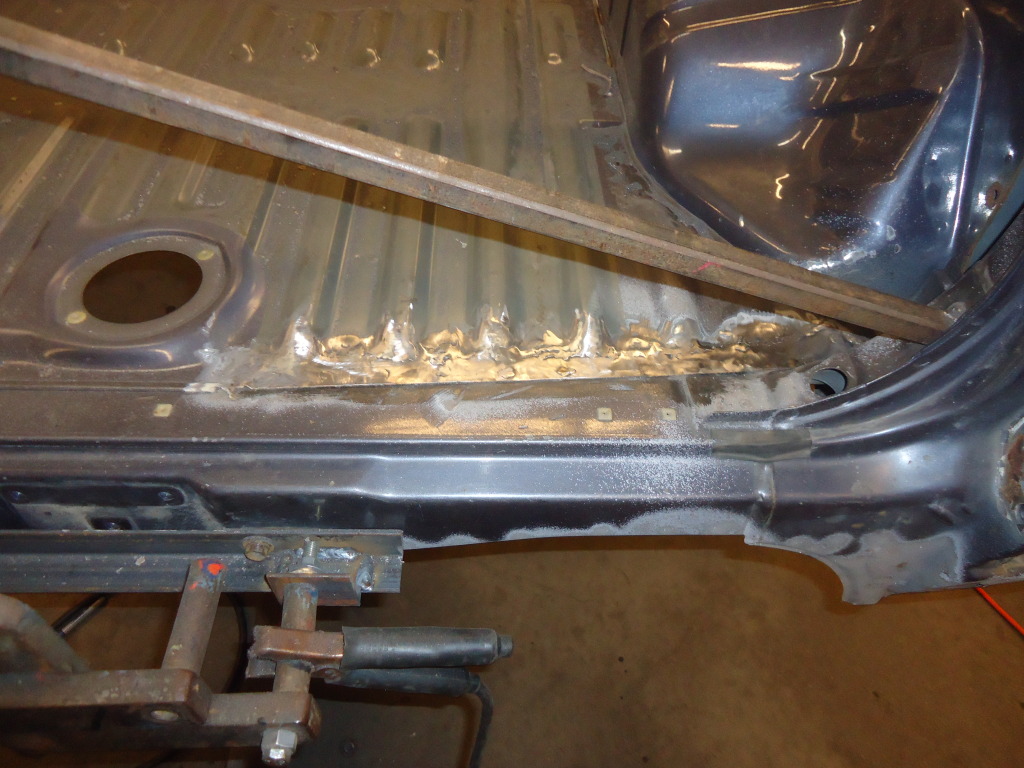

A little update. I did some welding and patching on the body tub. Not finished, but here is what I accomplished so far.

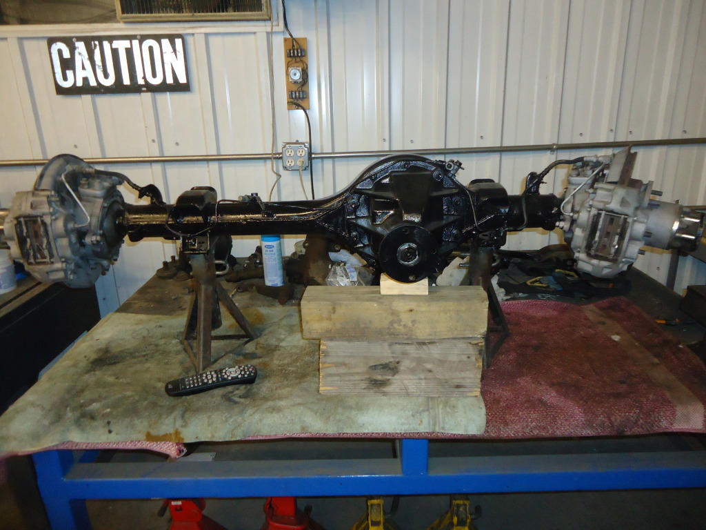

Also painted up some parts that I had cleaned up. Since I was driving this before teardown, there was really nothing I needed to do with the axles except reseal the front, They are both tight, brakes were good, and no leaks. So I sandblasted and painted up the rear. I hope to have the parts to finish the front axle later this week--just the seals and new brake pads is all I am doing to it.

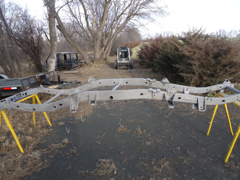

I got the 74 down to the frame, ready for sandblasting. Since I am also doing a LHD conversion, I needed to make the frame ready for the steering box. There is support in the frame for the box on the 70, but not on the 74. So I cut the support out of the 70 frame, and opened up the 74 frame, inserted the support, and closed it back up. Pretty easy job.
There was a welded nut in the support from the 70 that is part of the frame in the 74, so I just cut that part our of the 70 support before I put it into the 74.

I used the steering box bolts to pull the frame back together, and welded it up.
[URL="http://i430.photobucket.com/albums/qq29/a550550/BJ74%20Conversion/DSC00970.jpg"][URL="http://i430.photobucket.com/albums/qq29/a550550/BJ74%20Conversion/DSC00970.jpg"][URL="http://i430.photobucket.com/albums/qq29/a550550/BJ74%20Conversion/DSC00970.jpg"][/URL][/URL][/URL]
[URL="http://i430.photobucket.com/albums/qq29/a550550/BJ74%20Conversion/DSC00971.jpg"][URL="http://i430.photobucket.com/albums/qq29/a550550/BJ74%20Conversion/DSC00971.jpg"][URL="http://i430.photobucket.com/albums/qq29/a550550/BJ74%20Conversion/DSC00971.jpg"][/URL][/URL][/URL]
That is where I am today. Next will be getting the frame and axles sandblasted, painted, reseal the axles and put the frame back together with new Ironman suspension. Then I will sandblast and paint the bottom of the body and bolt it back to the frame before I cut the firewall out for the LHD conversion.

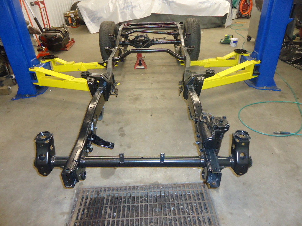

I got the frame back from the powdercoater, and it turned out great!. I started to bolt some parts back on, and install the new Ironman springs. Then ran into a question.
I am putting the Ironman 2.5 lift on. The springs are TOY008B fronts and TOY007ANS rears, with antireversing shackles. Do I need to put in castor shims? I got the setup from ACC Toyota, and they did not mention anything about the shims, but I have read that I should install some 4 degree shims for 2 1/2 inch lift, which is what this setup is rated at.
Any thoughts?

Yes it is. A little slow work, as I clean and paint as I go along. I am going to try and get the front axle in today. I took it apart, and the bearings and rotors needed replacing. I am just waiting for the knuckle bearings to arrive. I have everything else. I can install the axle without the hubs.
I also think I am going to wait and see if I need shims until it is finished, and take to the alignment shop. Then I have all the weight on the chassis, and the tires I will be running. They are not that hard to put in, especially when everything is clean. I might put longer pins in now, just in case I need shims, if I can find pins!
most car part places sell long pins that you can cut down, just add a steel sleeve over the pin at the head, about 1/2" to make sure it still connects fully with the axle housing.
i have started running nylon strip material between the leaves, makes the springs last long, ride smoother. just a suggestion. not cheap but worth every penny, in my books.
