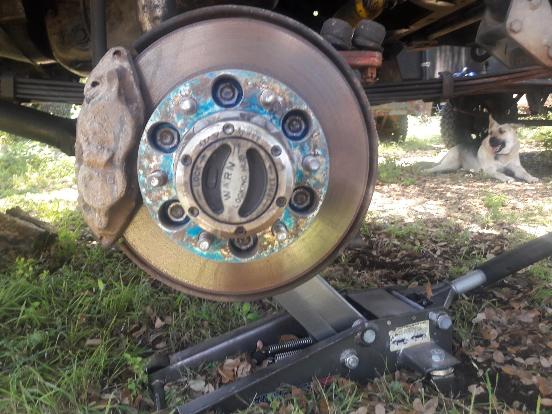

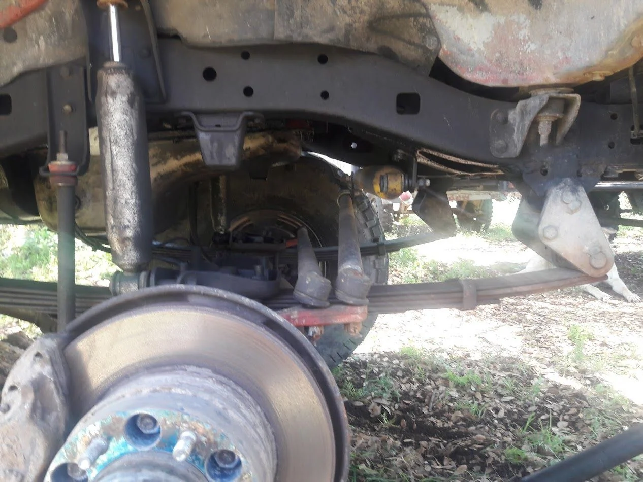

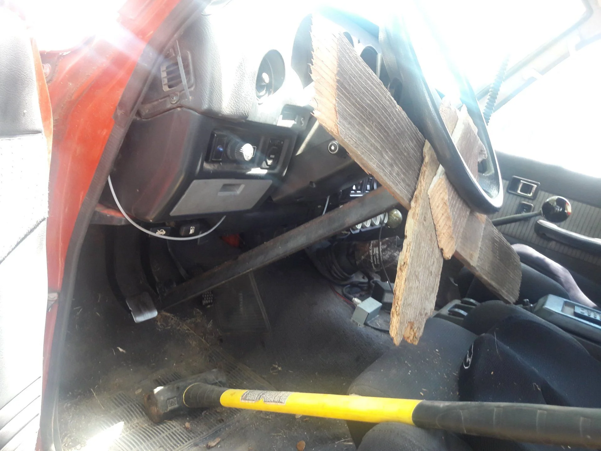

I decided to check the torque on the spacers today, since I took the day off. It's been on my to do list since before heading out to Syria, I even went to Round Up without checking them, not advisable. Anyway here's my back yard way of getting the front tires from spinning while I check the nuts.
Don't laugh, it worked.
Happy to say none of the nuts needed torquing, though I do need to give the under side a power wash.

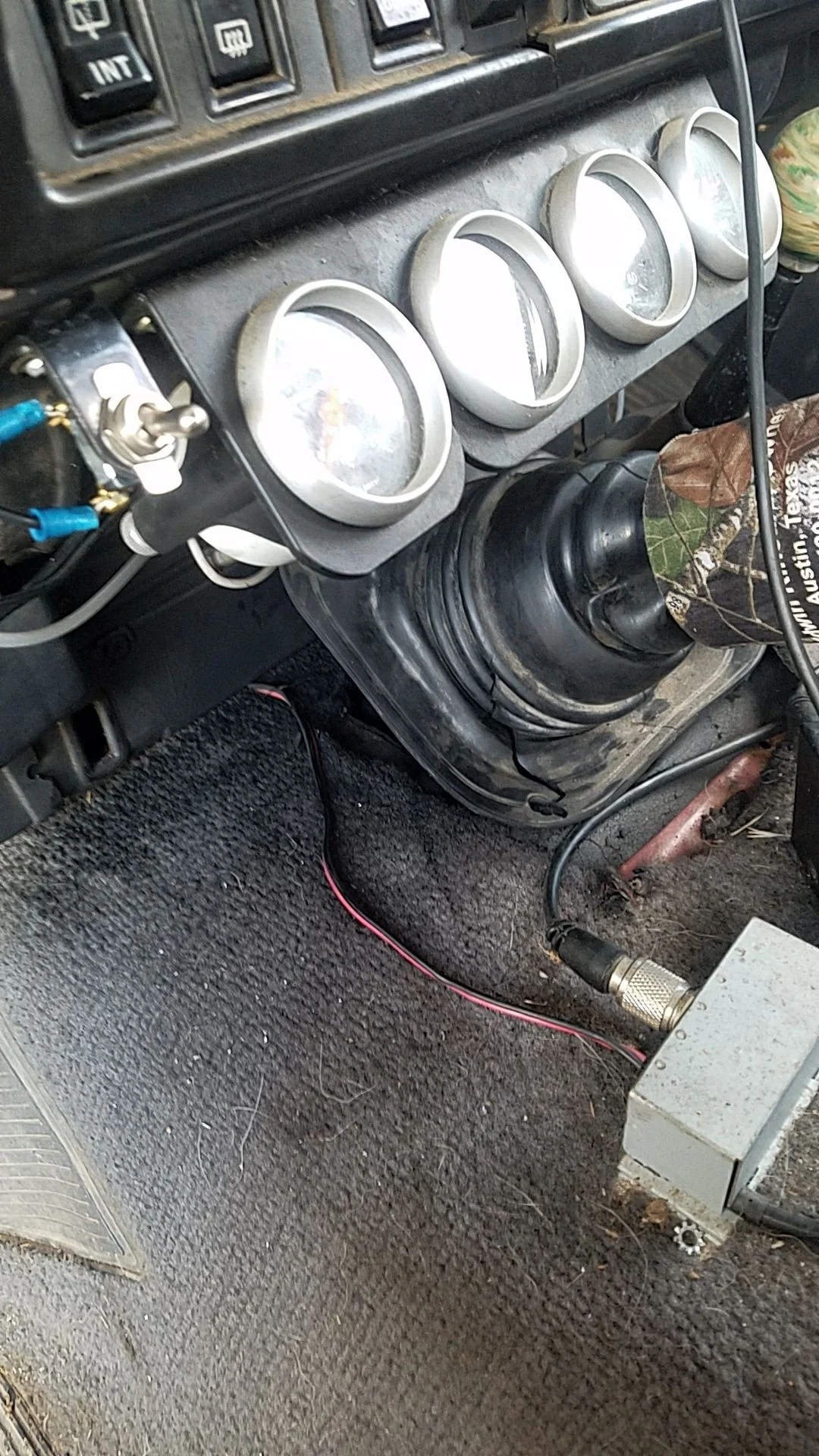

Added a switch to the electric fan. I also tried some new cooling additive. It helped some, but the engine was still managing 210* with the ac on.
The switch is independent of the ignition switch, so I could run out the batteries if I forget it on.
I was desperate enough to try this. Not sure if it helps or it was just the fan. My numbers are about 10* lower than when I ran the truck without ac. I wonder if I flip the switch when the temps hit 180, if that will keep it cool instead of waiting till it hits 200.
The pyro needs to be addressed next.
