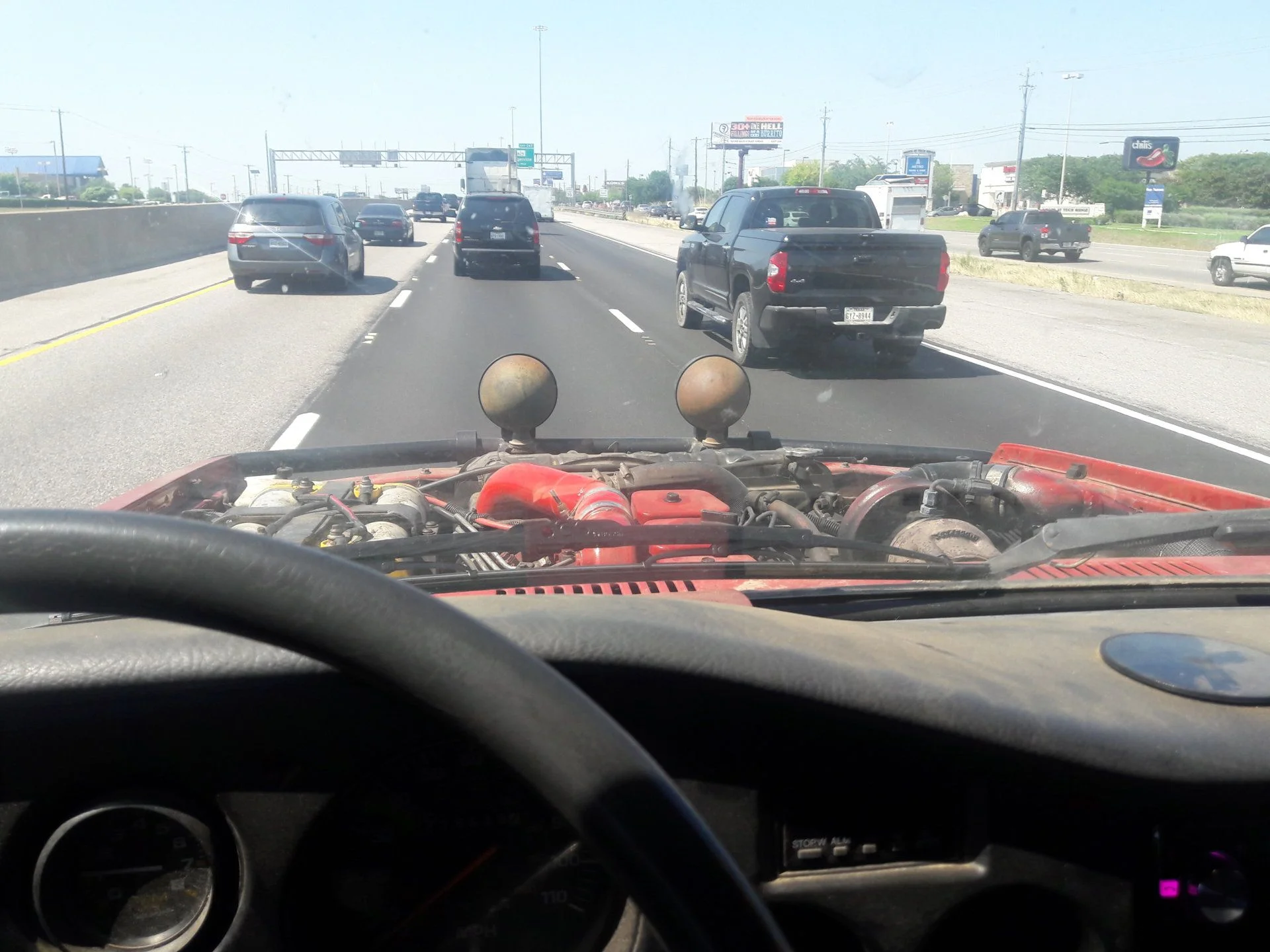

Is the temp a new issue? Have you had problems during the past summers?
No, this is new. Occasionally it would run a bit warm when i push it.
Thinking it's the compound setup.
Once it’s open a 160 would work the same as a 190. I don’t think it would help if your over 200.
I would hack up the hood once you find another one and see what that does.
Took off the hood and drove it to work. AC fully blasted, blowing really cold, ambient temps at 79* and it ran at 190* most of the way. At one point it got to 195* because i was pushing it.
We'll see how it does this afternoon when the ambient temps are 98*. Looking more like im getting louvers installed.

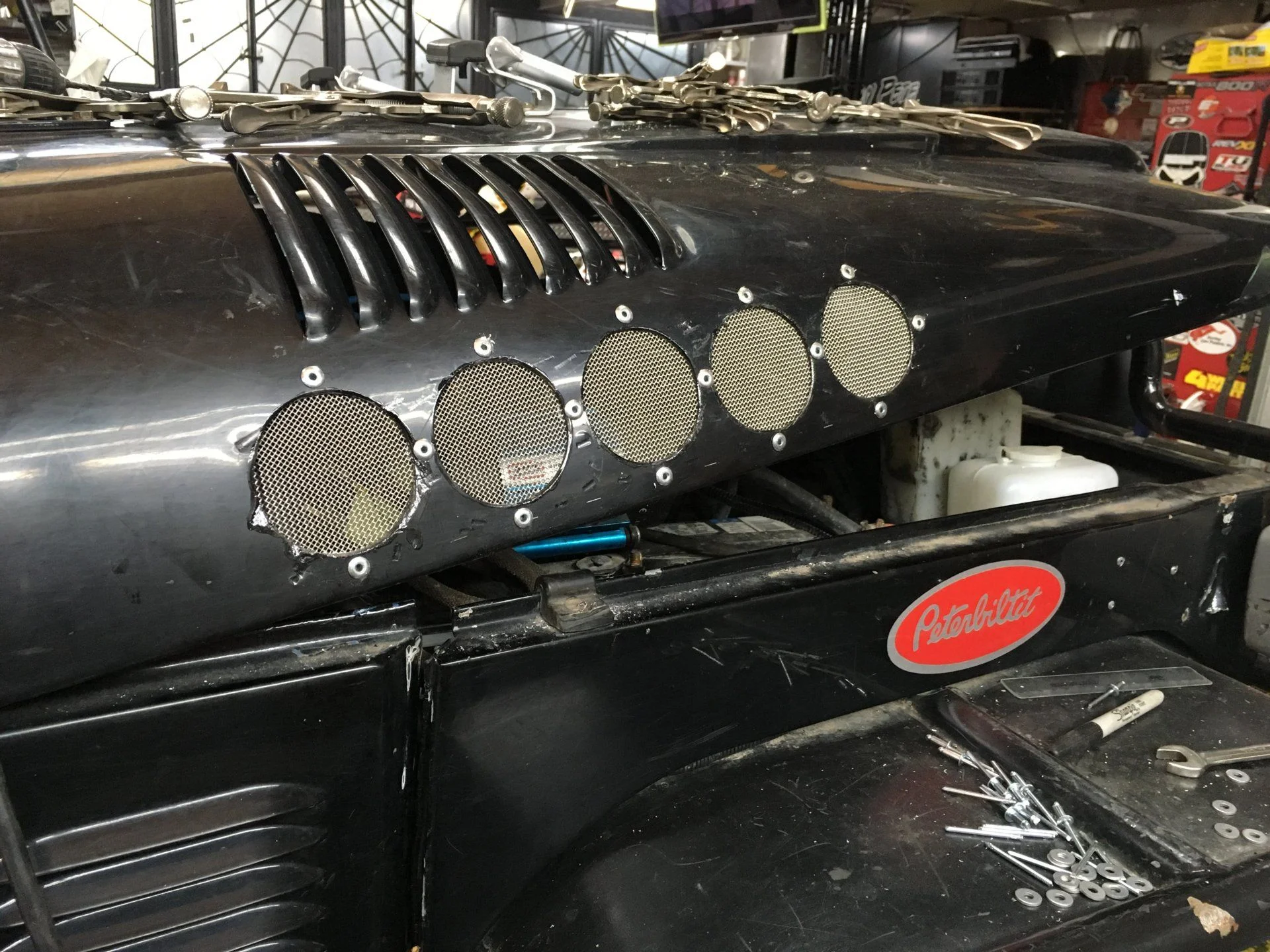

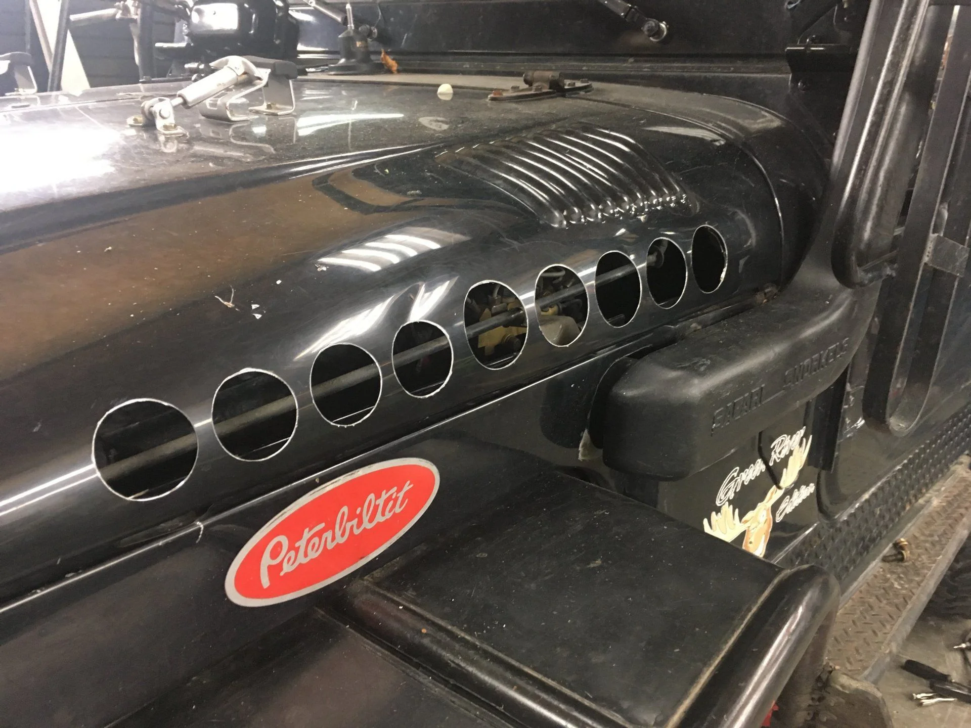

Something I had tried on my 40 last fall, homemade,crude, but It worked !!
I don't want to clutter your thread with me pics, i can delete if ya wish??

I like this look as well, but worried about random rain clouds.
