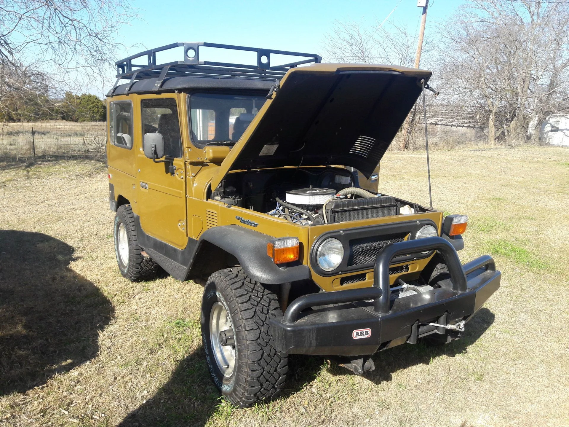

FJ40 with a 350 Chevy and a 270 Z
he's Gonna bring it to round up this year.

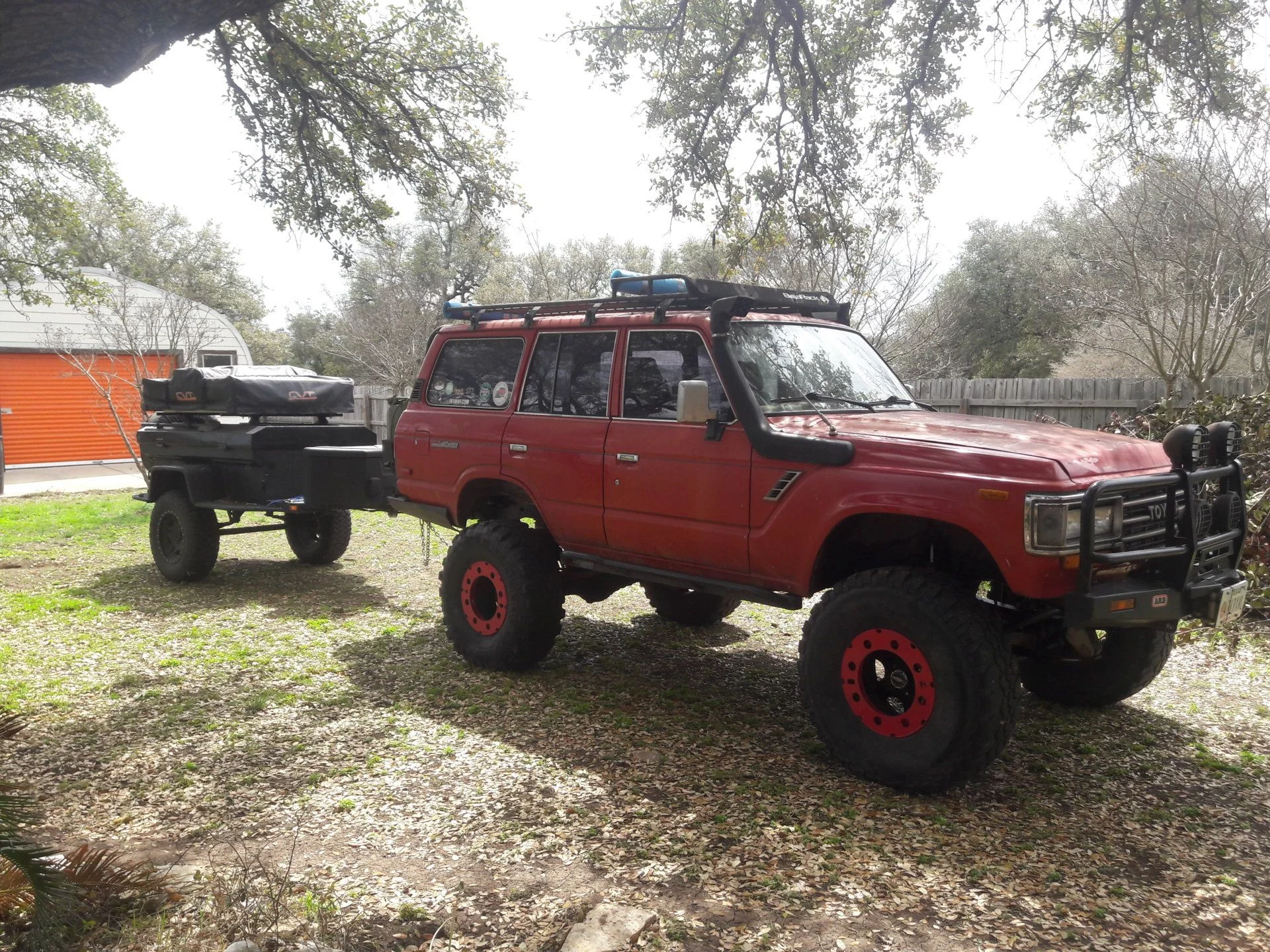

So I woke up Friday bright and early to get the rig and trailer ready for Round Up 2018. I texted my friends to see what time we're meeting up to convoy, and that's when I was told I'm off by an entire week. I suppose I could have made it to work, but decided to enjoy the weather and work on my motorcycle instead. I changed the the spark plugs and have been riding it for two straight days.
Big Red and trailer packed and ready.

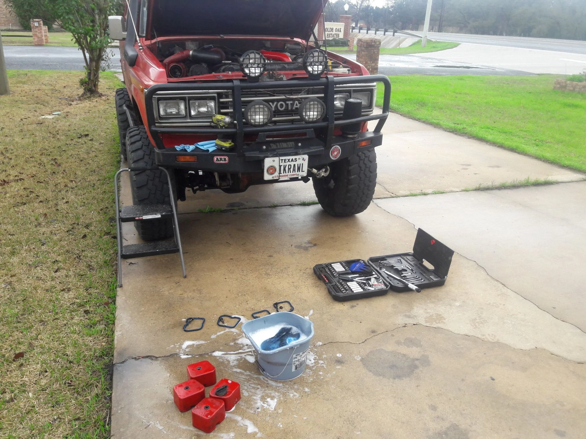

No pictures today, but I did change the oil and drive it for roughly 60 miles. The oil change was messy, the driveway has a large oil spill on it now and I'm hoping to be at work by the time the Mrs sees it. The remote filter now that it's lower near the engine spilled when I unscrewed it. It was much cleaner when it was located in the of the engine bay higher than the engine itself.
