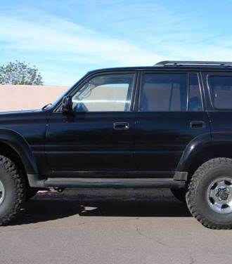

This was my last 80 with heavies front and back and a MAF 30mm front spring spacer. I didn't do any caster correction and it would wander a little on the freeway but wasn't bad but the front end had been rebuilt a year or so before I got the truck which probably helped a lot. I also got lucky and didn't have any driveshaft noises or vibrations. I lowered my stock brake hoses and made new extended diff/axle breathers. For my current 80 I'll be doing a medium lift front and back with the same 30mm front spacer to keep it level.
