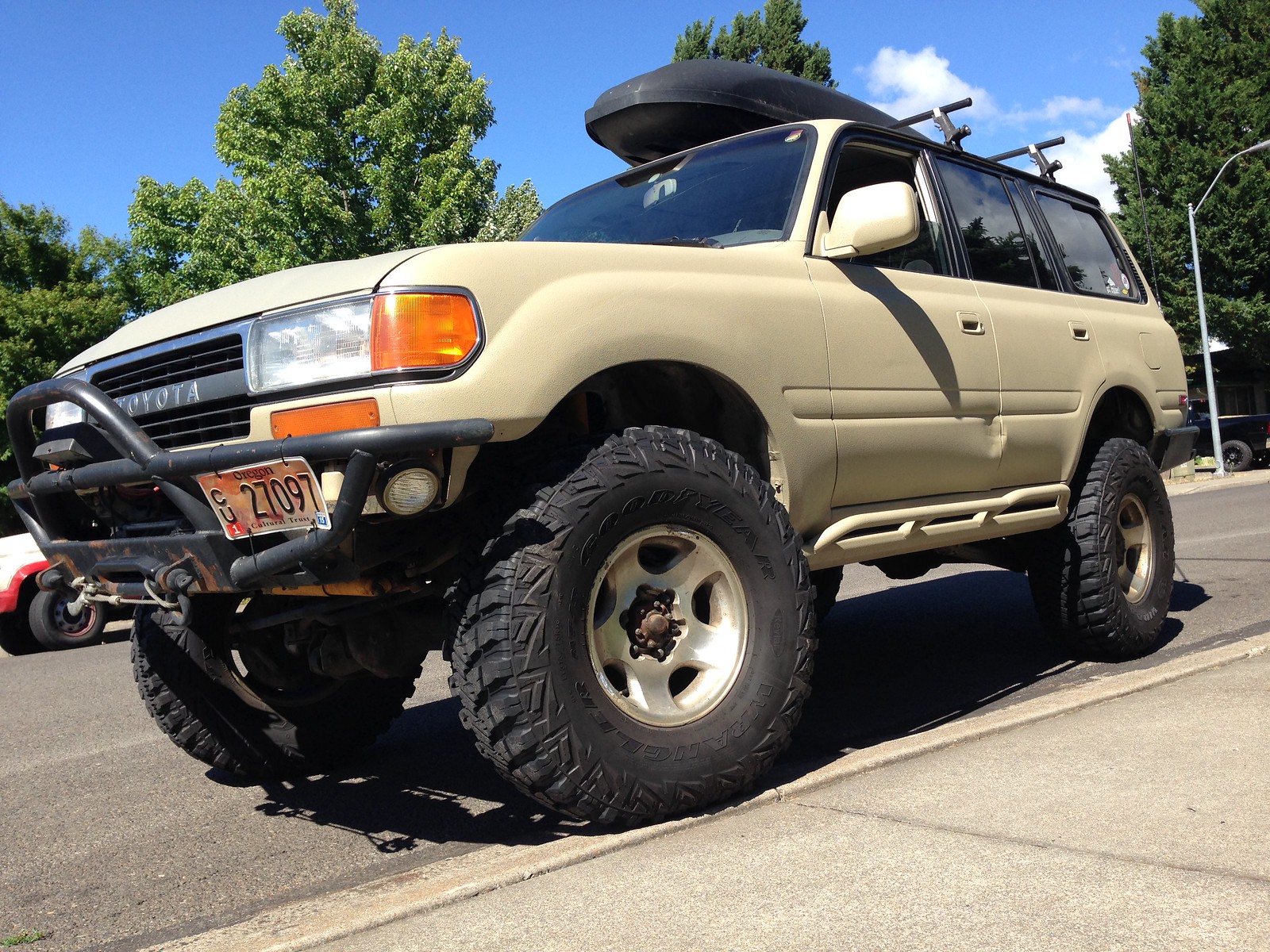

"J" lift on the corners. MT caster plates, 2" mt coil spacer up front. Time of pic MT front bumper, warn 8000, MT sliders, creepers skid, rear labs bumper no swing out, 315/75/16 MTr. Almost level.

The whole theroy behind OME is 2.5" lift. The medium, heavy & J lifts are meant to be 2.5" of lift. The variable is weight. There is a lot of rigs running J/863 that are not heavy & it yields more than 3" of lift that starts causing the issues of vibration. I believe 3" is where problems start. I'm at 3" & don't have serious vibs, I do feel slight vibs, but nothing that requires change. If you plan a winch or dual batteries then get the J spring in front. An 850/863 is going to stinkbug. OME engineered it that way on purpose. To fix it then you need to spring up or space.
