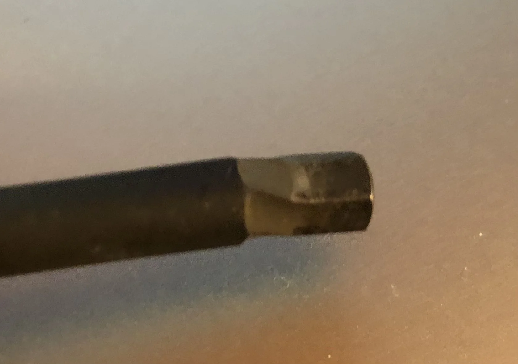

Does anyone have a favorite brand of 5mm hex socket to attack the KDSS shutter valve screws with? As with my last cruiser, I got one loose and the other is refusing to budge. I've wire brushed, cleaned with picks, tapped with a hammer, used both PB Blaster and Kroil. So far, I've broken one and twisted two sockets (stopped before they snapped), and now need to resupply. Snap On seems like a good brand, but I'll be darned if I can find a way to get ahold of the local franchisee.

Possibly the reason the impact bit shown above twisted instead of snapping is while impact tools are usually made of high grade steel, it is often a more malleable variety and with different heat treating to resist failure from the nature of impact loading. Basically they are designed to be strong but give a little, instead of fail. Whereas non-impact tools made of tool steel will often be harder which can make them better at avoiding rounding.. the cost is when they are pushed too hard they just snap. Think of them as having the properties of glass.. very very hard, but they shatter instead of bend.
