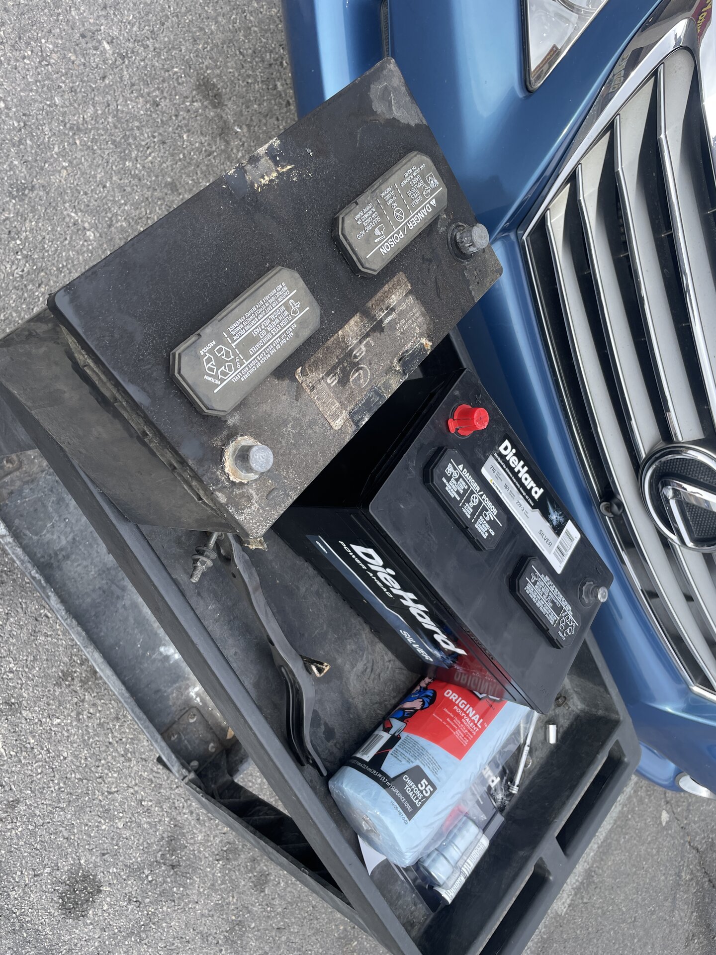

Went with the DieHard Silver 27F, gotta say it appears to be the exact same as the Lexus (not original Panasonic) unit.
