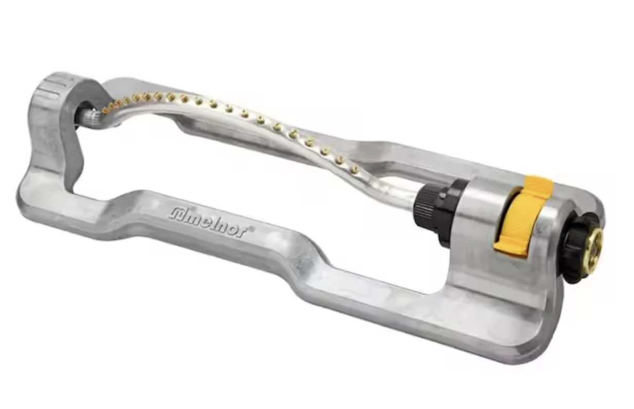

I bought one of these since I had a pressure washer for our drive way and wall cleaning already

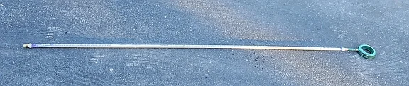

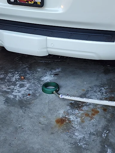

I started washing underneath my cars in winter since I bought my first used '74 Chevelle in 1979.

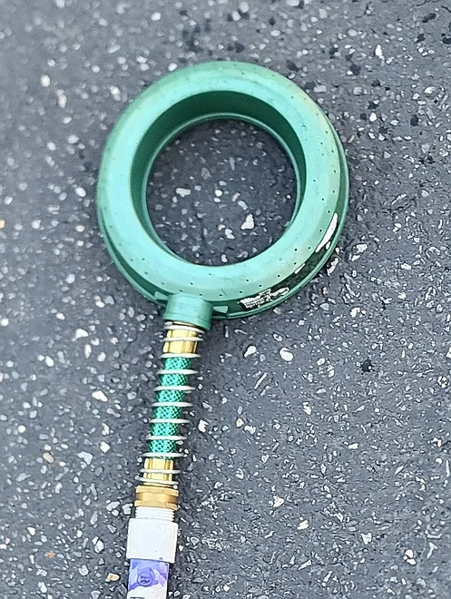

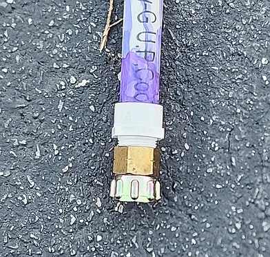

I've been using something like this ever since which I made mostly out of stuff I had lying around the garage .
It really blasts water upward when spigot's turned on full; the springy hose relief allows you to bend the spray head and drag/thrash it left and right.
Needed:
  • 10' 3/4 PVC pipe
  • Sprinkler end: Round sprinkler, hose strain reliever, 3/4" PVC to Garden hose adapter
  • Hose attachment end: 3/4" PVC to 3/4" male pipe, metal 3/4" male pipe to garden hose adapter (use a metal one as the plastic ones break too easily)
